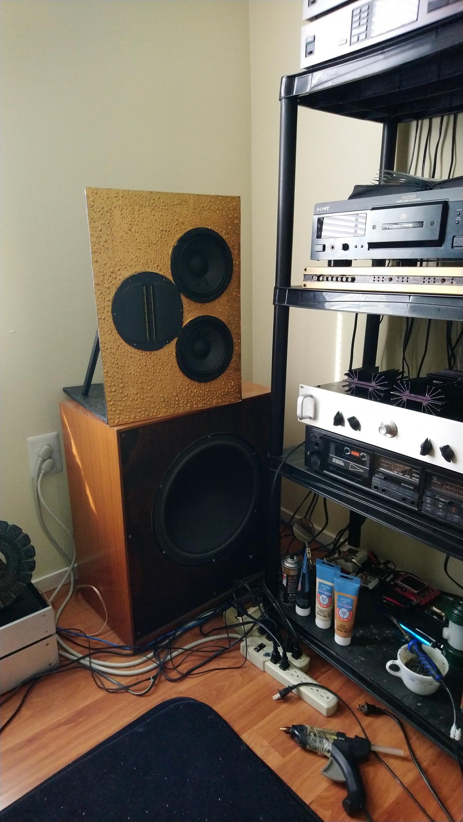

small high sensitivity two way
-4 ohm, no baffle-step compensation, poor off-axis dispersion, high non-linear distortion..
I'm ok with 4 ohm..
I'll play with BSC but my ears are old and a slightly rising response isn't a bad thing.
Hopefully better off axis with 6.5" or 5.25" drivers.
I'm hoping that picking flat response drivers and doubling up mid woofers to lower excursion should help with distortion...
..I bought 4 Faitalpro 4FE32-16 drivers today.......so we'll see how these work with the Fountek.......
FaitalPRO | LF Loudspeakers | 4FE32
I originally ordered the 4FE35-16's but quickly realized the high Qts was not going to get a reasonably flat response even in a relatively large sealed enclosure....so I changed the order to the 4FE32-16's
These are 16 ohm 91db...
So based on the above TMM will likely be a better arrangement than MTM?
I'm thinking I'll cross them around 3500-4000hz with a 3rd or 4th order filter.
I'm considering trying a mini DSP with these...that should keep me entertained for awhile.

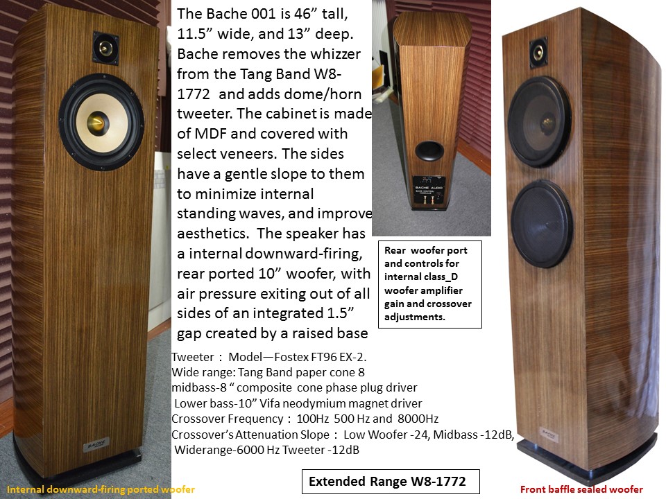

The Bache 001 speaker cuts the whizzer off of the Tang Band W8-1772 and adds a Fostex FT96 EX-2 tweeter. Their measurements might be useful to your work.

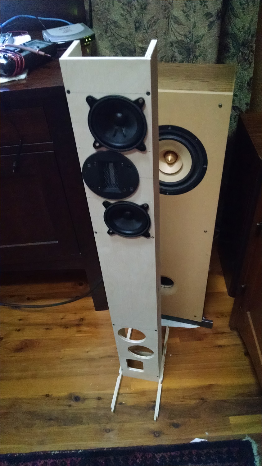

Let the fun begin......quick baltic birch test baffle..
Open baffle.....can flip it over for TMM config........the tweeter is roughly at ear height..about 42"
Just listened to it with just both FaitalPro 4FE32-16's wired in parallel.....sounds better than I expected.....now on to a crossover and getting the NeoCD 3.0 going. No stuffing in the back but I have a bag of polyfill.
..I haven't bought a miniDSP yet but I should....

I will put a cap (maybe a 10uf) in series with the tweeter to protect it while experimenting since it has close to zero DCR.
