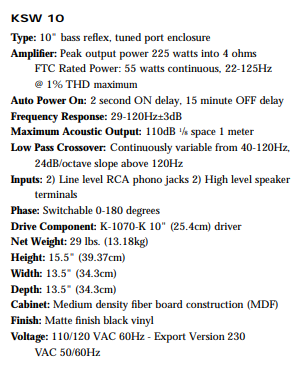

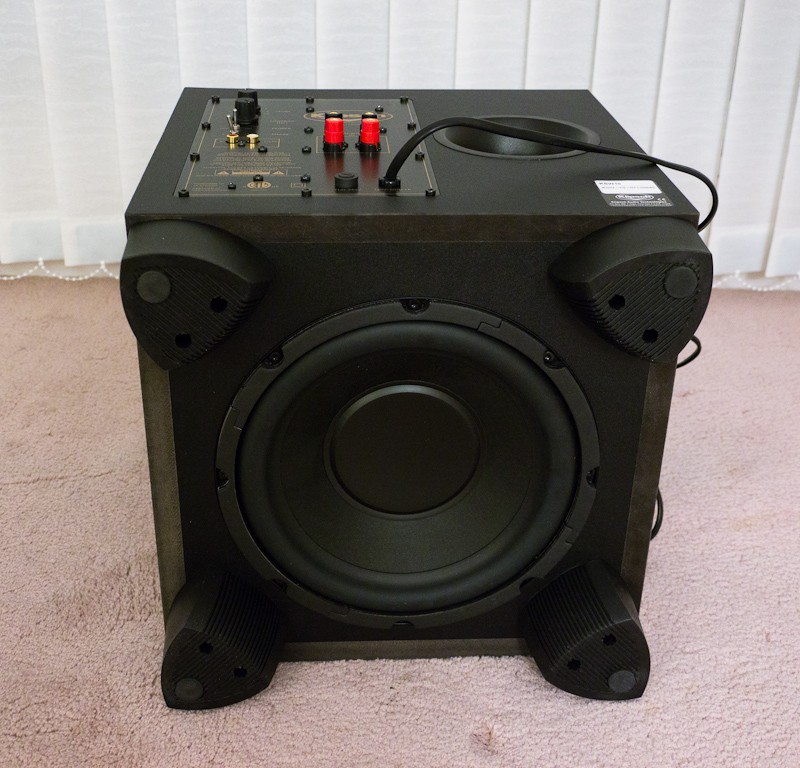

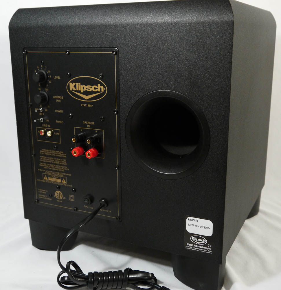

Hello, what's the smallest sub you've ever known or heard? I refer to size between 15-30 liters and 10'' drivers.

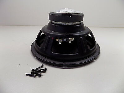

I've listened for example a Klipsch KSW10 and for its size is a little miracle: about 25 liters in classic vented downfiring configuration. It uses a 10'' driver called K-1070-K, does anyone know its T/S parameters?
The only one I've ever seen is a Peerless XLS application note using a 10'' driver in 20 liters but whit a passive radiator, rather expensive system, while I'll have to contain costs.
What may be the magician of a Klipsch's-like driver? What may be the best T/S values for these small subs, even in car audio range?
Thank you very much.

Hoffman's Iron Law = of the 3 considerations in bass, you can only pick 2: small size, high sensitivity, and low bass extension.
Here's my guess- the Klipsch is tuned higher than optimal, in a smaller box than optimal, and has enough power to overcome the sensitivity problem. Unless it is a high-Q driver, then the output is favored over low-end extension. It's likely not all that different from most other drivers out there in subwoofers; especially commercial units.
