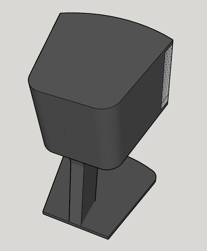

Can you give me some suggestions on what to do? Form is equal to function on this project, so a ported golden ration box or the like are out of the picture. Sealed satellite cube with separate bass cabs tucked in behind are the best aesthetic I can think of right now.

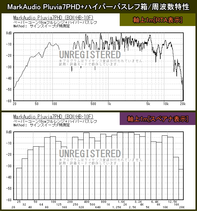

What do you think of enclosure FB-10F for the Pluvia Seven HD?
[ DIY ] Hyper Bass-Reflex Type Enclosures (for Single Driver) - DIY - Loudspeaker | Low-end Speaker Craft

classicalfan - It's true that few suggestions are small enough for my space requirements. The Energy's are quite nice for what they are. Since I have the bug to build, I'm going to make something. Maybe it will be better and maybe it will be worse. I'd like to try to follow the design language of the Bose Companion 3. I've never heard a Bose speaker that I liked, but I do like their designs more than most.
If I go this route then I think I'll try to make the enclosure with kerfed HDF. CLD two layers, use some crafty bracing inside to try to stiffen it up. I know it's not an ideal material, but I can't think of a way to make such a small speaker with MDF or BB. I'll use the FaitalPro 3fe25's I have. Could I get some suggestions on how to go forward on this?

classicalfan - I think there was a miscommunication. I never had a problem with bass. I just wanted to know if I could make something 'better', while staying small. A call out for ideas. I did say at one point that form was equal to function for this project. The suggestions certainly helped me understand where the state of the art is within my constraints, since I've been out of the loop for some time. I wouldn't have honed in on the idea of a satellite sub combo without them. Thanks for your suggestions.
You'll have a very hard time to reach small diameter HDF curves like in your illustration. The fibres are relatively short and it breaks, I don't think it's possible to do that in HDF. Screws in HDF are a problem too, wood screws are easily torn out. If you want to use HDF, use square wood corner pieces and route the curve and a rebade for the HDF to glue onto. I would not recommend to use that material though.
Instead of HDF you could use a wood box as a 'frame' with rounded edges and wood or HDF top and bottom board. For the 4 sides you could use several layers of cardboard, which is flexible enough to follow the curves and still gives you a high stiffness and nice surface. To glue them, just use white (PVCA) glue and 'press' them with a few rubber bands, after drying you can use normal woodworking tools on it. Make it a bit wider than the target height and flush trim route the overlap.
Such enclosures are ideal for a completely different technique and material: 3D printing. They aren't big so a lot of DIY speaker builders with a 3D printer at home could help you there, even a professional 3D printing company should not be very expensive for such enclosures.
A layered plywood enclosure is likely much easier to build than the HDF one too. Build a block of a few layers plywood, drill out the inside with a Forstner drill (you can drill completely through), glue top board on it, screw on the bottom one (with the attached foot), so you can always access the inside and still have no screws visible. The layered plywood is a very nice pattern and looks very good.
