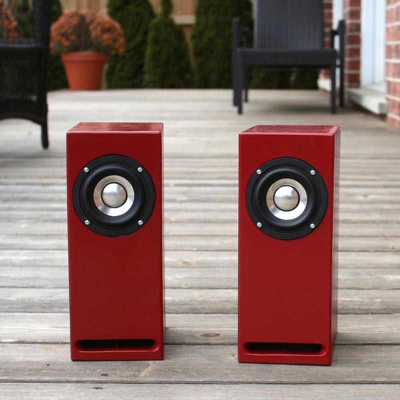

I think you would be advised to consider a single driver full range for desktop because for such close listening it helps for the sound to come from a point source. There are many examples out there. Here's something I built:
Martello Fr88ex

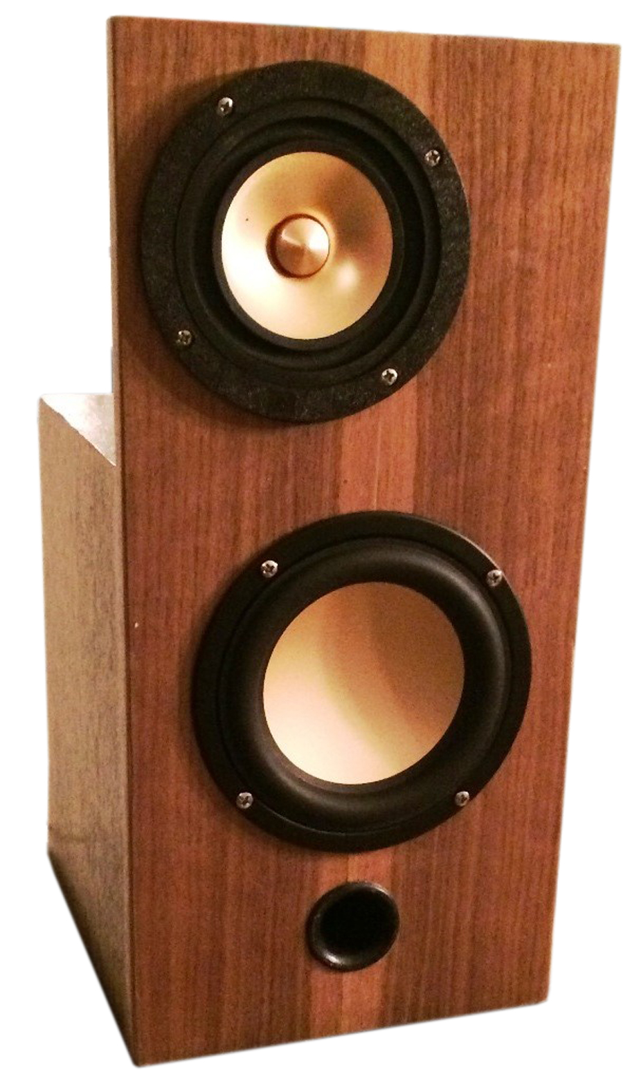

Open-baffle + Bass Reflex similar to this picture:

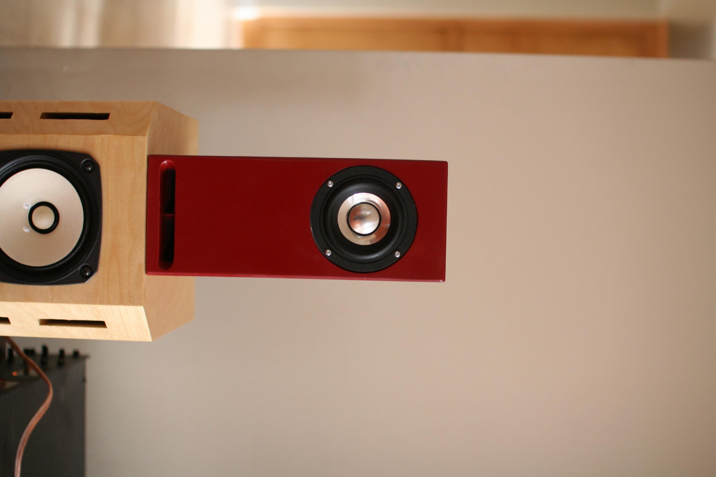

This is a quartet of the milliSize box we do, here with FE127.
dave
