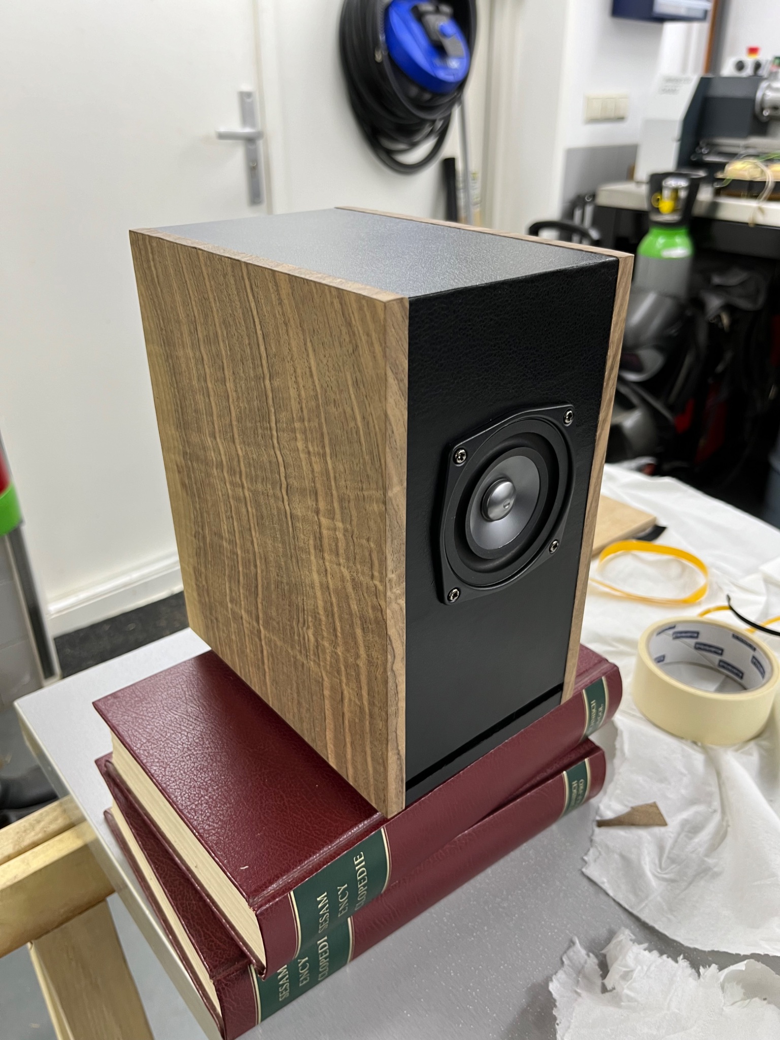

I have made a pair of these last year, CHN-40 in BR enclosure. In a 2.1 setup with Tangband W5-1138 in a sealed 12L enclosure and simple plate amp from Ebay they sound quite pleasant with decent volume in 6x4m room. Still need to measure them but felt no need to hurry.

Btw. not wanting to hijack your thread in any way. Just suggesting that this driver may have an even larger WAF while still sounding good, given what you are going to use them for. Helps that the plate amplifier has a high pass filter build in for the satellites so they do not have to handle anything low. Good luck with the decision-making and subsequent building. Curious what the end result is going to be!
Oh those are very very nice! Very similar style to what I want to build with black front and wood sides. I really wanted to make a pair that can work sans subwoofer if needed and I've been meaning to try out a design with truncated drivers flat against the sides for a little while.
