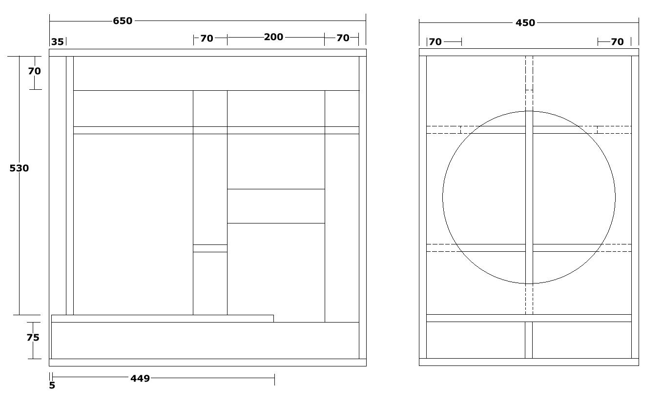

My suggestion would be basically this, assuming 15mm timber.
If you wanted to use 18mm, keep the internal volume, cross section of port and length of port the same. That would add nearly 5.5kg to the total weight.
If you wanted a different bracing layout, the key things to make sure of are that every panel is tied to its opposing panel and that each panel is broken up into smaller sections. Try and keep the volume of any alternative bracing to the same, lest it throw off the box tuning (granted, a litre or so difference wouldn't throw it off by much to be fair).
Thanks for this option. I assume this is with the B&C 15BG100 in mind, as you described previously?

Yes, that was what I was envisaging for the 15BG100 mentioned in post #19.
