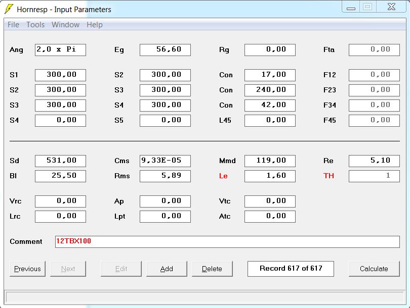

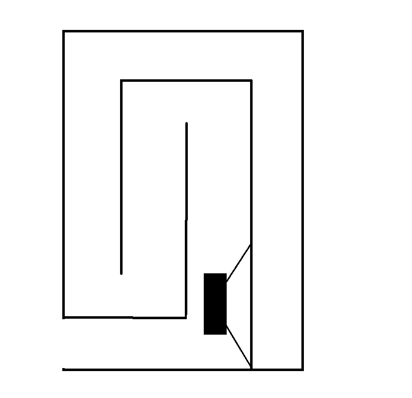

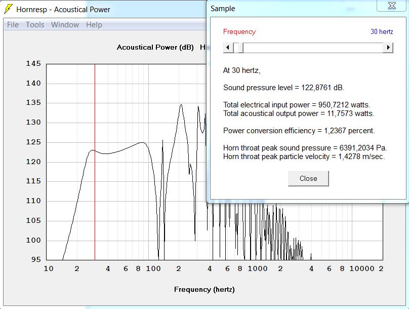

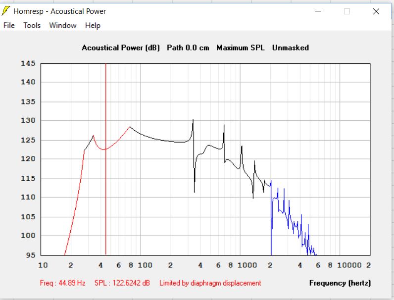

With respect to Circlomanen's tapped pipe design: at first glance it looks good for size and weight, and the recommended driver (B&C 12TBX100) is relatively affordable, but when I looked more closely at the driver specs it seems to have a Fs of 47Hz, and I am not sure that it will actually work well for the lower frequencies? Or can the tapped pipe enclosure work some magic? Is this where I would use the piston excursion calculator?
I'm not sure I have the knowledge to determine whether Lab 12s, for example (which have much lower Fs but also much lower RMS Wattage rating) would make a suitable replacement. I have just downloaded hornresp and am just starting to poke around in it.

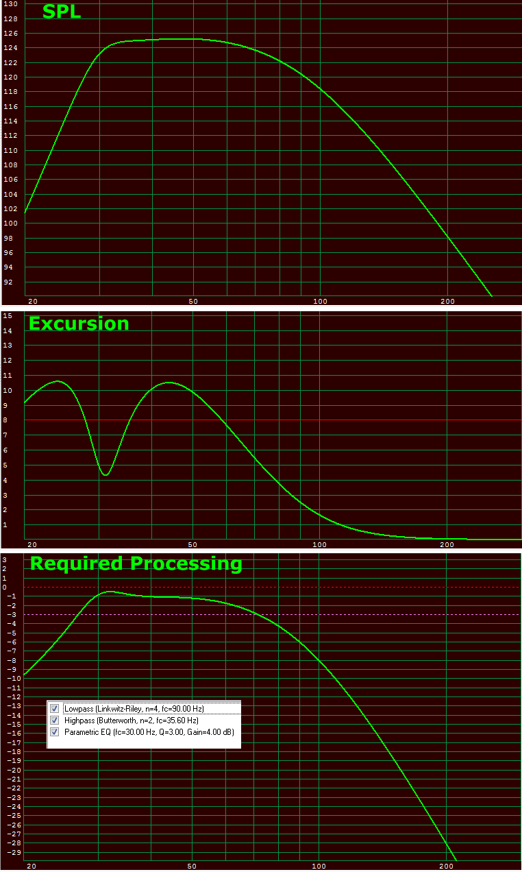

My suggestion would be basically this, assuming 15mm timber.
If you wanted to use 18mm, keep the internal volume, cross section of port and length of port the same. That would add nearly 5.5kg to the total weight.
If you wanted a different bracing layout, the key things to make sure of are that every panel is tied to its opposing panel and that each panel is broken up into smaller sections. Try and keep the volume of any alternative bracing to the same, lest it throw off the box tuning (granted, a litre or so difference wouldn't throw it off by much to be fair).
