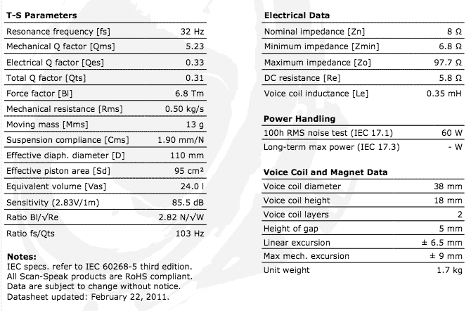

I've got a couple of pairs of Scanspeak driver here and they all measure different to the Scanspeak datasheets. Mine are well run-in and always warmed up with pink noise before taking measurements. I have a WT2, WT3 and a DATS V2.
Warming or not warming also makes a difference-> higher Qts -> need for bigger box. There is an interesting paper from PHL Audio about this....
Trouble is "low level"/ small signal is too low to give realistic TS params measurements, but question is also what is the correct level ( in Volts) to make a realistic TS measurement? 10mV, 100mV, 1V, 10V?

Some one also wrote a paper on this... Higher Cms makes higher Qts, but also lower Vas, so that things evenly come together.
But some guys also manipulate their data. Consistently build from batch to batch a 5' driver with a Fs of 30Hz ( that is with extremely soft spiders) is not easy, hence possible issues with all parameters badly derailing. And similar issues with magnets.
SS drivers, at least the Revelator line, "always" have much higher qts than specified.

Ha. These drivers are nearly identical. The K01 just has a smaller magnet. 🙂
The 83dB, 24L vas,0.41 Qts 15w-8530k01
http://www.scan-speak.dk/datasheet/pdf/15w-8530k01.pdf
The 85dB, 24L vas, Qts 0.31 15w-8531k00
http://www.scan-speak.dk/datasheet/pdf/15w-8531k00.pdf
8530 means shiny coated cone, 8531 means uncoated matt finish. K00 and K01 describe magnet size which is more significant for bass tuning.

You'd just make the port smaller for the K01, wouldn't you? Or lose it altogether, or line it with felt. And take the tweeter down 2dB. Not rocket science. 😀
