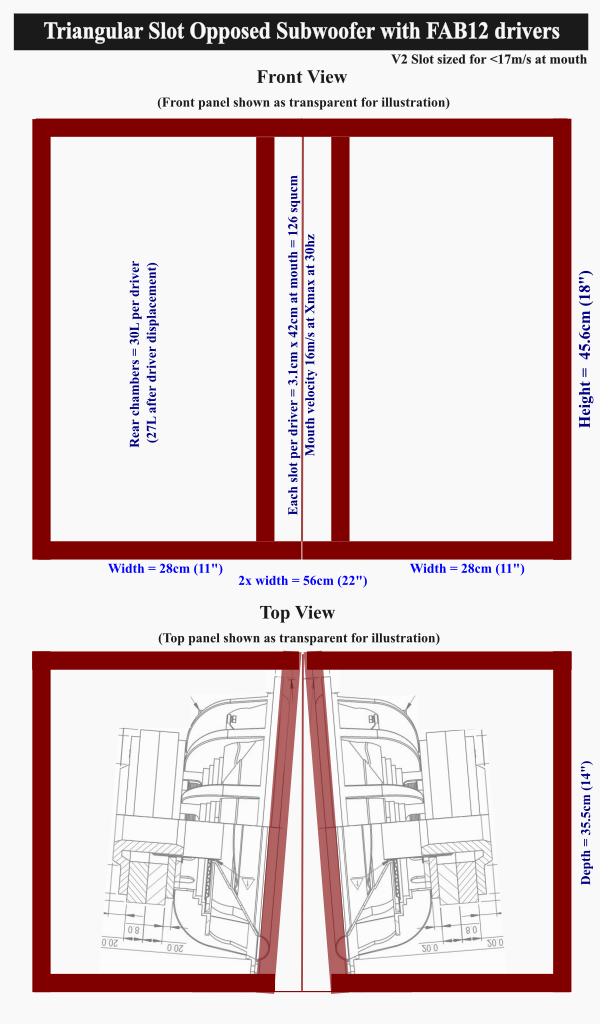

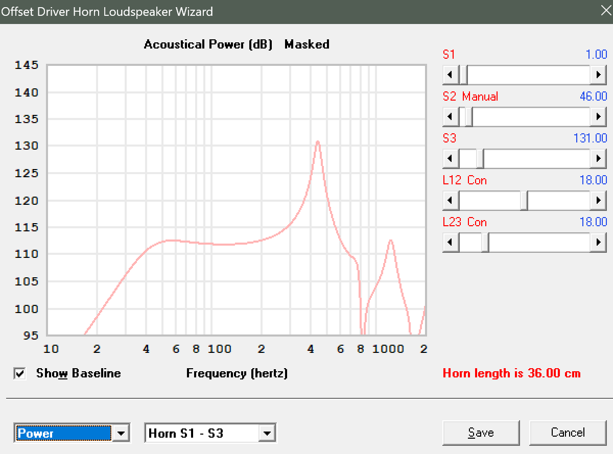

With that in mind I've modelled a conical slot with almost no rear wall area and sufficient mouth size to keep port velocity below 17m/s at Xmax. For the sake of starting somewhere, the rear chamber is 27L which should add less than 5% air-spring distortion even at Xmax.
The resonant peak has been pushed further out of band as a result, though is still shown as fairly high. The strategies mentioned previously will help me to acoustically lower the peak greatly (even without EQ). Though I gather Hornresp might sometimes overestimate such things, and they are quite sensitive to small changes too. So, probably for someone of my limited ability, testing and measurement would be the best way to play sround with the possibilities.
This is a drawing of one possible way in which this might come together; shown are two subwoofer boxes:
The intention now is that these will simply be individual sealed boxes per driver, just with a slightly angled baffle.
They could then either be used as individual sealed boxes or they could be fixed together for dual opposed configuration. I suppose as individual boxes, they could also be pushed against a wall or have panel added to make a slot, but I increasingly think it unlikely that I'll want to use a slot if they stand individually. For me, the slot is still mainly just a way to make two opposing drivers both fire forward.

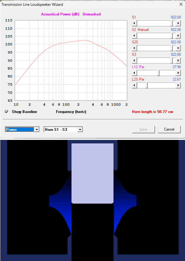

You could just fix rectangular boxes together with a "V" slot, just angle the connector piece rather than the baffles and cabinet sides.The intention now is that these will simply be individual sealed boxes per driver, just with a slightly angled baffle.
Fewer angle pieces makes construction easier!

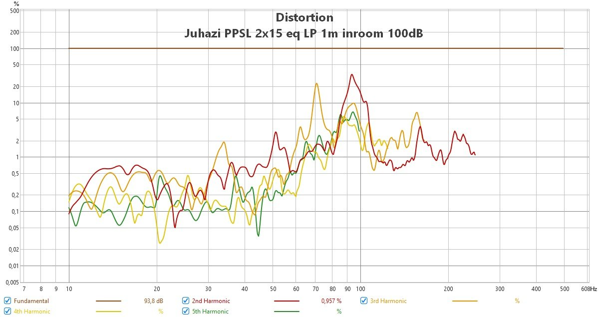

Weltersys linked his old measurements that very well prove the reduction of even order harmonics. The problem is that odd order is more easily heard and it did not change.
So, did you hear a difference between those?
However with high spl in-room There are other mechanisms that can cause more distortion than the loudspeaker itself (Other ojects resonating). Here my PPSL 2x15" sub measured in-room. Nearfield measurements show typical profile unless the UMIK-1 starts clipping

The peak has been pushed reasonably high out of band, with the V-shape to the slot. But yes, I am also thinking of reducing the peak's magnitude (acoustically, not just electronically). A U-shape would spread it upwards in frequency and lower in magnitude, so seems sensible and relatively easy.
I'd thought that e.g. 400Hz would be quite low in frequency for damping to take much effect, but you have got very good results there, so that is definately very interesting to see. It could be better and perhaps even simpler than shaped slots. I can envisage a wedge of damping material in a kind of phase-plug shape to bring it forward without blocking the drivers, or (as their diaphagms are concave) maybe a lens-shape could be put in the middle of the slot between the drivers.

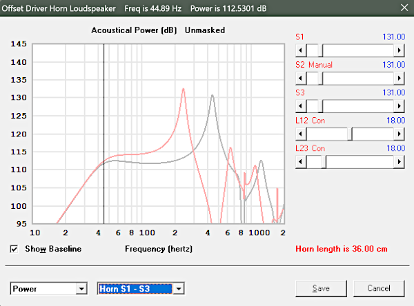

EDIT: Though just to illustrate, here is a Parallel-slot (red) vs Conical-slot (grey) response chart. Same slot mouth, and about the same mouth velocity in both cases:
Though that is without any damping or packing to the back of the slots. It seems to me that a parallel slot might accomodate more damping material than a conical one, without 'blocking' the drivers too much, and would be combined with a U-shaped back to further reduce it by spreading out the remainder upwards.
(in my case I'm intending EQ so there is flexibility to flatten/tweak some aspects of the response shape)

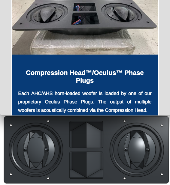

That sounds about correct.A proper phase plug would seek to take up all open space, I think.... It would try to occupy the space inside the cone, only allowing enough room for the cone to reach xlim, and then only enough CSA to not cause velocity related issues. Right Art?
Dave Gunness/Fulcrum Acoustic's Oculus Phase Plug is a good example of a proper phase plug for combining the output of two woofers:
The same type of phase plug could be used with drivers facing each other.
That said, no need for phase plugs with subwoofers, the offset "V" loading pushes the peak/null well out of the pass band.
