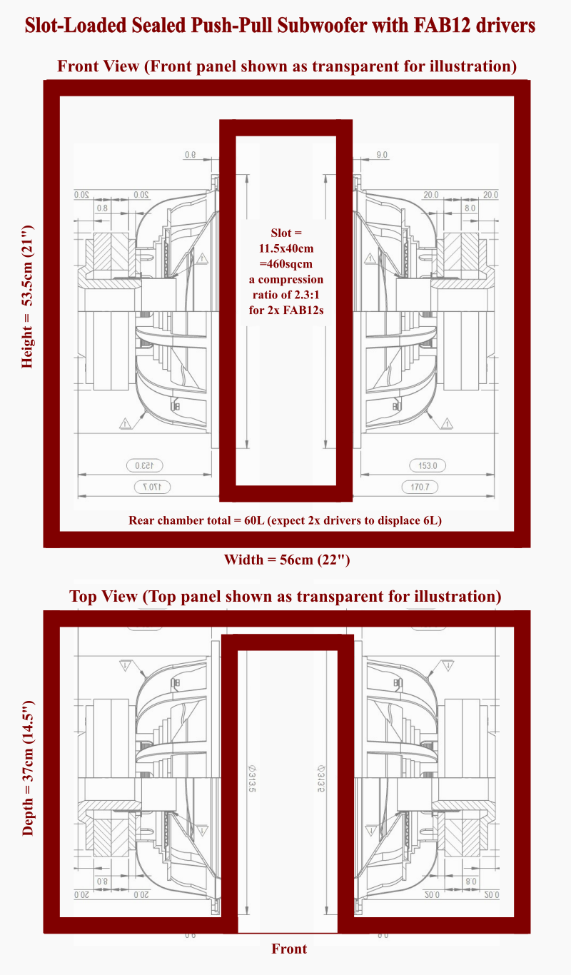

I'm getting keen on building one of the above-titled subwoofers (for mainly music with occasional films/movies), I believe some might call the design a sealed 'PPSL'. The intention is for it to be usable in future as a normal room subwoofer, and if successful it'll be part of a multi/distributed setup of three or more. But in the first instance my use case is for a very near-field listening situation, and an attraction is in the single/small slot area from which the sound eminates. This could be located quite neatly close to the listener's head/ears - the aim being partly for the direct sound to dominate room modes and reflections and partly to minimise SPL needed which again reduces excitation of room modes (and complaining neighbours).
[major edits...]
It would be convenient to have the sub positioned in/on shelves immediately behind the listening chair, in order to locate the slot's outlet at ear height.
[more edits...]

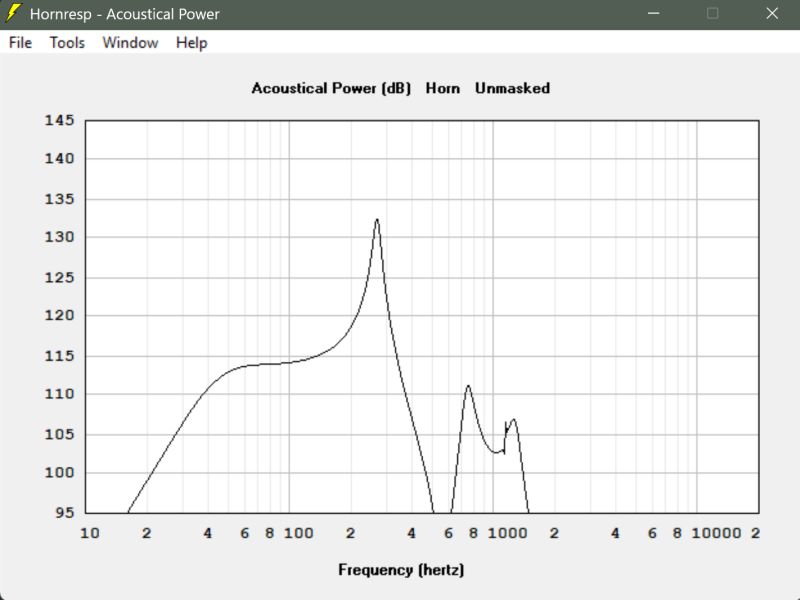

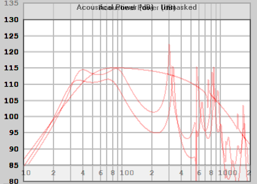

I would think carefully before building this exact system for nearfield use, where all the output will come from the slot and the exit will be located near your ear(s). In that case you will be MUCH more sensitive to the slot resonances. These are not 100% EQ-able, because any air movement can excite the 15dB-tall resonance even if there is no frequency component at the resonance frequency.
Because the exit will be close to your ears and your hearing is more sensitive to higher frequencies than lower ones in this band, you should think carefully about how it will sound.
When the system is far/farther away in the room, these noises are or will be much less of a problem.
Thank you, Charlie, that is a very important point. I haven't thought enough about that, i.e. that the EQ might only be a partial solution.
There are several things I can do to significantly reduce the peak acoustically, so whilst I'd been a bit carefree of those, I'll now pay more attention and alter the design a bit. It does seem like relatively minor changes can very significantly reduce the peak, so there might be cause for optimism. Especially as my intentions for the slot are just to (basically) bring two drivers together, rather than to do clever things wrt response etc.
Perhaps this is partly a compromise from wanting dual use out of these; a pure nearfeld design would likely choose a different path. I did look at the bandpass option that I think you suggested, but front chamber sizes conflicted a bit with requirements for compactness. So if simulations and prototypes for the slot don't work out then probably I'd go with simple sealed arrangement, and just be inventive about getting it close to the ears/head.
In fact.. that might be the better option anyway, and not necessarily mutually exclusive. Between what Juhazi has done and what GM has mentioned, I'd expect that a pair of sealed subs could fairly easily be configured into a dual-opposing design. It would just take serious attention to how well they're mechanically coupled.

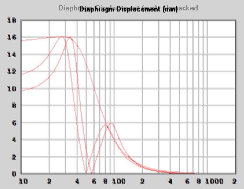

Just as a small point of interest I compared a 30L sealed box to two 4th-order bandpass designs totalling 54L and 40L internal volumes respectively. Without exceeding Xmax, I got the following output
Unsurprisingly the bigger BP is slightly louder around 25hz which is the kind of low-end that I'm targeting.
But interestingly (to me, anyway) the displacement chart shows how quickly excursion drops off with the bandpasses, particularly the smaller one
suggesting that there would be opportunuty to EQ the lowest frequency up a little bit. As I've got plenty of power available it might be possible to use it in allowing a smaller rear BP4 chamber.
I can't do quite as much to reduce the front chamber because of the necessary tuning; the port length starts to become undesirably long. In the above examples it is about 45-50cm long and only just large enough to keep port velocity below 27 meters-per-second at Xmax. However I've been told there are ways to handle the higher frequency peak resonance, which I wasn't aware of when previously considering bandpass. So that is quite intruiging, potentially reducing one of the undesirable limitations, and so something I want to inverstigate further.

HaaI'm getting keen on building one of the above-titled subwoofers (for mainly music with occasional films/movies), I believe some might call the design a sealed 'PPSL'. The intention is for it to be usable in future as a normal room subwoofer, and if successful it'll be part of a multi/distributed setup of three or more. But in the first instance my use case is for a very near-field listening situation, and an attraction is in the single/small slot area from which the sound eminates. This could be located quite neatly close to the listener's head/ears - the aim being partly for the direct sound to dominate room modes and reflections and partly to minimise SPL needed which again reduces excitation of room modes (and complaining neighbours).
I already have drivers that I want to use, similar to the classic LAB12 but in this case called the FAB12 from BK electronics over here. Looking around at LAB12's use in front loaded horns, an Sd:horn-area ratio of 2.3:1 seems to be considered a reasonable compression ratio for them to handle. A slot is not quite a horn, but I shall let that ratio guide me as to what is sensible. In terms of slot length, the shorter the better for pushing reflections up above the intended frequency band; due to driver diameter that would be about 320mm or 12.5" as a minimum. I modelled one driver firing into such a slot, with a 25L rear chamber and enough power (~600w) to reach Xmax:
Hopefully that is right; I modelled it as an offset driver in a straight sided 2-section conical 'horn', though with a slight bulge towards S2 due to the driver cones being concave. That result is without any EQ - in practice I'd want to chop off most of the top of the curve to make it more flat from about 25hz to 80-100hz (the intended range). This will be an active system with PC as a source so such adjustments need not be costly. After which, I'd be left with a maximum of >100dB with just the one driver, in a dual driver situation that would become >106dB at 1m. Way more than I need for initial purposes of close listening, at say less than 30cm/12", but good to know for other/future uses.
It would be convenient to have the sub positioned in/on shelves immediately behind the listening chair, in order to locate the slot's outlet at ear height. Again as a future option I'd like the sub to also fit in some cupboards I have, such as under my TV and front speakers (Ikea 'Besta's). As it happens, the modelled slot volume plus rear chamber volumes do conspire to fit in such a cupboard if arranged appropriately and the slot facing towards the front. Here is a rough conceptual plan to illustrate:
Reasonably large and heavy of course, to be expected with 2x 12" drivers really, but it is all relative; a lot of DIY subs are enormous. Having done some tests I believe that I could move it around okay, anyway. Probably I could also take the drivers out for house-moves. I may even make the front-baffle+slot one piece that is removable for easy access to the drivers; the remaining cabinet could then double as a storage box, too. Obviously, that would involve some attention to engineering, to be successful.
I had initially considered building this sub in two halves, perhaps to use just one half for very nearfield purposes, and somehow bolting them together for when higher SPL and opposed drivers were needed. However that adds complication and I've seen a few comments around the internet which suggest things are noticeably better (with PPSL designs) if the two drivers share the rear chamber rather than having one half-sized chamber each. I don't know if anyone here has experience of that?

Just as a small point of interest I compared a 30L sealed box to two 4th-order bandpass designs totalling 54L and 40L internal volumes respectively. Without exceeding Xmax, I got the following outputView attachment 1406082

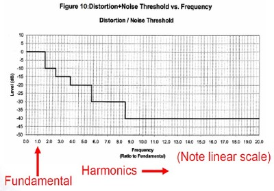

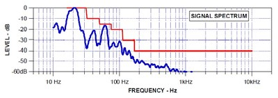

How much distortion is OK? One way to evaluate sound quality for a subwoofer is via CEA-2010-A testing, which specified a separate level maximum for each distortion product, and the SPL needed to exceed the threshold is determined. This tell you the level of distortion at which the sub will start to sound stressed. These are:
2nd harmonic: -10dB
3rd harmonic: -15dB
4th and 5th harmonics: -20dB
6th, 7th, and 8th harmonics: -30dB
9th and higher harmonics: -40dB
Keep these in mind when thinking about how low your sub can play and still sound good, taking into account ALL the different contributions to distortion in the system.Reference:

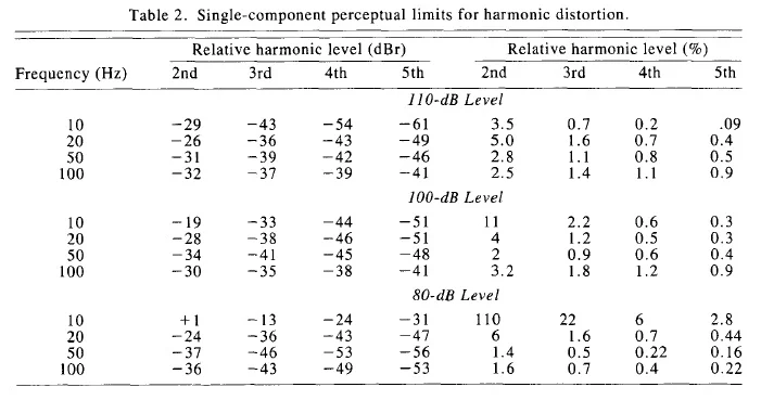

Below 50Hz distortion% should be more that 20% to be heard with sine tone. With music it can be higher without problems.
https://www.audioholics.com/loudspeaker-design/audibility-of-distortion-at-bass
https://www.audioholics.com/room-acoustics/human-hearing-distortion-audibility-part-3
@Juhazi An audibility threshold of 20% distortion at 50Hz seems a bit high to me. Where did you get that number, exactly (I didn't find it in the linked Audioholics web page). For example, this table from that web page has very different numbers:

Thank you, both. Yes it is surprising to me how wide ranging quoted values are for distortion audibility , especially when considering music where masking becomes part of the picture, and beyond that is the further question of what might be audible yet acceptible or sufficiently unobtrusive. I've seen everything from 5% to 100% quoted at 20hz.
So I think it is probably sensible to just look at well documented methods like CEA-2010-A tests and reputable measurements of existing subwoofers to put things into context. At this stage I can plan for some things like the air-spring distortion but will not know others until a prototype is built and tested, so it is all a bit of guess work.
Re the guessing, it seems that with a Lab12 driver Art Welter once measured about 9% THD at 30Hz and 3% by 40Hz at very high power sine wave at 1m outdoors (I believe from a bass reflex design). My drivers are not quite the same, but similar enough that I might expect them to achieve something vaguely comparable. But then my interest in smaller sealed designs would add noticeably more air-spring distortion; a few percent for the kind of box sizes I can tollerate. So, maybe in total I could expect something around 12% THD at 30hz. All very rough guessing, but possibly enough to manage expectations.

Charlie, ~20% treshold for lows (below 50Hz) is my observation, for myself and some friends, playing sine in-room from single speaker and slowly adding spl. Room modes will affect audibility enormously. No science behind it. -15dB is 16.2% which is said to be treshold here https://www.audiosciencereview.com/...audibility-of-low-frequency-distortion.18187/
I could not find AES articles or other source for audibility listening tests, about how the limits were defined. I am sure that there must be individual variance too. And of cource tests should be done in anechoic chamber or at least outdoors with very low ambient noise (in desert without wind or jetplanes).
https://audioxpress.com/article/cta-2010-a-better-way-to-measure-subwoofers
With music we know from scientific tests that low harmonics add spl we hear, and fundamental is not so important (psychoacoustics). This is tonal coloration similar to music instrument's spectrum of fundamentals (tonality). https://en.wikipedia.org/wiki/Missing_fundamental
With REW anyone can test distortion and audibility by sines or CE-2010, chapter 19. https://www.roomeqwizard.com/REWhelp.pdf

Yes it is an option, the floor effectively becomes another way of making a detachable slot! Unfortunately though I've not had the best experiences with largish woofers positioned in that orientation, due to the suspension sagging over (lots of) time. I'll still use it in opposed situations where one can turn the box upside-down periodically though.
Thanks for the distortion info, too. I'm going to have to read up on how to measure these thing in REW, when a prototype exists to test. Though yes, I'm also interested in what is actually noticeable (by me and other human adults). I have little doubt that at my normal listening levels things will be okay, and especially when in nearfield mode, after that I don't mind 'too much' if the measurements are a bit more lacklustre when pushed to extremes for fun or sound-effects. But as a minimum I still want to avoid any clearly audible artefacts even then - noticeably muddy or strained, port chuffing, rattling etc. would be an indication of having gone too far.
