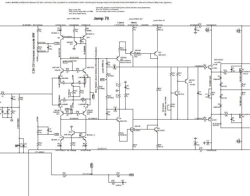

I tried 57v, 50v, 30v and the behaviour is similar. My bench psu is regulated...Does supply voltage change the VAS current?
I tried r12 1k5 and variations are much slower and the difference is only 10ma to 9.5ma. Will try higher ips current and 1k2 for r12
After trying Cordell's solution (4k7ohm between collectors of the IPS mirrors) and having verified that it also sets the VAS current with fluctuations, I decided to go back to my solution.
Reduced R12 to 1k and placed small heatsinks over the VAS buffers Q4 and Q6.
It is reasonably stable (it changes every second) but within 11.6m_A and 11.3mA.
I lost some dB in LF Loop gain and THD20 went up a bit but damping factor at 100Hz is 5k7 so bass is not compromised.

Your solution is quite complex....
With 4mA in each input jfet I am having trouble to set VAS current lower than 16mA
I managed to have the same vdrop over the mirror resistor R2 and the VAS emitter resistor R11.... but....
Increasing VAS Re to 47ohm gets me in the ballpark.

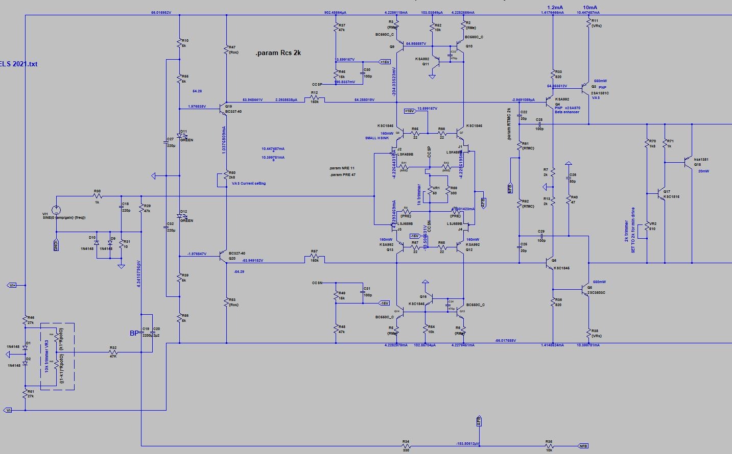

Please look at my latest design.
It does not need local feedback.
VAS current is set by a mirror based CCS so it is independent of IPS current.
OLG is maximized so THD is minimized.
The only doubt relates to the connection of the VAS buffer... it is almost like a darlington but not quite.
Hope you have the time to look at it and let me know if it can be done 🙂

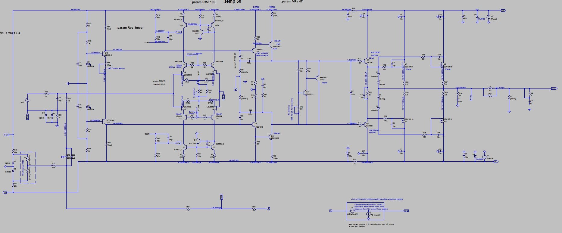

My most recent development...
Here I do not use resistors to try to set a fixed current in the VAS... instead I implemented a ccs that sets a fixed voltage in the bases of the VAS "helper" transistors.
It seems to provide a very stable VAS current without compromising OLG.
I am not sure if this solution is works in reality so I hope you guys can help me with your comments.
I did not have the time to include my models in the asc files so I am including those in a txt file.

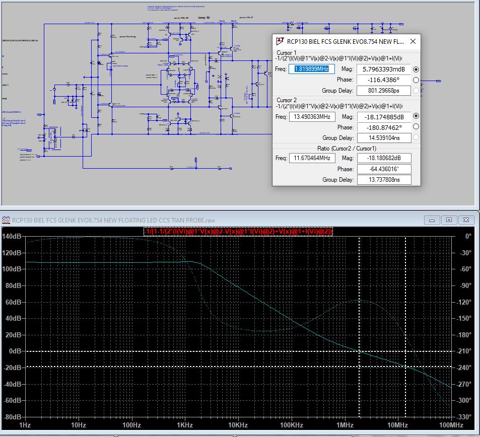

I modified the circuit values to have a stiffer CCS setting VAS current and added two 150k resistors R12 and R57 so to increase it's impedance and maximize Loop Gain.
Simulations seem very good but there is surely room for optimization.
Maybe the ccs current setting resistor should be split in two with center tap grounded ... ??
I really need your input here.
