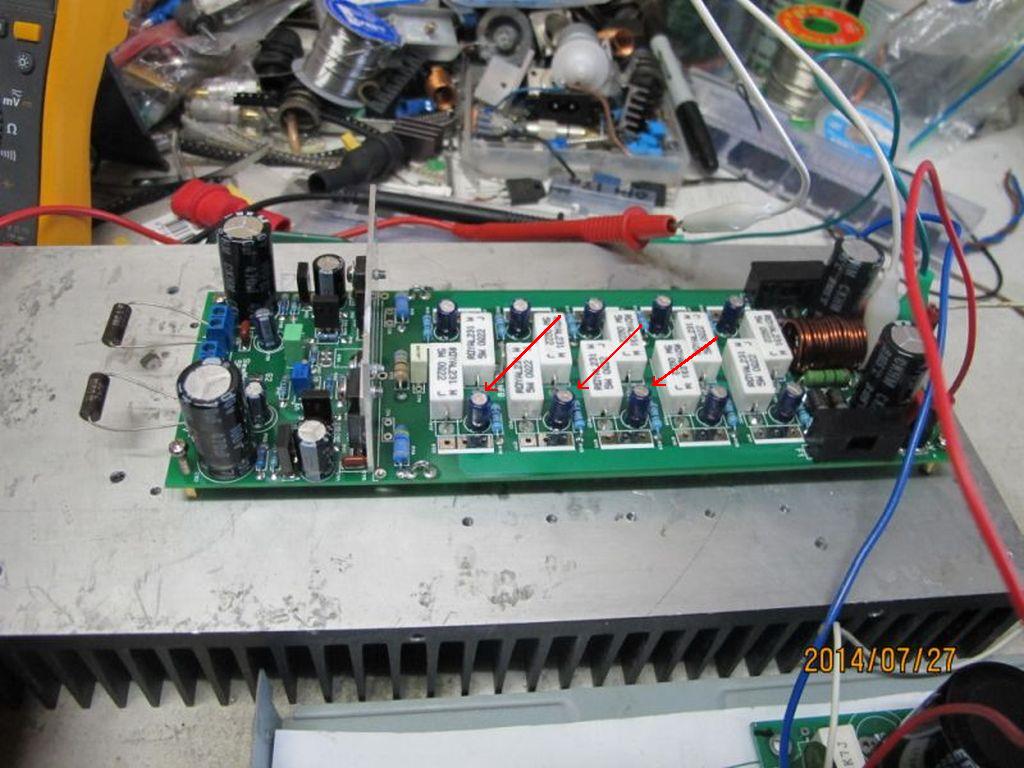

Hi
It look like these capacitors no longer on the PC board (red arrows)
Am I right about that?
I plan to build the BJT version🙂

just to be sure...
R102/108 22k
R101/109 470r
Hi Evan,
On the board, R108 goes between Q102B and the rail. The schematic shows that resistor as R109 (470R). On the board R109 goes between Q102B and ground. On the schematic, that is R108 (22k). I don't think the screen print is correct. The schematic should be changed to match the boards and posted somewhere for all to see so those are not reversed. What you have just posted is not correct.
It should be;
R102/R109 22k
R101/108 470R
Blessings, Terry
