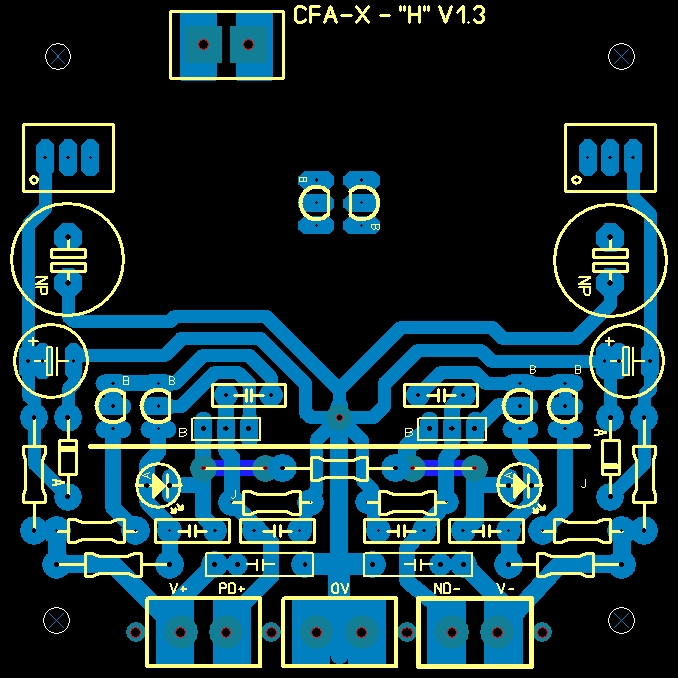

I await your interpretation of the CFA-XH. I think it will likely be the go-to IPS and if I order more OPSs I will make at least one IPS available (likely this one) at the same time.
I have several MJL3281/1302. Any drawback to using these for the the outputs? My plan is to build 4 of the slewmonster boards so I will be able to have two separate complete stereo amps for comparing topologies. I have enough of these outputs to complete all 4 boards. I don't have enough of the 4281/4302 of 21193/4 to complete 4 boards.
Thanks, Terry
The outputs you have on hand, the MJL3281 / MJL1302 pairs, should be perfect for the OPS board, IMHO.
