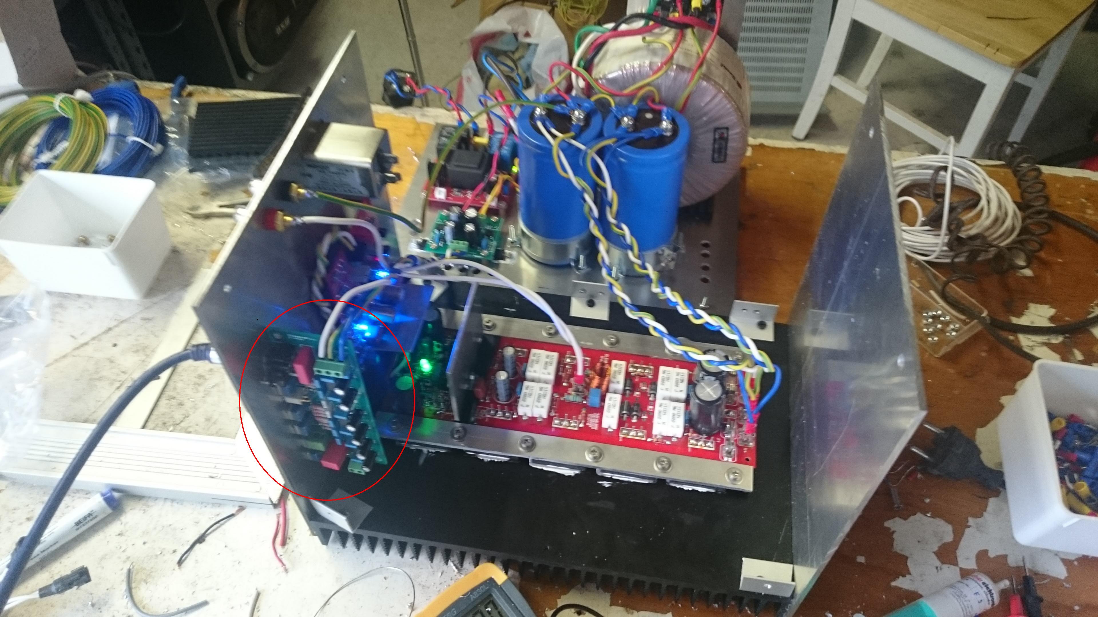

800Va 2x50v tranny giving me around 72v rails (I planned for 80v rails, but received the wrong transformers), 2x39000 uF caps, arc welder ops with 5p Sanken 2sa1295/2sc3264, njw0302/0281 drivers, spooky front end.

That's a subwoofer x-over, the one Jwilhelm designed in the thread I posted.
I later took them out of my amps because I decided to use minidsp 2x4hd instead to make integration/adjustments easier and to high pass the mains.
