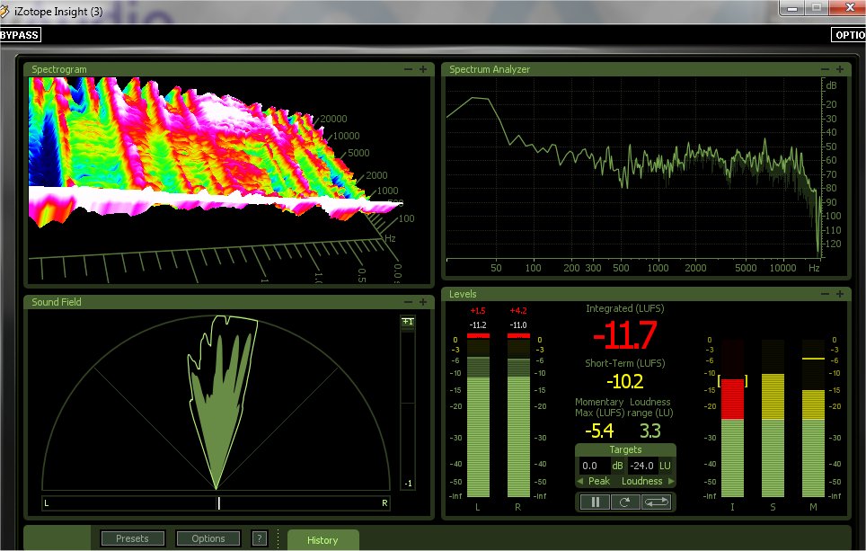

OS what do you use or like to test bass response or fidelity and power tightness? I like this on you tube as a sampler of thickness and such. https://www.youtube.com/watch?v=gDcaL3eFSr8. Any other suggestions out there?
Youtube , are you kidding. I want 24hz with >100db noise floor FLAC .
I would never bother with youtube garbage .. like "DX" does.

There's a good Honeybadger video on YouTube.https://www.youtube.com/watch?v=4r7wHMg5Yjg
None of those youtubes could do the lowest octave or the highest .
How could you evaluate with those sources ?
The two youtubes could barely reach 1 on the "LU" scale ,
sharp cutoff at 40hz and 12K ?
"bass tech" can reach 10 LU and 25hz - 18Khz - the real deal !

Thank you , jeff .There's a good Honeybadger video on YouTube.https://www.youtube.com/watch?v=4r7wHMg5Yjg

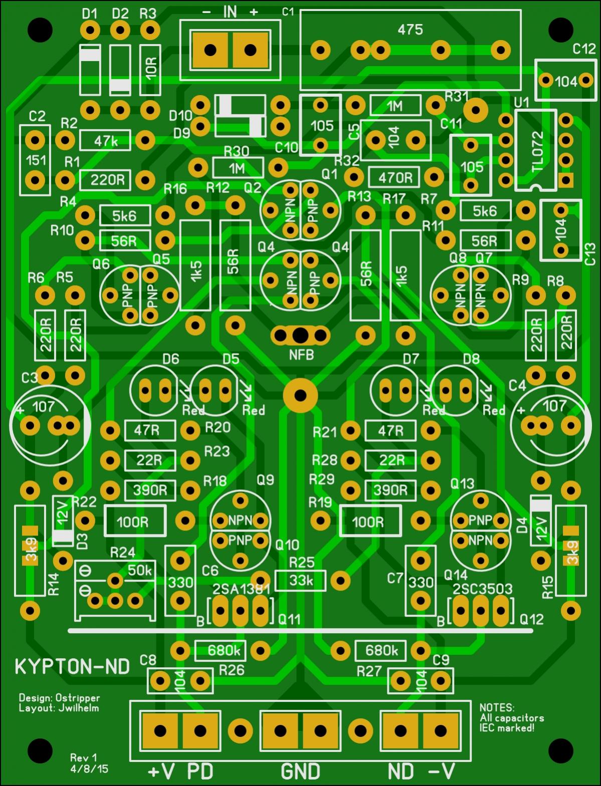

My good friend , it looks nice. Being Two sided , I can't check it in my mind.I think it's ready. I'll check it over again in the morning.
does the software check the connections electrically ?
OS
Sprint has a tool that highlights anything that is electrically contiguous, irrespective of the side it is on. It helps with checks.
Yes I've checked it with the test tool a couple times now but I've been staring at it too long. I've gotten spoiled with Diptrace. I verifies with the schematic automatically so if I don't make a stupid mistake on the schematic, it always works.
OS
Did you upgrade to Sprint 6 or are you still on the older version?
And the DRC checks are helpful too. They help avoid things like lack of clearance, silk screen too thin, silk screen over a pad, etc. I always make sure the layout passes all available checks.
I am hooked on "the mind" , I visualize the whole. I'd be "scared" to let
my PC take my precision away from me . 😱 (old school - go back to 1999)
Funny thing - add about X4 , I'd still get it. The PC would still beat me ... 🙄
10 years from now , I'll be killin' terminators ...

I still do my own layouts, autorouters suck at it. But I let the PC verify for me. I get all the hard stuff right but miss the obvious stuff.
yes , even my 5 has that !Sprint has a tool that highlights anything that is electrically contiguous, irrespective of the side it is on. It helps with checks.
