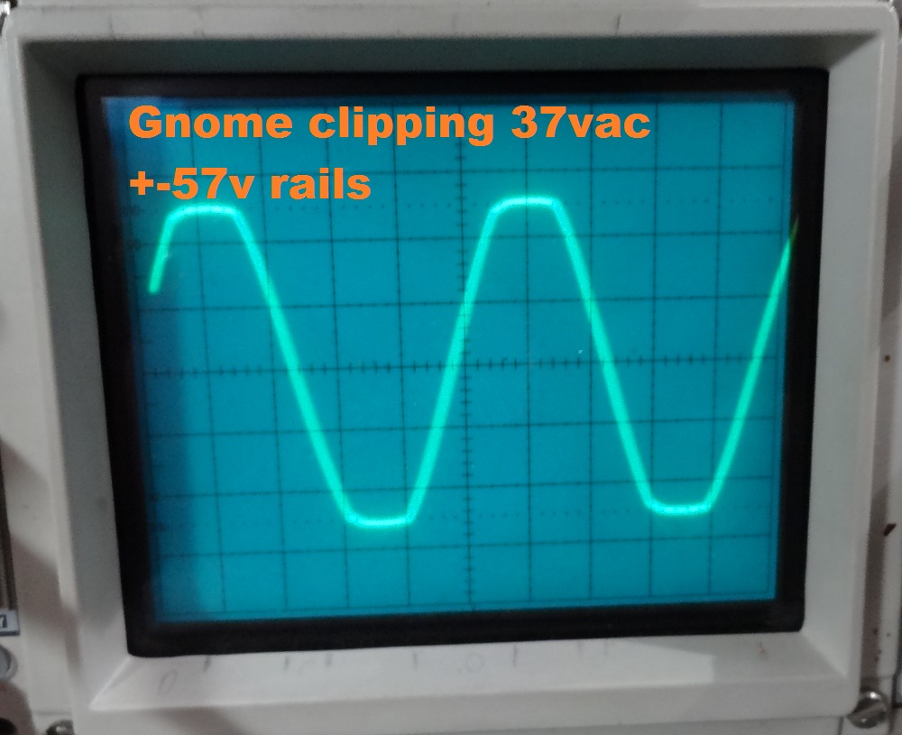

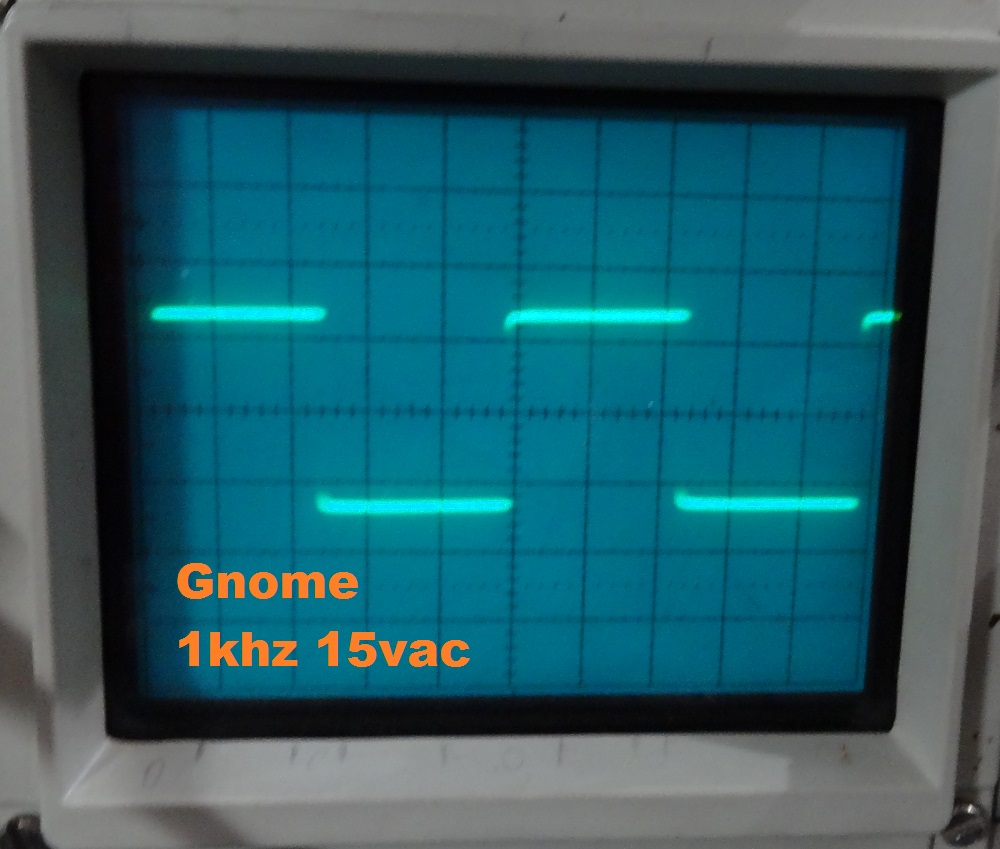

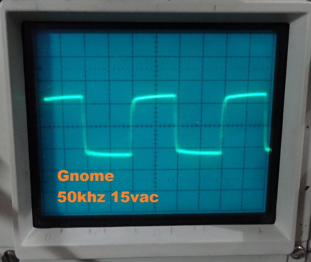

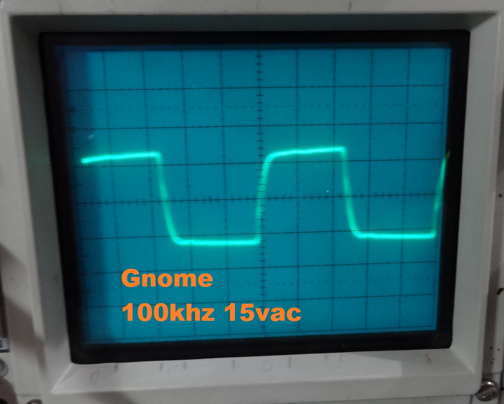

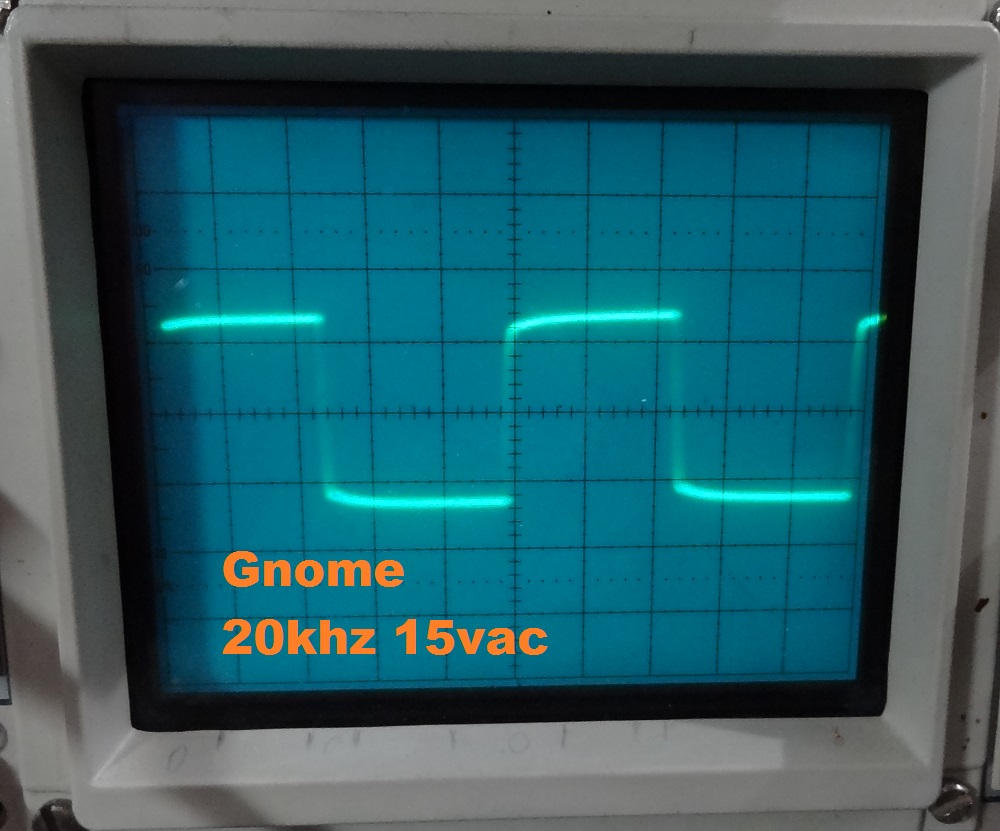

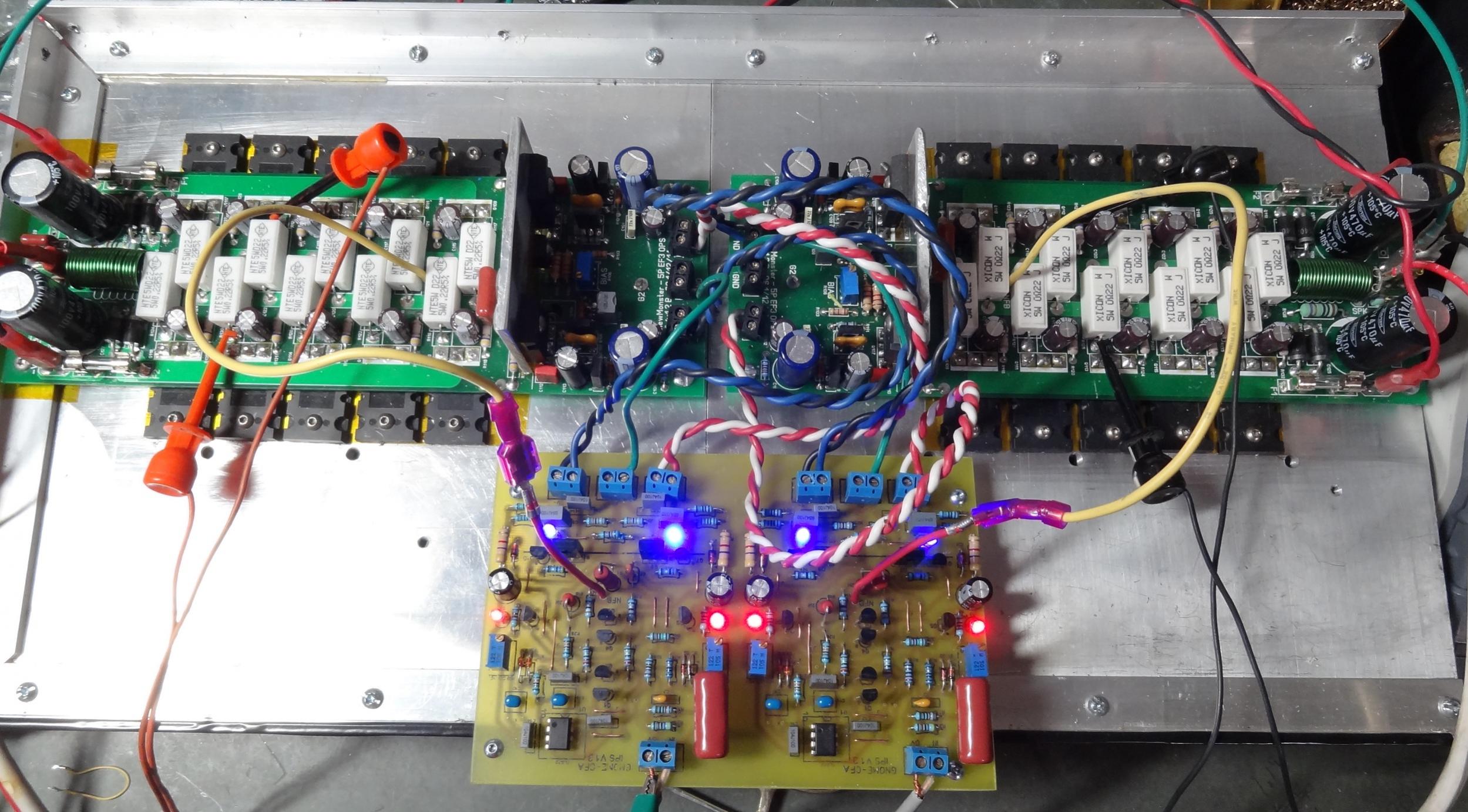

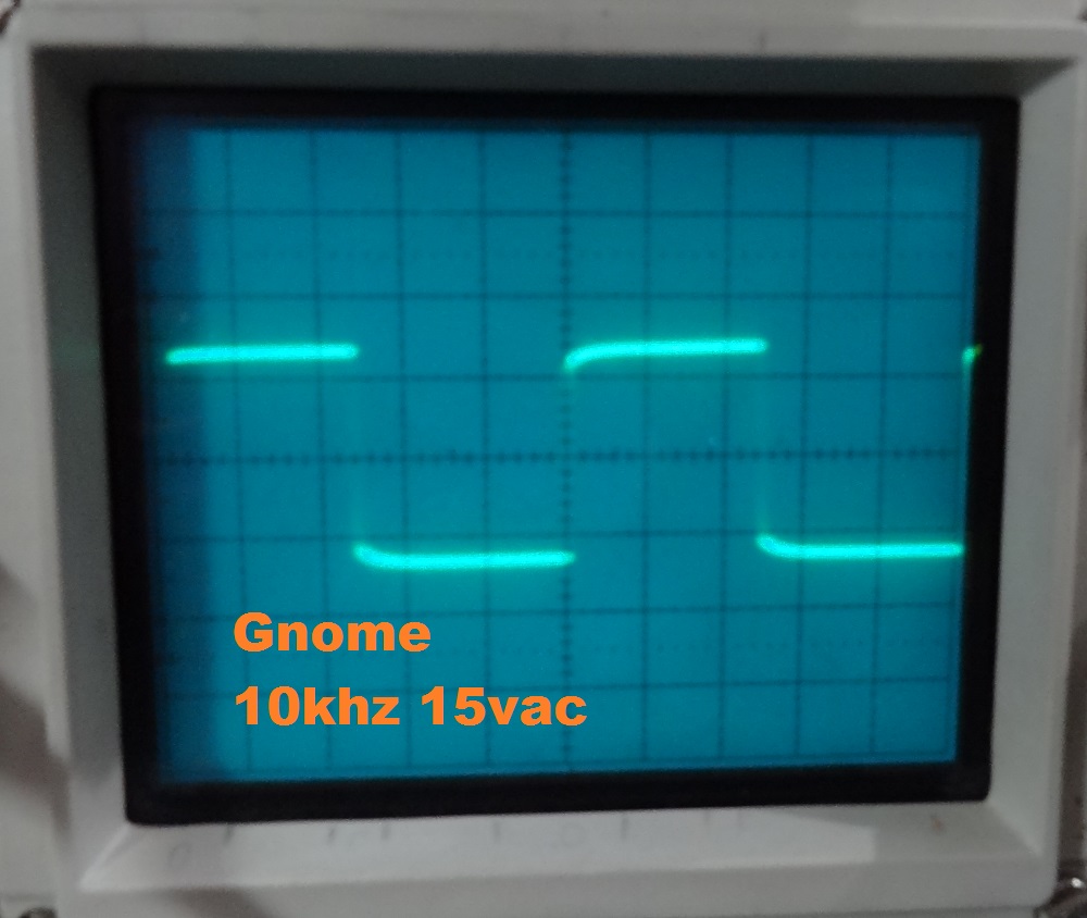

Finished the Gnome. Nuked? This baby sings!!!
I must say I am surprised this one didn't make it into the production boards. Really, really nice. Worked first time right off the bench.
Blessings, Terry
