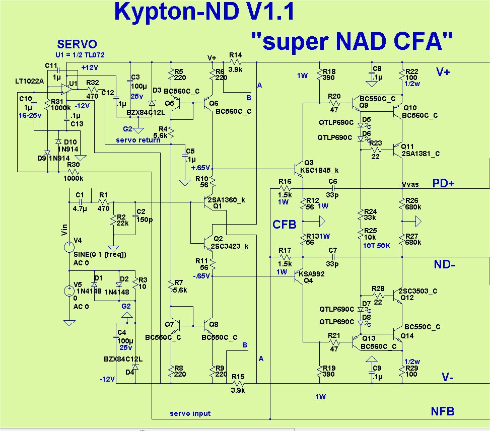

One more design consideration I overlooked - what happens if the
lifted ground is raised to .65V ?
I looked at what Bonsai did on the NX amp (similar). He must of seen
this issue of where to reference the diamond's ground.
This "issue" does not happen on the spooky , as the NFB reference is high Z
and derived from the lifted ground itself (along with the servo -same reference).
Does not happen on the kypton C with it's DC blocker caps . VSSA/K-C
IS a diamond ... really. It just has the feedback integrated into two
devices.
Edit - you CAN't reference a lowZ current feedback amp from the lifted ground -
The ground would modulate with a high output level !
My almost finished Kypton ND (below) is without blockers , at the mercy
of any ground reference offset. So , like the NX .... both the servo and
input filter HAS to be system referenced (G2).
Otherwise , just .65V on the lifted ground gets you 20V DC at output ! 😱
Glad I simulated my 3 servo amps to finalize this small bug.
OS

Yes - the "beats go on" .
- Below 1-3
My usual finished deal , with voltages.
Red=V+/ blue=V- / green-0V / yellow= AC paths.
Almost ready for "release".

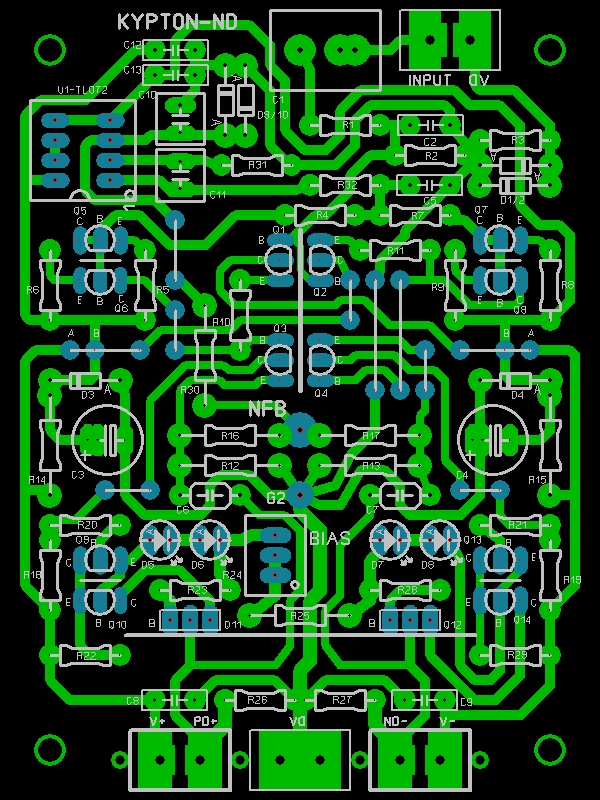

I wanted to mention something if it is do-able. A lot of the IPS boards have been done with a 7.6 x 3.17cm outline. The board house I use gives a huge discount if the maximum dimension is 10cm. If you can squeeze the board down to 10cm the price is about half. Just something to think about. Looking forward to building this one.
Blessings, Terry
Blessings, Terry
I've already been doing that. It's such a small difference (.075") nobody noticed.
Blessings, Terry
This one is 101.6 X 76.2mm - to "shave" 1.6mm would not be an issue.
If it goes to the board house , 2 layer conversion will be done anyways ...
so that 1.6mm can easily go.

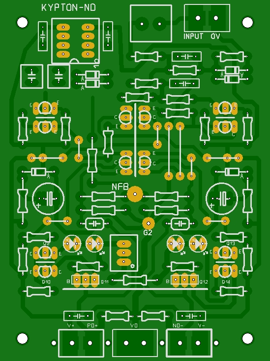

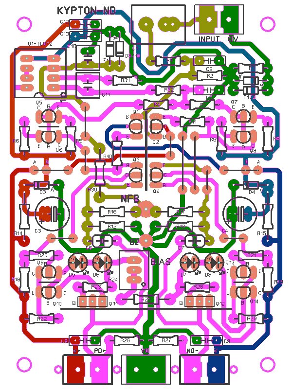

On this one ...
- note the "A/B" on the rail jumpers , 12V or full rail for diamond
are options that will tweak the thermals. I think the high voltage for the diamond should work good.
- Unlike the NX , any grade to-126 for the VAS - it's cascoded. The
super-pairs (Q9/10 -13/14) matching is more important.
- Q1-4 are the "core" players. Being servo'ed in this unique way is great
for "villagers" 😀 . Even a mismatch will get you >20ppm !
-All RED LED's .... no blinding VAS here. 😎
Let me stare at it for a while - tweak some traces ("prettify" it.)
