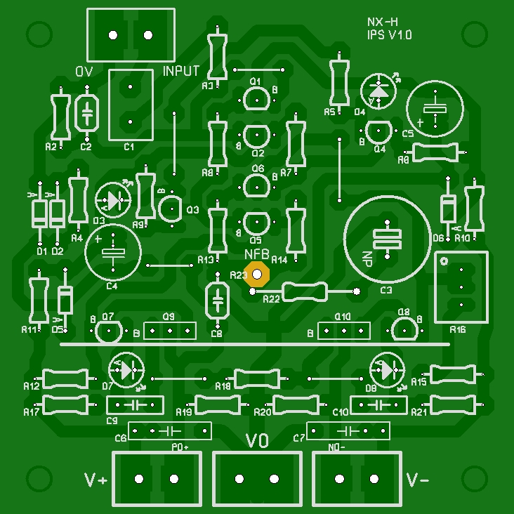

Concerted effort ....
After a beer :drink: ... I treat the CFA core like a OP-AMP (below).
Real tight... at 20 X 30mm with dead short traces 😀 .
All the "accessories" (CCS/zener/input filter) will be in the leftover space.
I should have enough room for a 35 X 25mm "audiophile cap".
Damn , this is the 4'th re-arrangement. But this is my first of this "alien"
topology. :scratch1:

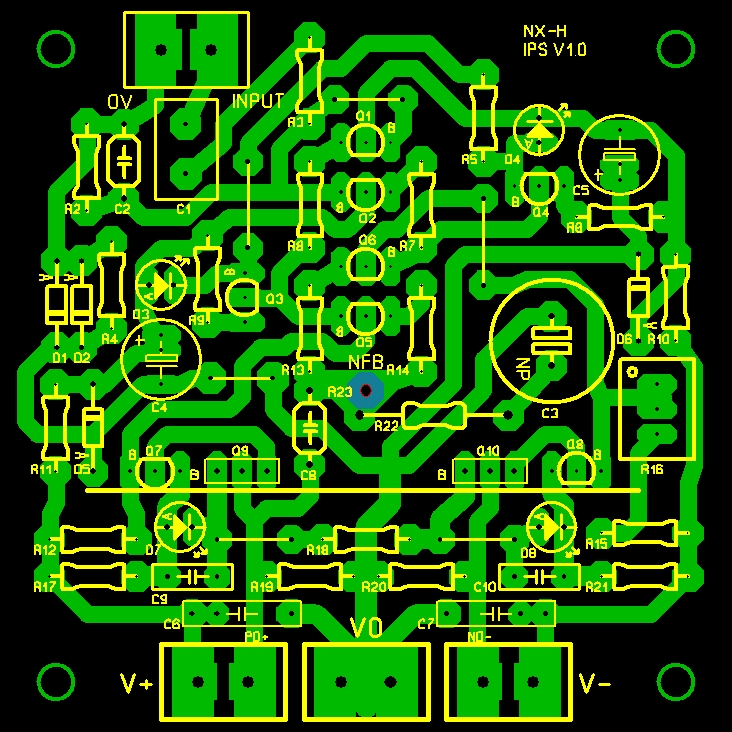

... The final push to complete the CFA IPS ... (below)

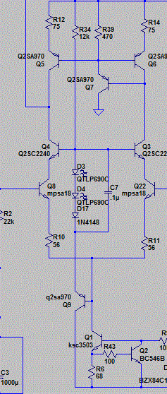

No "cold war" just constructive suggestions. The question has to be answered: Why tube amps are still better than most of the complex and low THD solid state amps? Suggestion: Integrity of the signal, its preservation from the input to the output. To achieve this, signal path should be "clear", meaning no details leakage, no lost on the way. Low THD amps should not be low THD on an account of a loosing signal details, THD meter will show low number anyway but that will not tell you how much of the input signal structure - details are missing. That's why sine signal THD measurement is telling only a little but not enough of the sound quality of a certain amp.
One practical example refering to your VFA sch is input stage's cascode referenced to fixed potential. At this stage the signal path is not "clear", meaning you will loose a lot of signal's details. Anytime you can check the same input stage with or without this cascode in direct A-B test and the difference is enormous in a favour to sch without cascode.
Ahh , the cat has spoken ...
I designed this ability into the "Badger" , the C-R jumper (option) can reference
the cascode to the "virtual CCS ground"(no zener). This is the "luxman way" as described in the build guide.
Some have built it this way , some have not.
My redesign will incorporate this method with a current source at each
rail.
As far as "enormous" , I don't know. Subtle would be more appropriate.
PS - I've done this modular thing before - had blameless in 3 flavors ( no cascode , cascode/bootstrapped vas)
every combination possible.
OS
For an even better cascode load it with a ccs then your current through the V setting LEDs are not changing with the signal
You mean a positive rail CCS ? right ...
There is a slight V/I modulation at the cascode ... but THD stays the same or
even drops ! My main reason for the cascode ,was both to let the CM see hi-z +
allow for better (and wider selection) of LTP devices.
As I said , this could also be ported to the Badger AND eliminates
a fixed reference to ground .

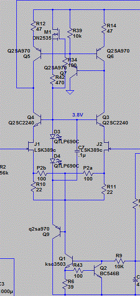

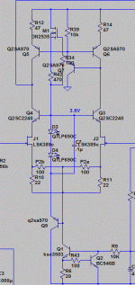

I showed simplified schematic, this is actually used in my TT amp.

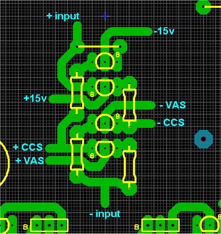

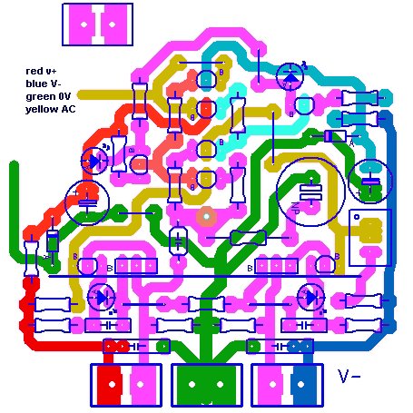

Only the input stage left ... 😱 :scratch:

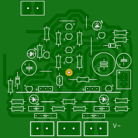

Alien CFA IS a little harder to layout...
Colored the rails just to see where all the voltages are going ... some longer
traces but only 5 jumpers. The Diamond buffer and rail to rail reference is
what made this harder.
OPS's are mostly all ground referenced and symmetrical.
Below 1-2 is the progress. The input will be easy ... just the signal and
the lifted ground (7 more passives).
OS

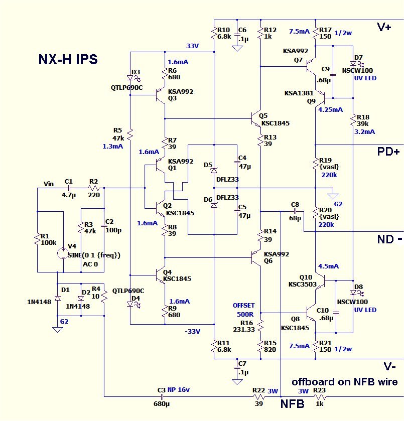

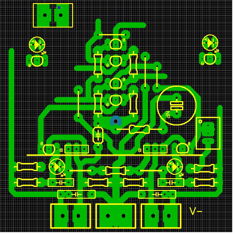

DONE !!
Please help me hunt mistakes !!
Next I will post BOM/schema/artwork.😎
