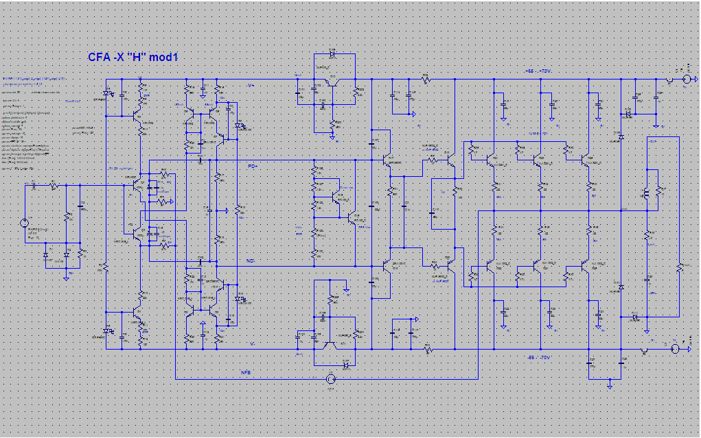

Some pictures to CFA-X mod1 simulation and schematic

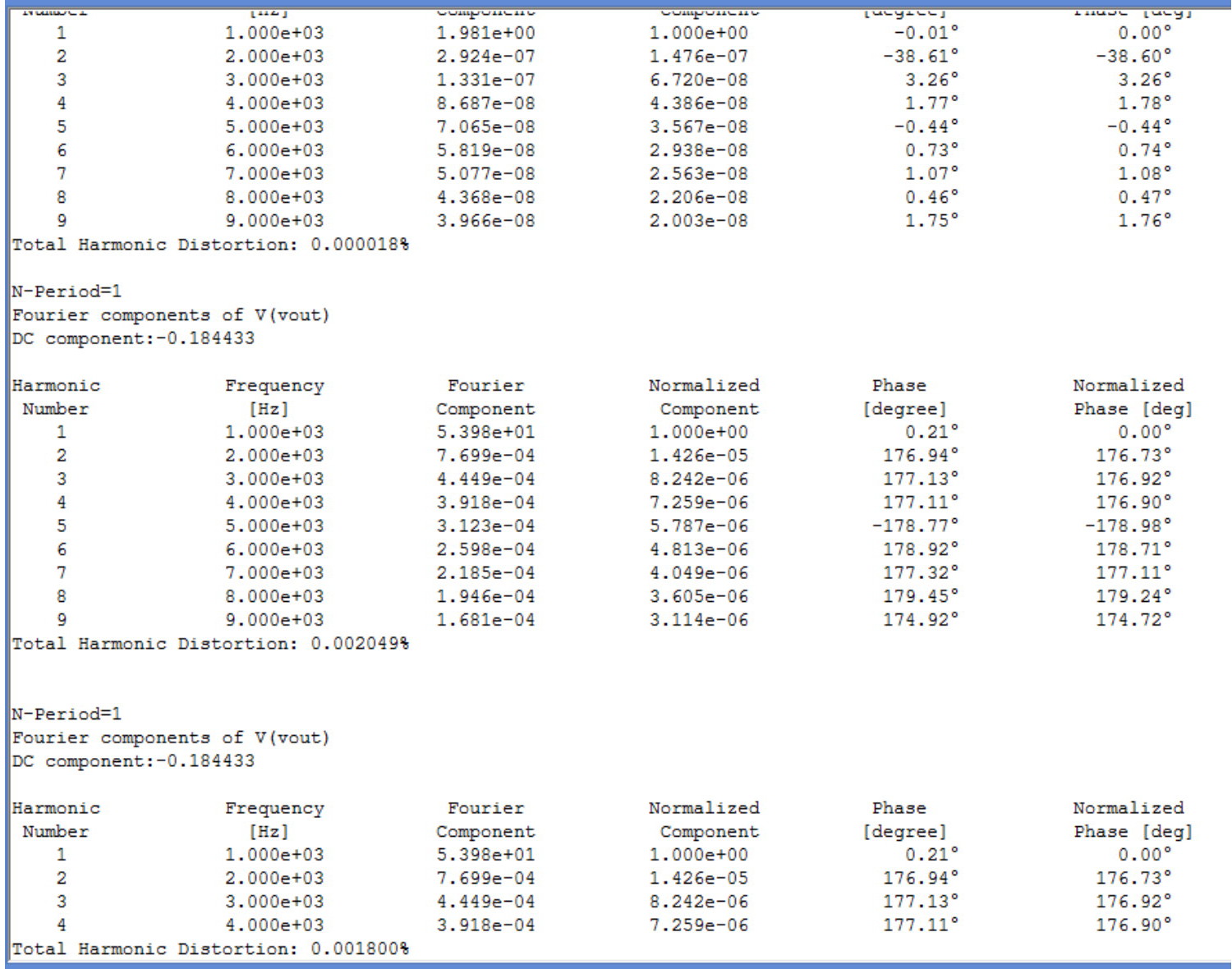

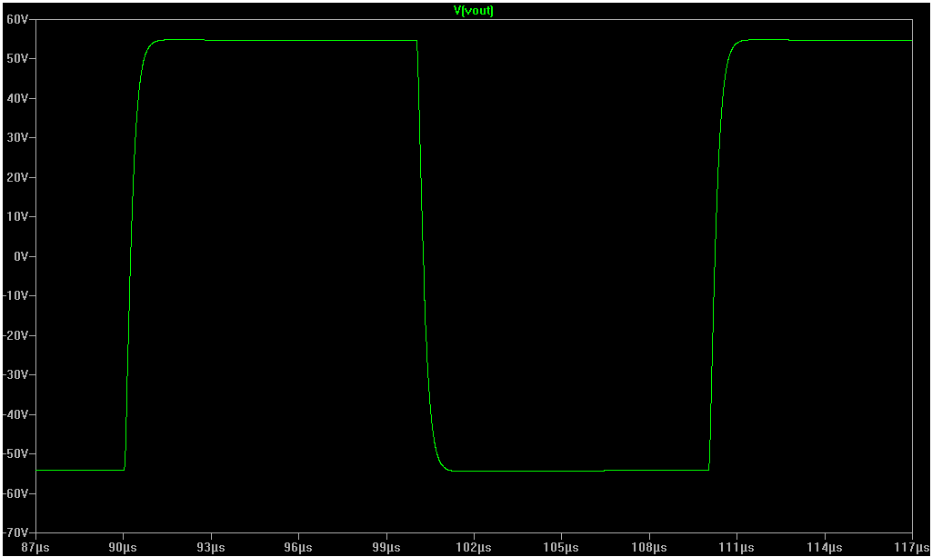

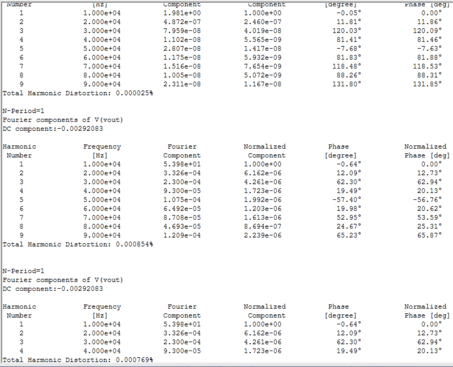

Someone asked earlier how the sim looks at 1K rather than 10K so I ran the latest BV model at both 10k and 1k. Hopefully I did this right. I'm attaching screen shots from the error log. First the 10K and then the 1K. I'll attach the asc file and Slewmaster.txt in case someone wants to check my figures.
BV, I changed some to the part numbers so they make sense to me on my PCB. Hope you don't mind.
Your a genius , BV. That is VFA typical PSRR ... on a CFA. 😱
ps - all that by just including the first stage in the miller loop !
OS
It would be nice when someone proposes a change such as BV has just done that they highlight the changes in red when they do this so you don't have to compare schematics to find the change. Or at least circle the drawing please.

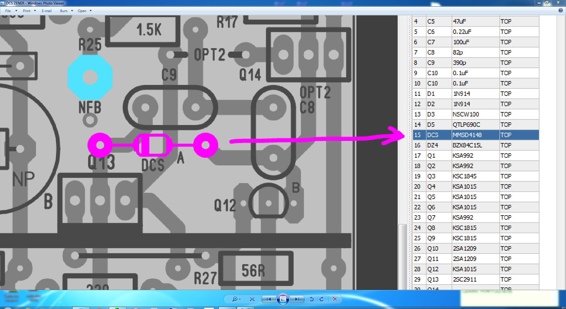

"OPT's" 1-2 ...
1 = ground reference of the input cascode. (just an option).
2= use of a active clamp for VAS saturation (instead of DC6).
Both methods result in the same clipping behavior.
(below example - R31 + Q14)
D. Self mentions and shows example of "opt 2"...
Edit - like the badger ... reverse leakage of DC6 is important. Find one with nA to pA
reverse leakage rating. The "option 2" (transistor) ... most have very low leakage --

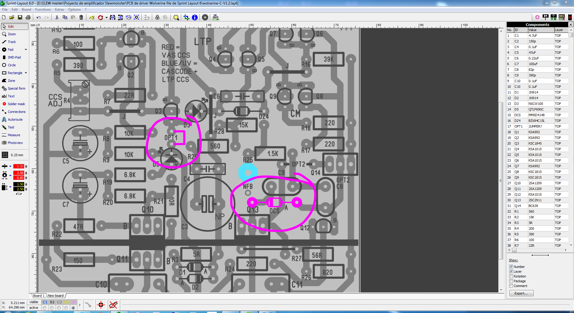

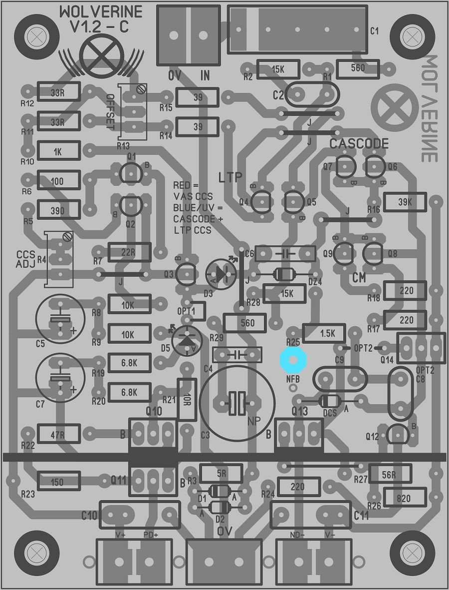

Sorry OS that I didn't respond back,
I really don't want to be too complicated on the layout so I just going to ask you simple questions, man I know you are rolling with new IPS wow! I don't want to bother you too much 😀
ok I'm making a pretty look of Wolverine V1.2 "for myself of course lol" I know there is version 1.3 and I can do that later, but example to be simple if I put it it together all parts all good to go then I can just use the "OPT1" ("I think is a jumper that goes there I'm not sure to be honest") then DSC=MMSD4148 is use and OPT2 is not in use ? I like more the DSC option to use 🙂
I really want it to make sure what I'm thinking is correct 🙂

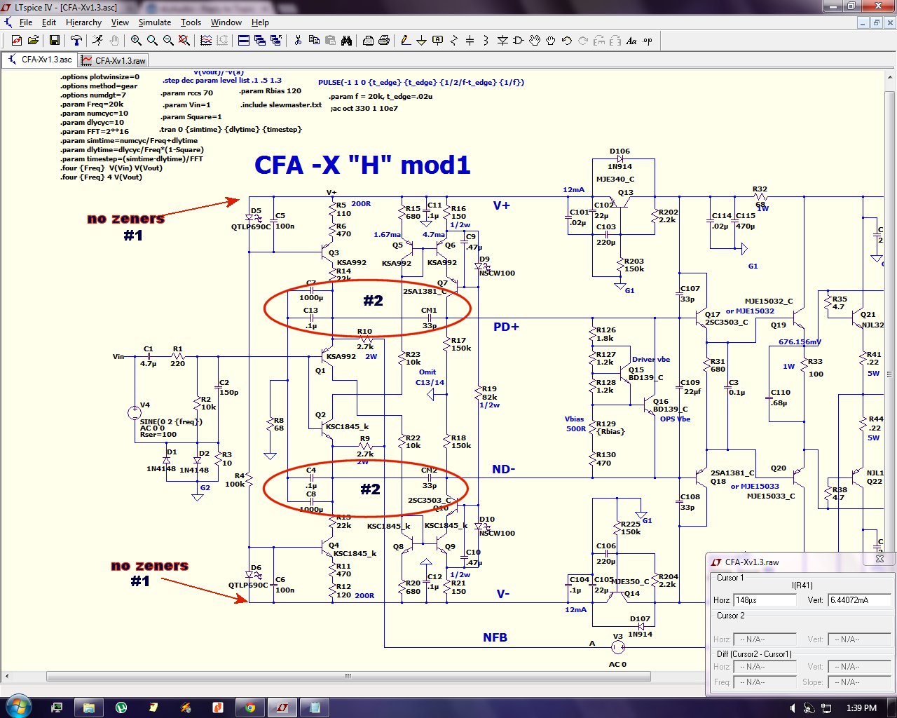

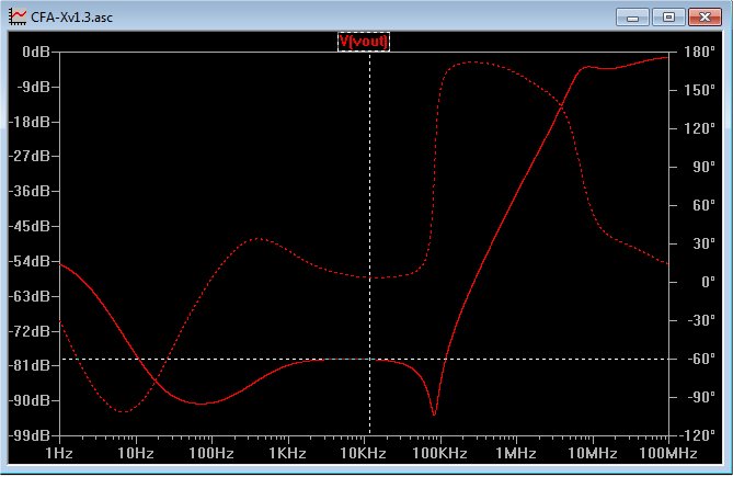

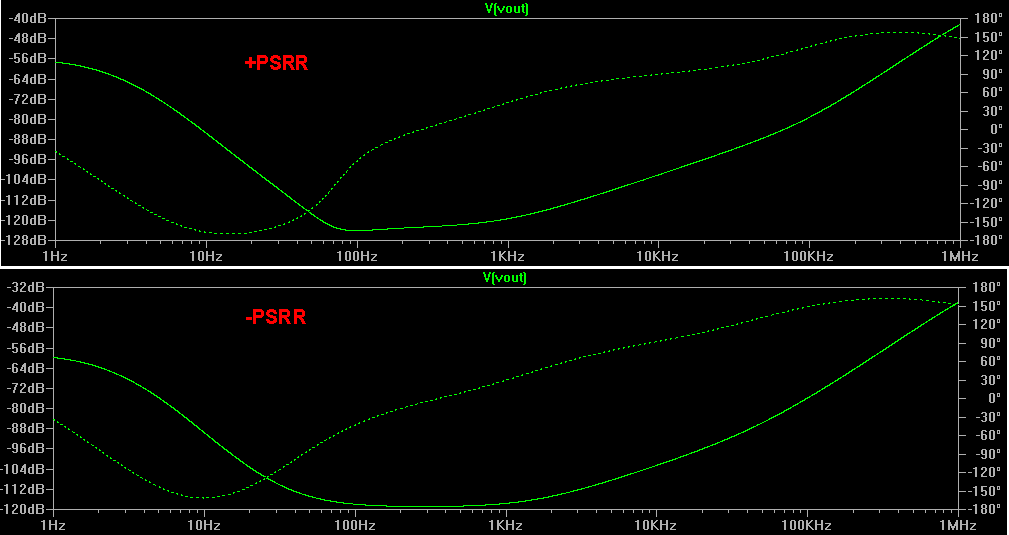

No real issue.
The CFA-Xh is "present" SOTA for a VSSA/CFA.
BUT ! BV has indeed brought a "deal breaker" to the table. LC ... eat your
heart out !! 😀
(below 1) the LF PSRR is 20+ DB better. -90db 20-200hz , only
going to -80 at 10hz and 20K.
BV changed the OPS filtering to the predriver only ... 470u + 68R. (he cheated).
On the present OPS , this can be done by increasing the value of the
1W resistors or increasing the driver/pre decoupling value.
Realistically (below 2) the main improvement (not to ignore the psrr 🙂 )
is the THD , some distortion common mode cancellation is definitely
happening. #2 on the schema (below 3) shows the compensation and
the blockers feeding a common 68R to ground.
#1 shows the lack of zener's ( ditch the zeners 😀 😎 ) , as well.
PS - those are the changes , Kindhorn.
So , we have 20db better PSRR and <15ppm THD @ 20K 120V levels.
All the other metrics ... slew / loop gain , stay at thier previously
impressive levels !! 😎
EDIT - All these factors would indeed be hard to achieve even with
the "better" spooky . 😱😱
EDIT 2 - I simmed with the 5-pair OPS + keentoken's modified models.
I previously simmed with BV's "cheat" for -110db PSRR - PSSR plot below is realistic
for the 5- pair present OPS.

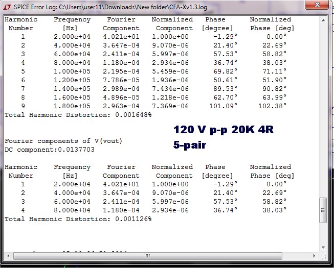

What happens when you sim it at 20kHz, 120V P-P into 4 Ohms? This is where I run most all my simulations at some point.
Bela
That IS ... 20K THD 120v p-p (above 2)

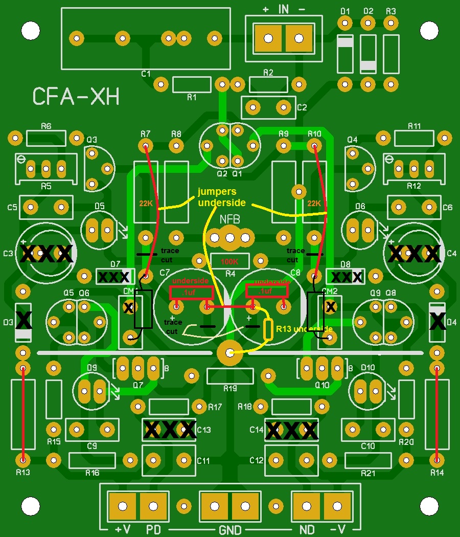

Have a look at these mods to the current CFA-XH boards. Some value changes aren't shown but the cuts and jumpers are.
Let me know if you see something I missed.
I'm not advocating that we follow this direction but since I have extra boards I want to try it. DIYA baby!
