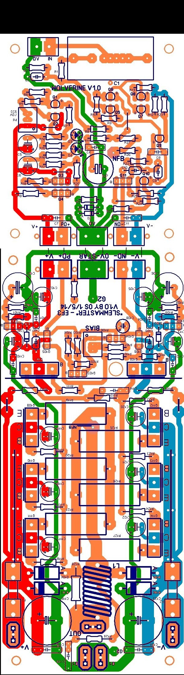

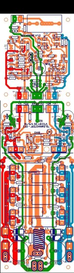

Here is the newest 3 -pair ... there is a typo (that orphan resistor) in that color
layout.
Schema/copper/screen - normal and reverse polarity to facilitate IPS facing
away or to OPS.
Also , once we build a fully functional OPS w/ no "bugs" and get a good IPS
to "sing" on it . The "sky is the limit" within the OPS's capability. 😎
PS - If you printed the "typo" , board is still fully electrically sound....
observe "typo" to make sure it does not bridge anything (it might not be there
on the copper file).
"New" is the same layout with "housekeeping" (same schema).
OS

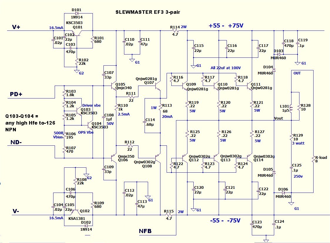

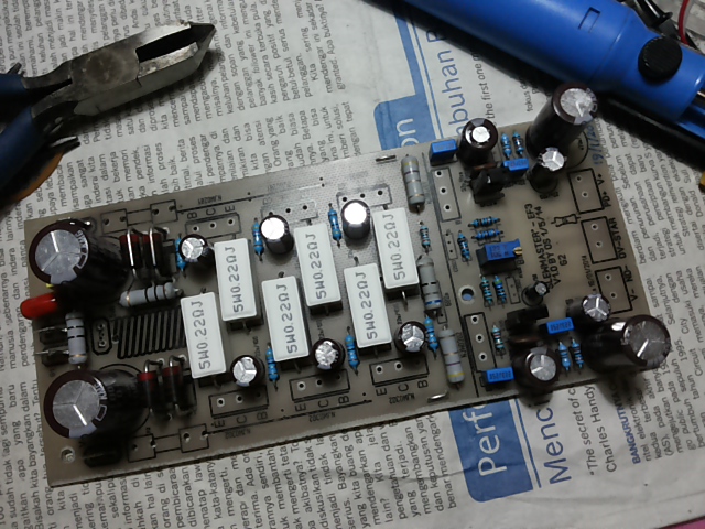

You read my mind uncle OS,...
so the R111 & R112 is 22 ohm 🙂
I thought it was jumpers.

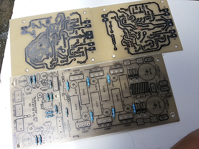

I made slimmer board for the OPS,
make it a bit different from yours because
the parts available here a bit different too.
Nice "industrial" looking OPS ! It looks like it means business ...
PS - you do have that "glitch" (the orphan resistor near the IPS euroterms)..
make sure its pad do not touch anything - you could "erase it".
OS

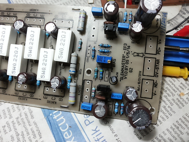

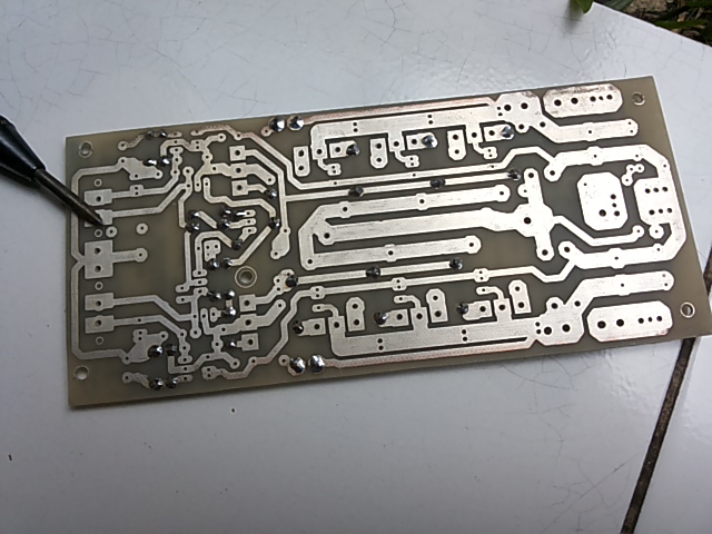

Thank you Uncle OS,
Here the bottom, orphan resistor clearly safe not touch any pad. So i don't have to install this resistor right?

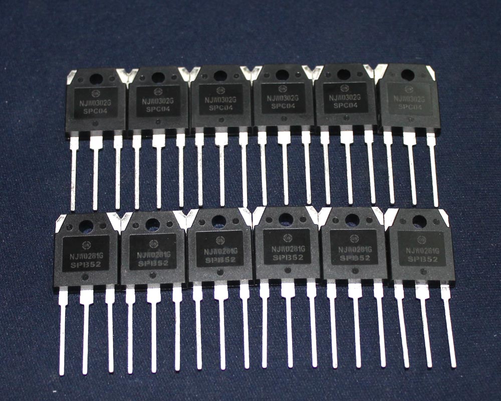

Hi, Naf where do you buy the output transistor? I have trouble to get them.
I have a couple i've bought one year ago... when i start to build my Badger Amp.
I'm still collecting the parts, here are the NJW
so it is rare now in our country 😀
I'm lucky that I also bought them last year
Can we changed the OPS transistor with the bigger package?
like the popular TO-264 or even TO-3, I have a lot MT-200 too 🙂 big fans of them
Thank you Uncle OS,
so that orphan resistor does't do anything, I thought it will be use for something special, hehe... 😀
keep your spirit mas Naf... your the lucky one to solder it first 🙂

When you get to placing the output transistors , the OPS can be tested
(in isolation) by putting 15K resistors between the (V+/PD+) and (V-/ND-)
euroterminal connections.
This will emulate a 4.5mA IPS hooked to the output stage. You can adjust
the "bias" to around 200R to see the 65-75ma at any of the .22R RE's.
You can also test the outputs of the cap multipliers. They should be rail -
about 2V... apiece.
Temporarily Heatsink whatever outputs you solder in. With a DMM, you will
also be able to see the main Vbe's thermal response to a lighter or other
heat source. The main Vbe is UNDERNEATH the PCB ... you screw it down
through the large hole near the drivers.
The "small Vbe" is attached to
the plate of aluminum/copper that the main drivers are thermally bonded to.
OS
You can also use the 5200/1943 pair .... any 30mhz Ft output pair. The
21193/94 will also work. MT-200 is just a tad too large. 🙁
