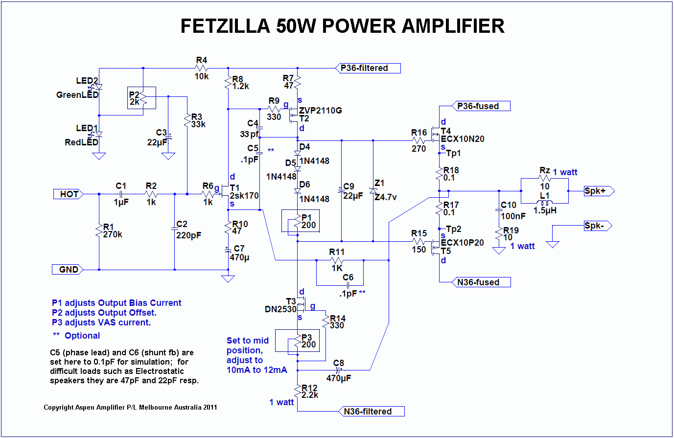

Wondering if the FetZilla can be used as IPS board
If you could get the drains of T2/3 to conduct 4.5 - 5+ ma ,they could drive
the "slew" OPS ... no issue. 🙂
OS

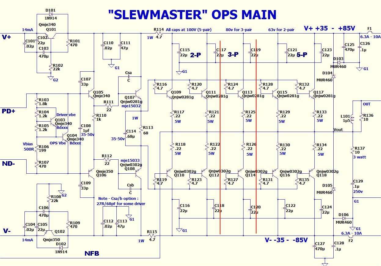

Terry,
I looking at the pics of your partial VSSA boards, do make sure the VAS heat sink material isn't touching any of the pads on the board. Just ensure there is clearance so nothing gets shorted, there doesn't appear to be any gap in the picture but that can be deceiving sometimes.
Hi Jason,
Yes I saw that. I repositioned the heatsink slightly so nothing can touch but I will likely wrap the bottom of the heatsink with kapton tape just for assurance.

Looking REAL hard at your photo's ... watch those optional R/C pads beneath
your "fat" driver heatsink. If they touch that heatsink (magic smoke") 😱
PS - I originally designed for a thin roof flashing type heatsink. The
oversized drivers are such overkill that they could run the output
section without a heatsink ... really.
(anal explanation) to-3P's have just a couple Celsius/W thermal
properties. At even a <4R load on the EF3 , their junctions would only heat up
<10C ... Most to-220's are 5-10 C/W , they might need small heatsinks.
OS

Hi OS,
Yes I see what you mean. What is the purpose of the CS-A & CS-B? Are there supposed to be caps there? I actually wanted the heatsink to rest on the pcb for support so I will cover those with Kapton tape. I didn't know how much heatsink you planned for those and I had some scrap diamond plate and thought it would pretty it up. 🙂 I like using the thick metal better than thin because I can tap it and not need a nut.
Is there a good way to to test these boards without having an ISP hooked up to it?
One more question. What is the reason for the jumpers at R114 and R115?
Thanks, Terry
CS-A and CS-B are for added optional compensation should it be needed. The drivers don't need much of a heat sink at all, just some thin sheet is all that is required to provide some thermal coupling. The jumpers allow a separate supply to feed the drivers, predrivers and the rest should someone want to use a boosted supply about 6-10V higher for that.
Putting two resistors in place, one from +V to PD and another from -V to ND will allow the OPS to be run at idle without an IPS. Use ohms law to determine the value of the Red based on the rail voltage and approximately 4.5mA of current. So for 70V about 15k would be suitable.
Thanks Jason,
I'll probably stick with the heatsinks I have since they are already done unless this is a problem. Does Q103 need to be attached to that heatsink?
To be clear, I would jump V+ to PD with a 15K resistor and the same with V- to ND and then feed V+ and V- with +-70V? Will this allow me to set the bias?
Thanks, Terry
Thanks, Terry
I don't have my materials handy to reference but if that is the TO-126 right beside one of the drivers, then yes it is to be attached to the heatsink.
You are correct about the resistors (the 15k for testing with no IPS installed). I would dial the bias to the desired level with the boards on the heatsink and let it idle for a while. When installing an IPS I would dial the bias down just to ensure it doesn't change should the VAS current not be quite the same as provided by the resistors.

One more question. I have a couple different schematics for the OPS. One uses MJE340/350 for all the small transistors and the other uses KSC1381/KSA3503 for some and MJE340/450 the pre-drivers. Any advantage/disadvantage with using the MJE340/350 for all of them?
Should be fine with the MJE devices. The capacitance multiplier might benefit from higher gain devices but should be fine as is. I have KSA1220A / KSC2690A in mine as both pre-driver and cap multiplier, seems fine with those so far.

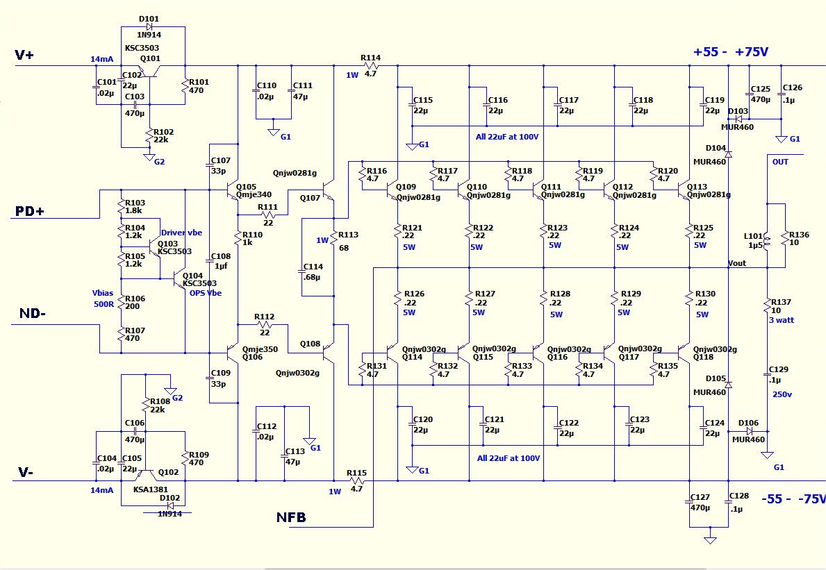

Jason and OS,
Since I don't have any of the devices for any of the positions, besides 1% 1/4 watt resistors laying around and have to order all the parts are there any preferred devices that I can go by when I order from Mouser or DigiKey or whomever has the parts? I see so many different transistor numbers and types I don't have a clue which ones to order, just to grab a number out of the soup seems counter intuitive to me. Can someone post a bom with preferred devices so I can order them and preferably something that would be available later so I can stay with the same devices down the road? I see all the MJE and KSA and other devices and just don't know what to go by. I have no experience with picking devices and so would love some guidance here, from lets say best to not worst but perhaps less desirable or hard to find. I surely don't want to hunt down nos parts, that isn't something I think I want to get into. I see enough about phoney devices and Ebay sales and would rather deal with a legitimate supplier of parts.
Thanks,
Steven
Thanks,
Steven
Unless OS puts somethin up first I'll suggest some devices later. I don't have full access to resources at the moment but there will be no NOS, just common, available and reasonably priced parts. No worries, it won't be a full BOM but rather some suggestions.

What ... no LED's 😱 . Of course we have leds !
ALL the "CFA-X -H" parts can be "junk box" (as long as they are proper
voltage and Ic).
The bom will be stupid simple -
1. ALL to-92's = KSA992/KSC1845
2. The VAS cascode TO-126's = KSA1381/KSC3503 "E" grade.
LED's = 2 plain red + 2 UV/blue (or even green)
The electro's will be 2- 1000u @10-16V + 2 100u 25-35v.
12V Zeners , trimmers , 914 diodes ... all standard fare.
All the resistors are non-critical besides the 2-3w current FB ones.
You could fit the schema/bom on a single index card 😎 .
Now to elaborate on the led's ... why not plain diodes ?
LED's seem to have just the right negative Vf /temp. to cancel
both the IP pair and Hawksford Vbe's .... they look good , will
confirm that your VAS/CCS's are operational ... and they are cheap.
I'm running them at 1/10th ( If) , 1.5ma red - 2.7ma blue/uv... they
will last 250K hours MTBF.
