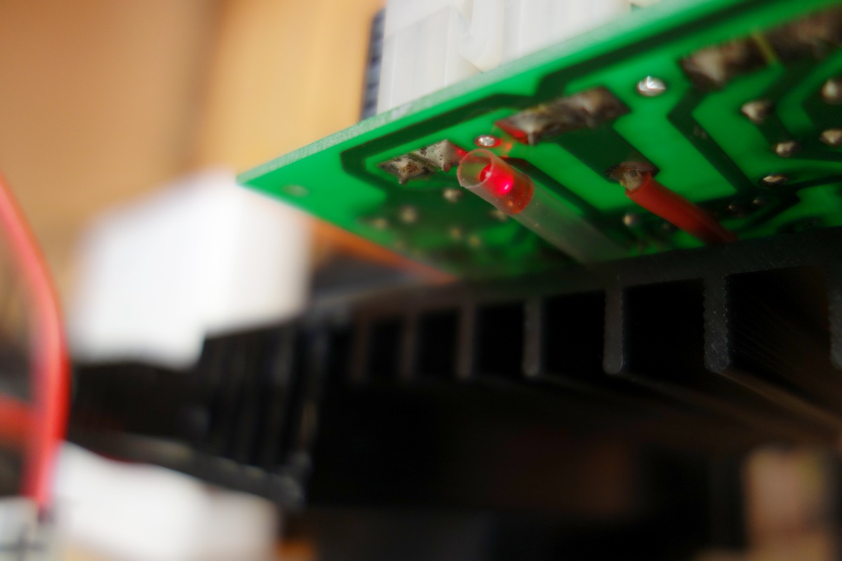

I thought I would just drill a small hole next to the emitter pad and feed the anode lead through that and solder to the emitter wire, and then solder the cathode directly into emitter pad. Should be easy. I like the idea of using an LED if it works.
I have mounted the LED underneath the PCB but slightly away from the heatsink, using the full length of its pins and protecting them with a plastic pipe...

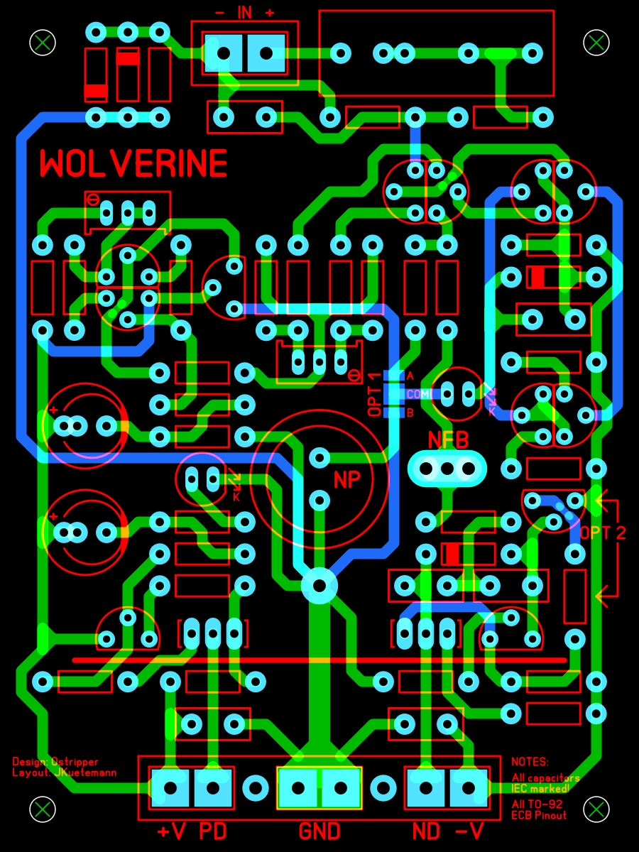

Wolverine nearing completion
Here is where Wolverine stands. Component designators still need to be applied.
No one ever answered the query about Q10 on OS's Wolverine schematic. He had that as a TO-126 on the heat sink with Q11 and Q13 but I didn't think that was required since changing Q10's temperature will change the CCS current, but Q10 on its own dissipates almost nothing. I laid out using a TO-92 device for Q10. Anyone see an issue with that?
I didn't know if it was necessary either but since he went to the trouble of putting it there I bolted them to the heatsink. As a matter of fact since he placed Q12 next to the heatsink I assumed it needed to touch also so I put dab of glue on it and stuck it to the heatsink as well. I'm not sure if any of that was necessary but it plays fine.

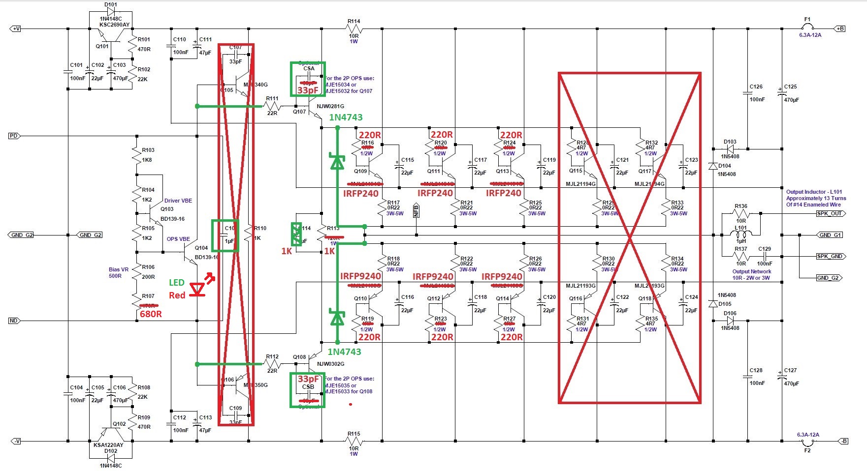

Look at it this way. A transistors base-emitter voltage has a temperature coefficient of about -2.2mV/˚C, which means for every 1˚C the transistor increases in temperature it takes 2.2mV less voltage to forward bias the transistor junction.
Lets consider a simple VBE multiplier for illustration, rather than the compound one we are actually using (in simplistic terms, don't jump on me for lacking some technical details):
We use a VBE multiplier because we need to forward bias all the junctions in the OPS, for a total of six. So we set the VBE multiplier to multiply its base emitter voltage drop six times. This gives us the required voltage to forward bias the whole OPS of about 3.6V. This also multiplies the VBE multiplier's temperature coefficient by the same factor, so the temperature coefficient of the VBE multiplier becomes -13.2mV/˚C. If we are able to assume the transistors operate at the same temperature then the whole thing is stabilized against temperature changes.
Now consider the MOSFET option:
We are still using the VBE multiplier to provide the bias we need. We now have two BJT base-emitter junctions to forward bias and we have two gate-source bias voltages to supply. The total bias voltage we need to generate is on the order of ~8.4V (a little less that 'theory' would suggest). So we have to set our VBE multiplier up to provide something more like a multiplication factor of 14. the multiplier's temperature coefficient then becomes -30.8mV/˚C. However, the MOSFETs have a temperature coefficient of about -6mV/˚C, so the total temperature coefficient of the OPS is more like -16.4mV/˚C. This means we have a grossly overcompensated OPS. For every 1˚C rise in temperature the bias fall almost twice as much as it should to properly compensate. We need about half of the VBE multiplier to respond to temperature and the other half to not respond.
The solution:
When we insert the diode (or red LED) into the emitter leg of the VBE multiplier we are increasing the total voltage drop we are multiplying. More importantly only the transistor is thermally responsive, the diode is relatively isolated from temperature changes, so we get about half the regular VBE multiplier temperature coefficient. Happy days.

I'm going to go with the LED mounted on top and drilling the small hole to feed the one leg through. I like the idea of being able to see it and it will be better shielded from the heatsink.

I received my MOSFETs today. I sat down to start populating and realized I had not ordered anything for the base stoppers. So I have a couple of questions.
1) How important is it that the base stoppers are 1/2W? Do they see that much current?
2) How critical is the 220R value? I have 150R and 270R 1/2w in the bin, just no 220R.
Thanks, Terry
Thanks, Terry
I would go for 270 ohm, but in reality almost anything from 100 ohm to 470 ohm will likely work. A slightly higher value will err on the side of caution.
