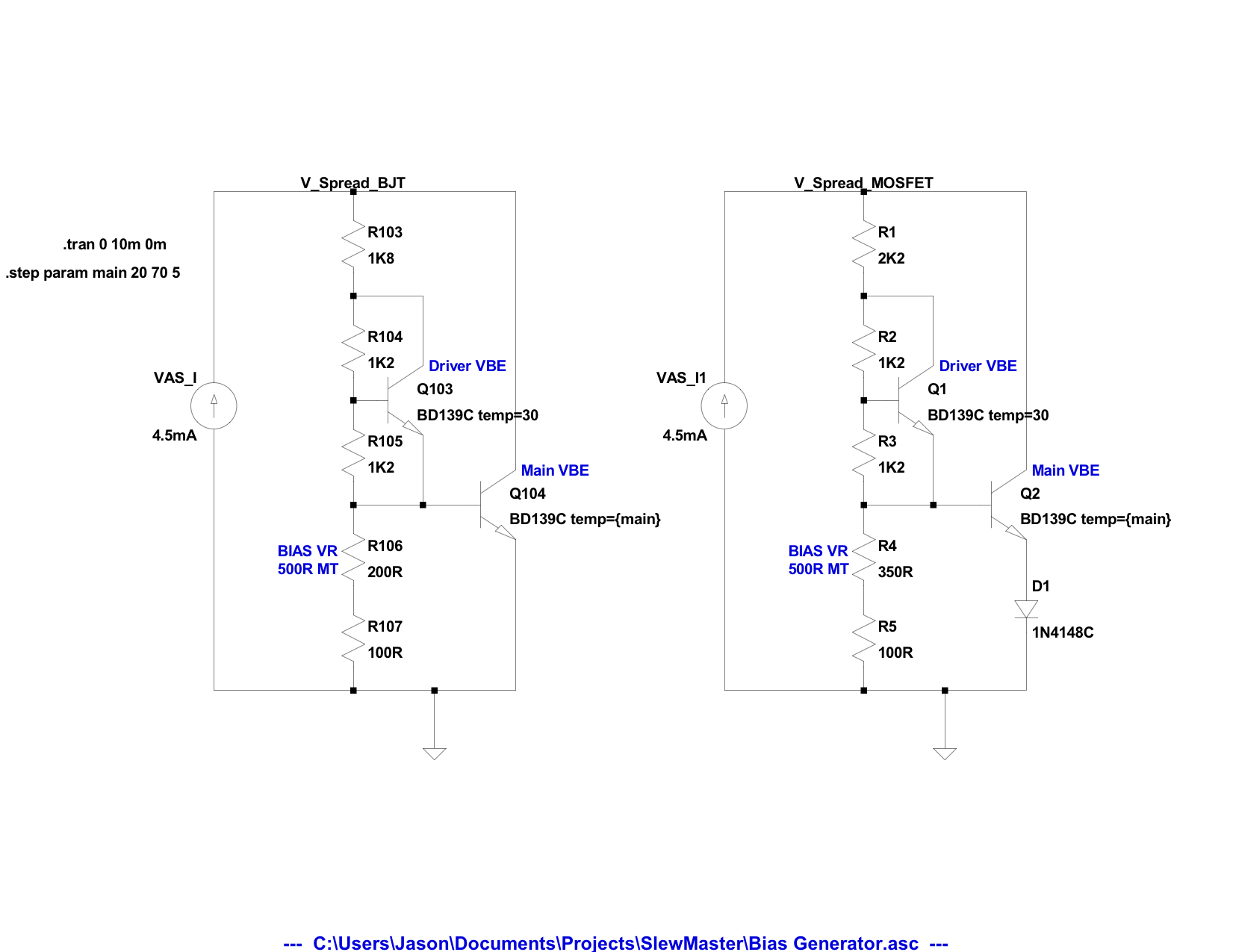

Clearly I need to tweak the thermal compensation temperature coefficient to better control the OPS bias, but overcompensated is at least erring on the safe side.[/SIZE]

Would the bias circuit perform better if Q104 wasn't mounted on the heat sink? Don't mosfets react opposite to BJTs with heat?

Laterals - yes, react opposite, but HEX-FETs - no. Still require the thermal feedback.
I started mounting Q104 on top of one of the outputs. At least on the BJT model it settles much faster and seems to stay more solid. Not sure if that will be the case with the MOSFETs.
In general, I think, the effect will be the same. This approach reduces the time constant of the thermal loop, making the loop faster.

For the Hexfets (vertical MOS) we still need thermal compensation. The issue is the BJT spreader we use to get the bias voltage has a temperature coefficient of about 26mV/°C where we would prefer something closer to 13mV/˚C (maybe a little higher, but not too high). I'm thinking inserting a non-thermally coupled diode into the emitter leg of the main OPS VBE transistor and adjusting the balance between the driver VBE and the OPS VBE just might be the ticket to thermal compensation bliss. I may elect to try Terry's piggy-back technique to make the response faster too.
According to Mr. Cordell's book, IRFP240 has –6 mV/°C at 150 mA drain current. Using EF add this coefficient become -8,2 mV/°C. Q103 will compensate the EF. The ratio VBE to VGS around -14 mV/°C, and we need –6 mV/°C. The bias current will over compensated.
May be RED LED with 2V forward voltage suitable for this purpose.

I added a 1N4148 diode in series with the main VBE transistor emitter and mounted that device onto the nearest output MOSFET by flying it on twisted wires. The bias current is much more stable now, only just a little overcompensated and that may be the result of my attaching the diode too close to the VBE transistor. At least the bias is not dropping by almost half but rather much less change now.

R103 and R107 are 100Ω and 2.2kΩ respectively, but this is quite overcompensated. Running on +/-45V rails the OPS bias starts off at 170mA per pair and takes 30 minutes to settle to 90mA per pair on my smallish heat sink that reaches a terminal temperature of 41°C (a 16°C rise over ambient). The small driver heat sink operates at about 30°C. Clearly I need to tweak the thermal compensation temperature coefficient to better control the OPS bias, but overcompensated is at least erring on the safe side.
Tried red LED at the emitter of Q104 (as Bimo suggested). R107 = 680R. Sensitivity is much closer to the right one. On cold power-on quiescent current starts at around 85mA and settles at 60mA in a few minutes.

Can you show that on the schematic so we can see what you are doing?
Thanks, Terry
My values are a little different since I used a regular diode, but this is the gist of the change. The diode is NOT thermally coupled to anything.

I left R107 at 100R and I used R103 as a 2K2. My diode is soldered in place of the emitter lead, with the wires attached as if the transistor lead wasn't trimmed. This may be too close to the source of heat, I suggest finding a way of inserting it so it is not being heated as much. Maybe bring the wires through the screw hole and placing the diode on the top side of the board.
At least with the standard VBE arrangement with R107 at 100R it is strongly overcompensated and would have no chance of running away.
I thought I would just drill a small hole next to the emitter pad and feed the anode lead through that and solder to the emitter wire, and then solder the cathode directly into emitter pad. Should be easy. I like the idea of using an LED if it works.
