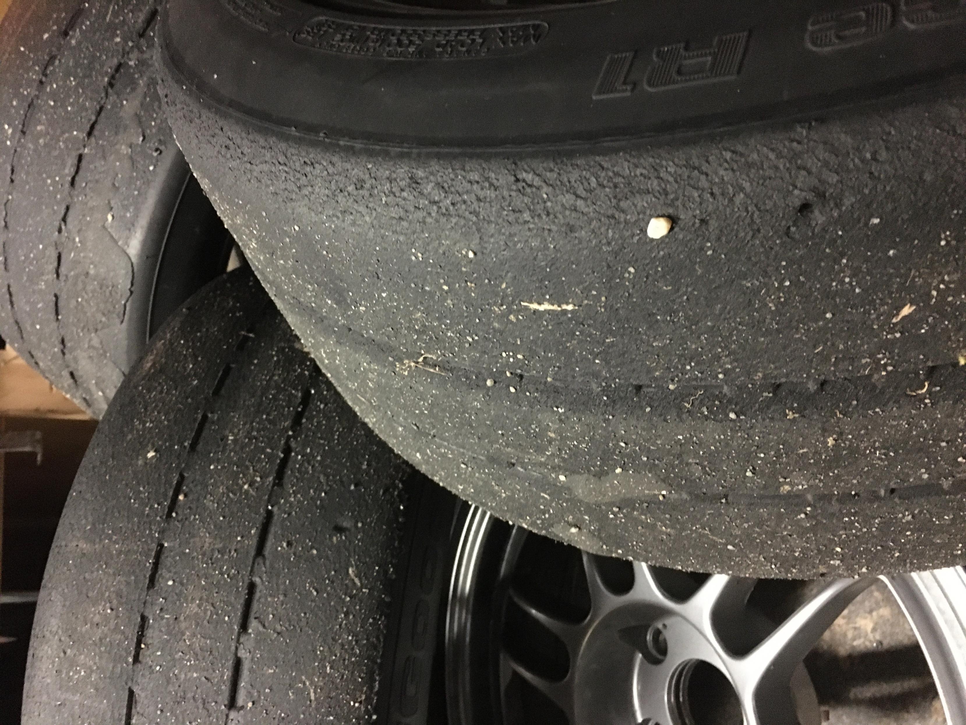

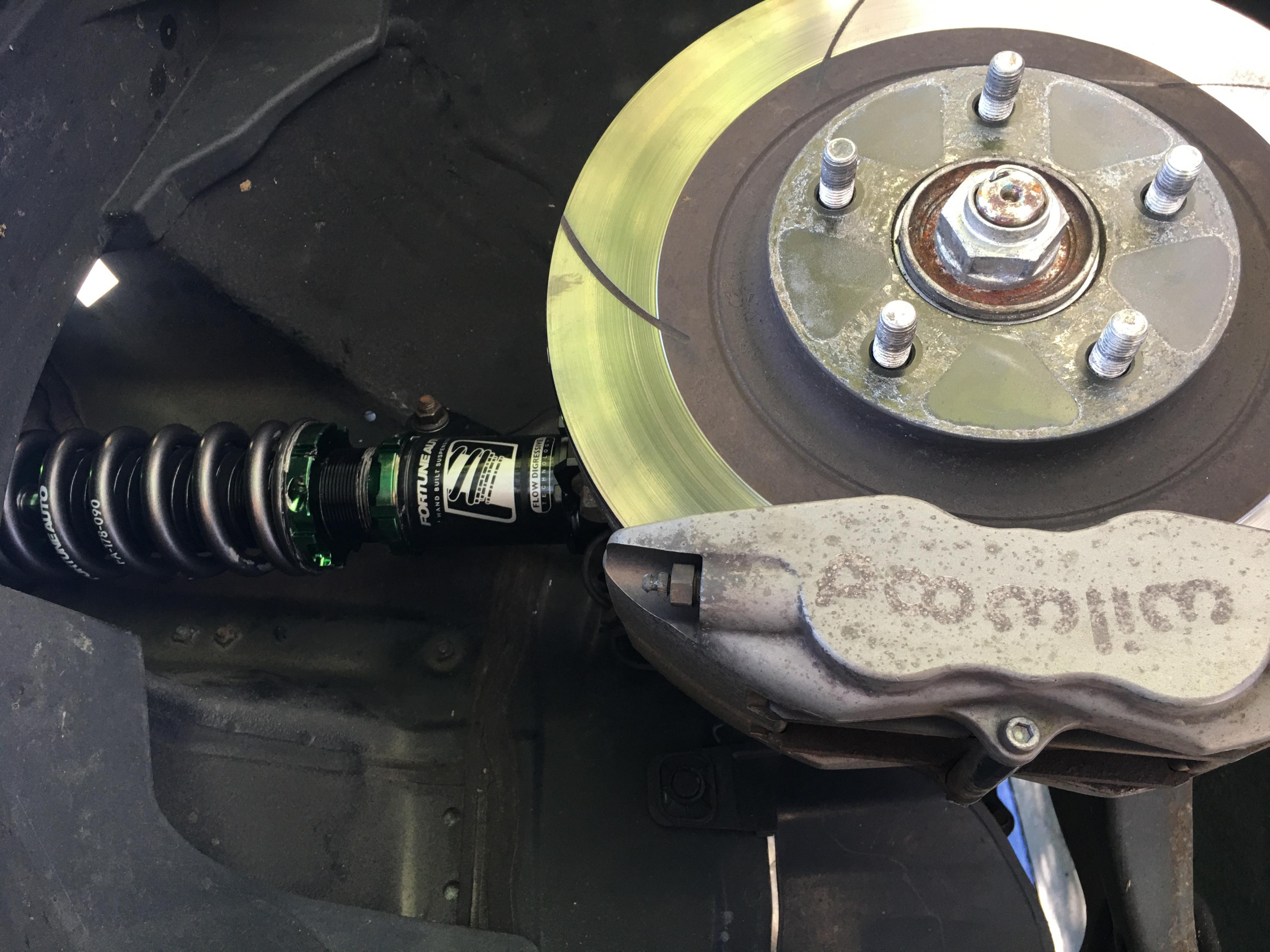

I have gotten out for a few track days but only for fun. It is eye opening to people when my civic with minimal work (big brakes stiff springs and soft tires) is faster than new corvettes.
I always found the Corvettes to be too heavy in the rear for tight cornering. Your vintage of Civic worked great. The new SI's aren't as good, they push terribly.
My car is very stiff in the rear. Big sway bar and 12 kg/mm springs. That plus some willingness to trail brake and really pitch the car in makes for a very balanced and fast package.

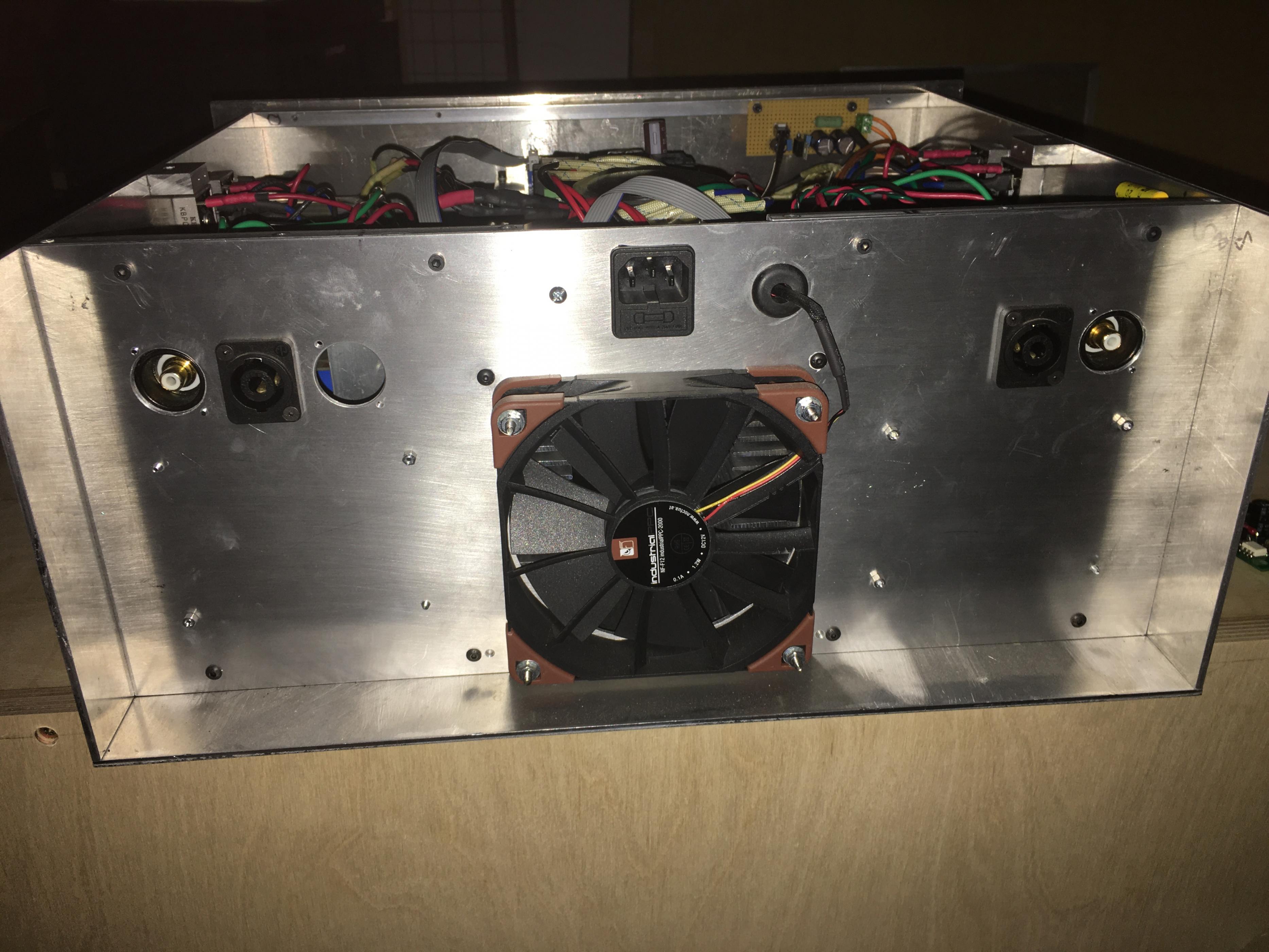

Are you going to install a fan between the heatsinks?
Yes. There is a fan in the rear of the enclosure between the heat sinks. Running on 5 volts it’s silent and keeps everything cool.

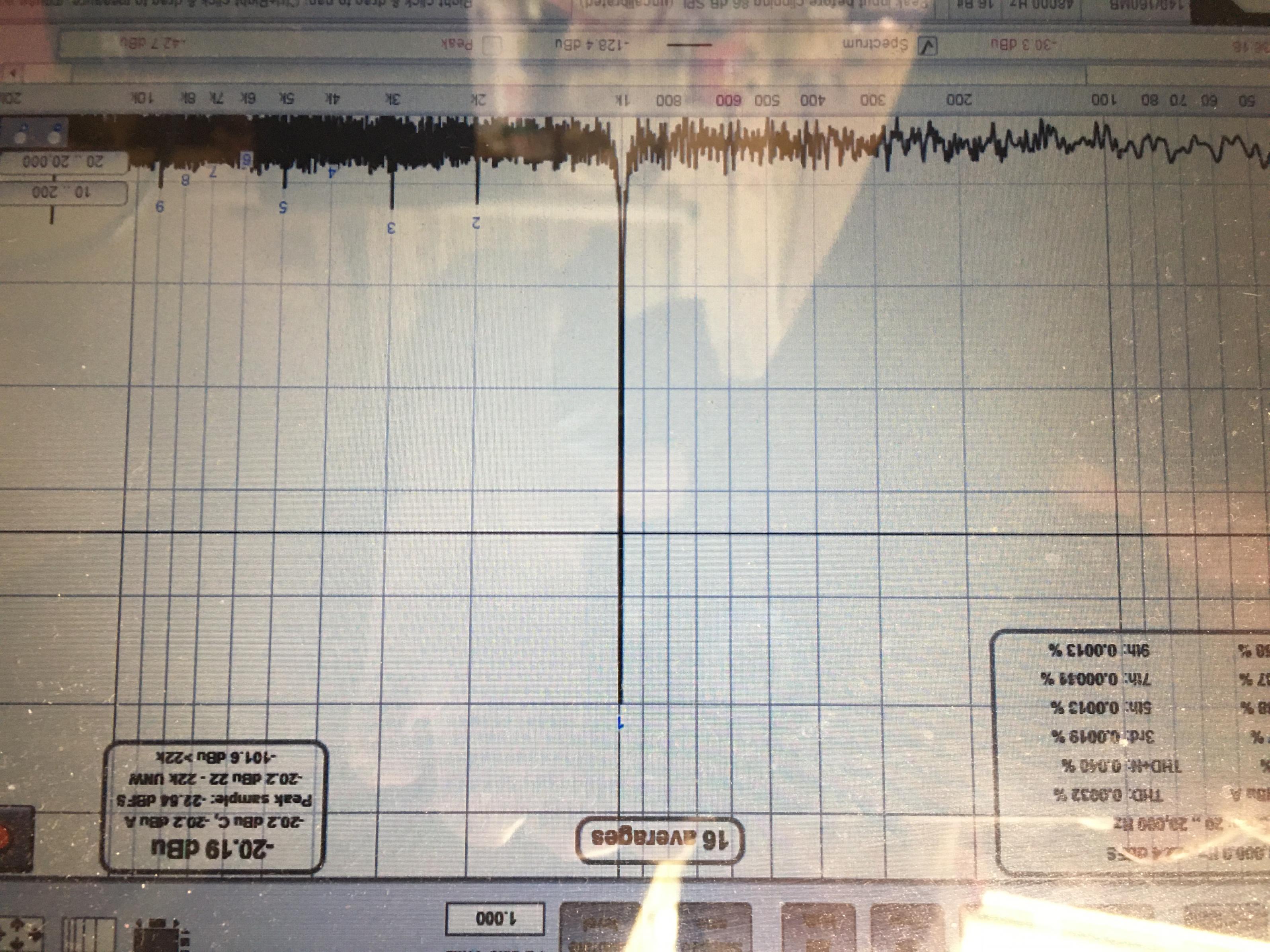

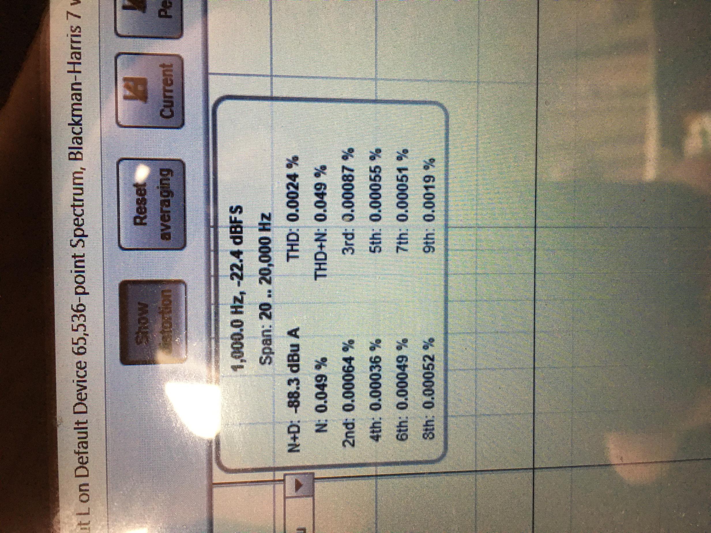

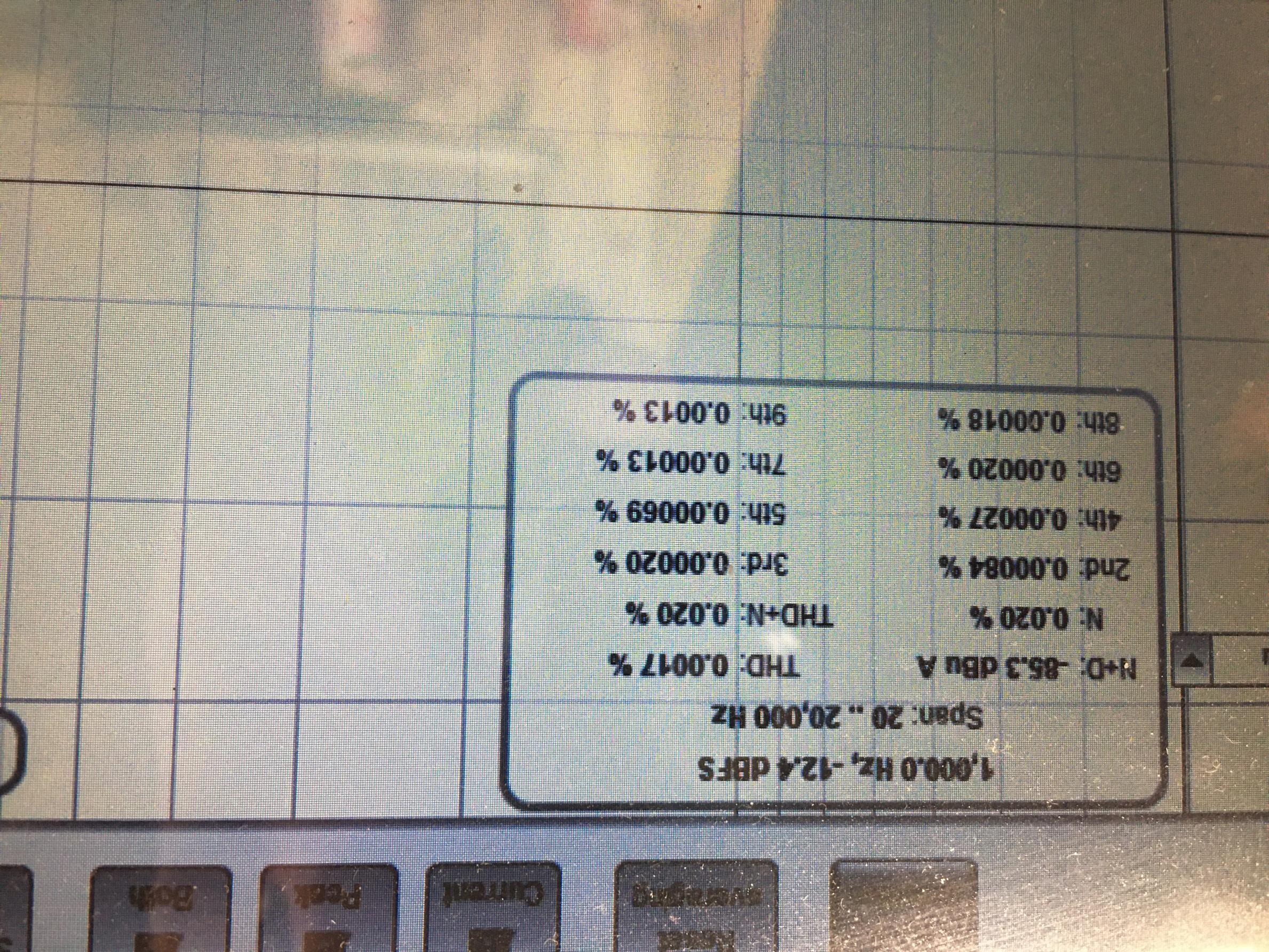

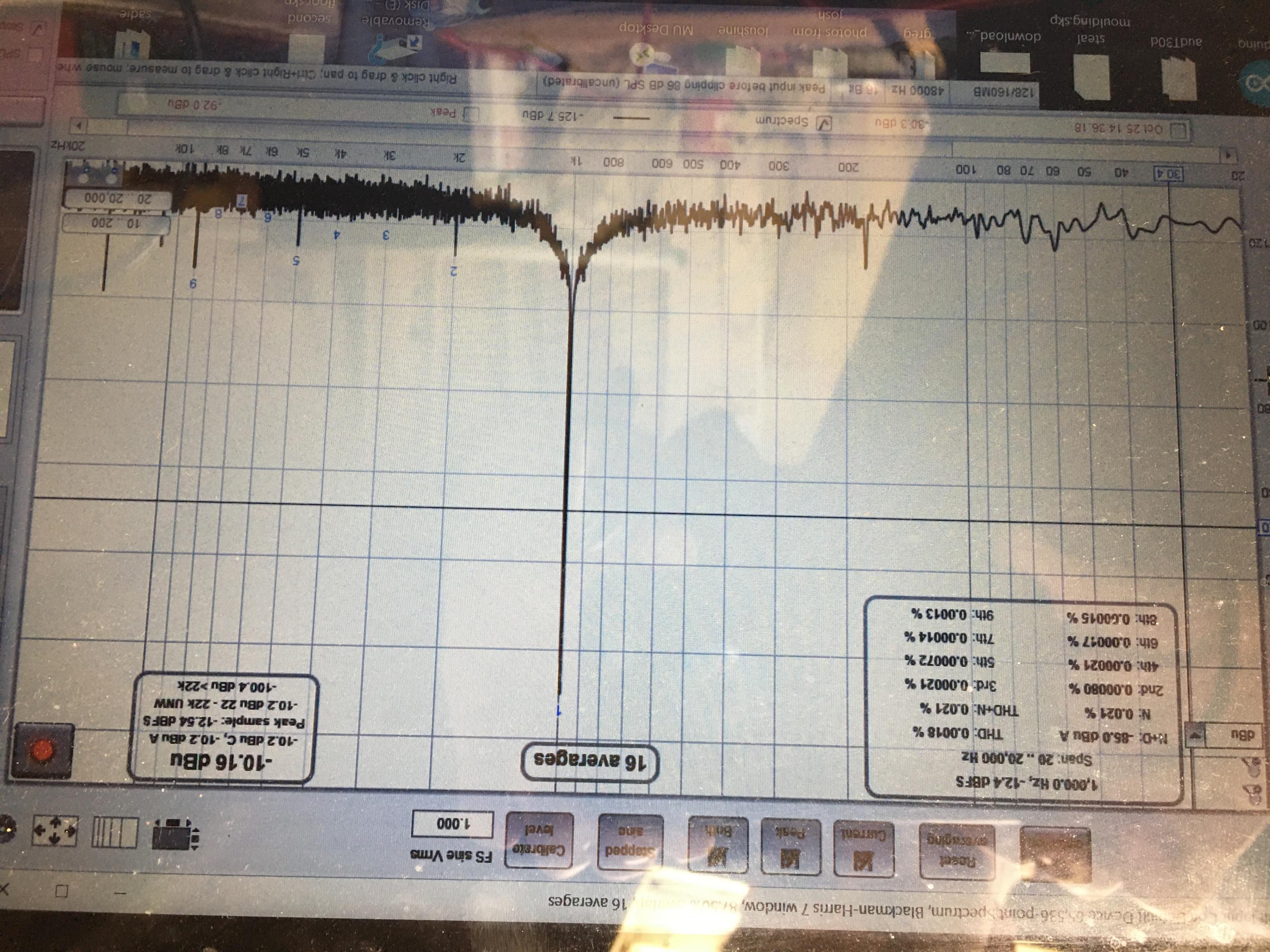

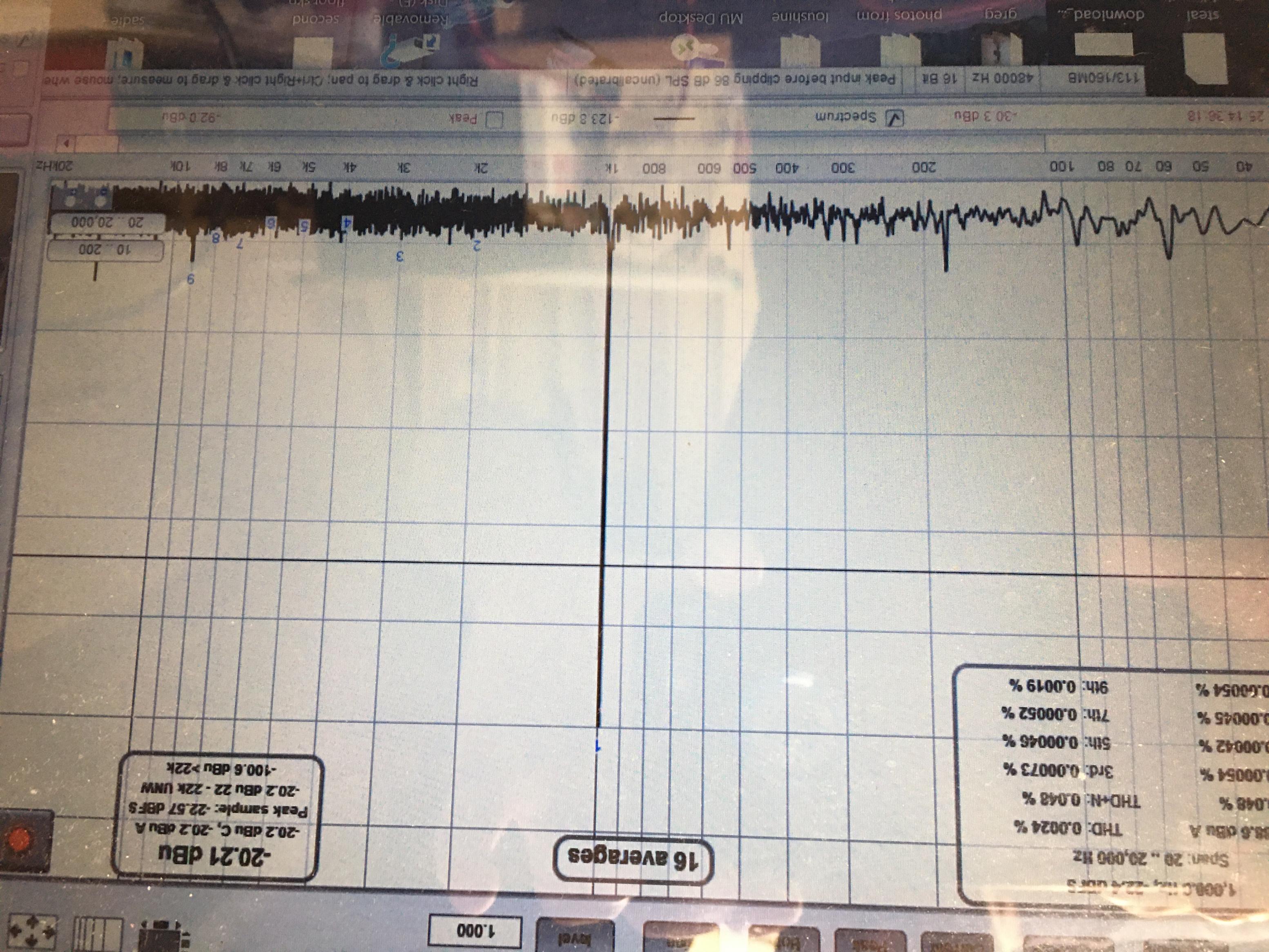

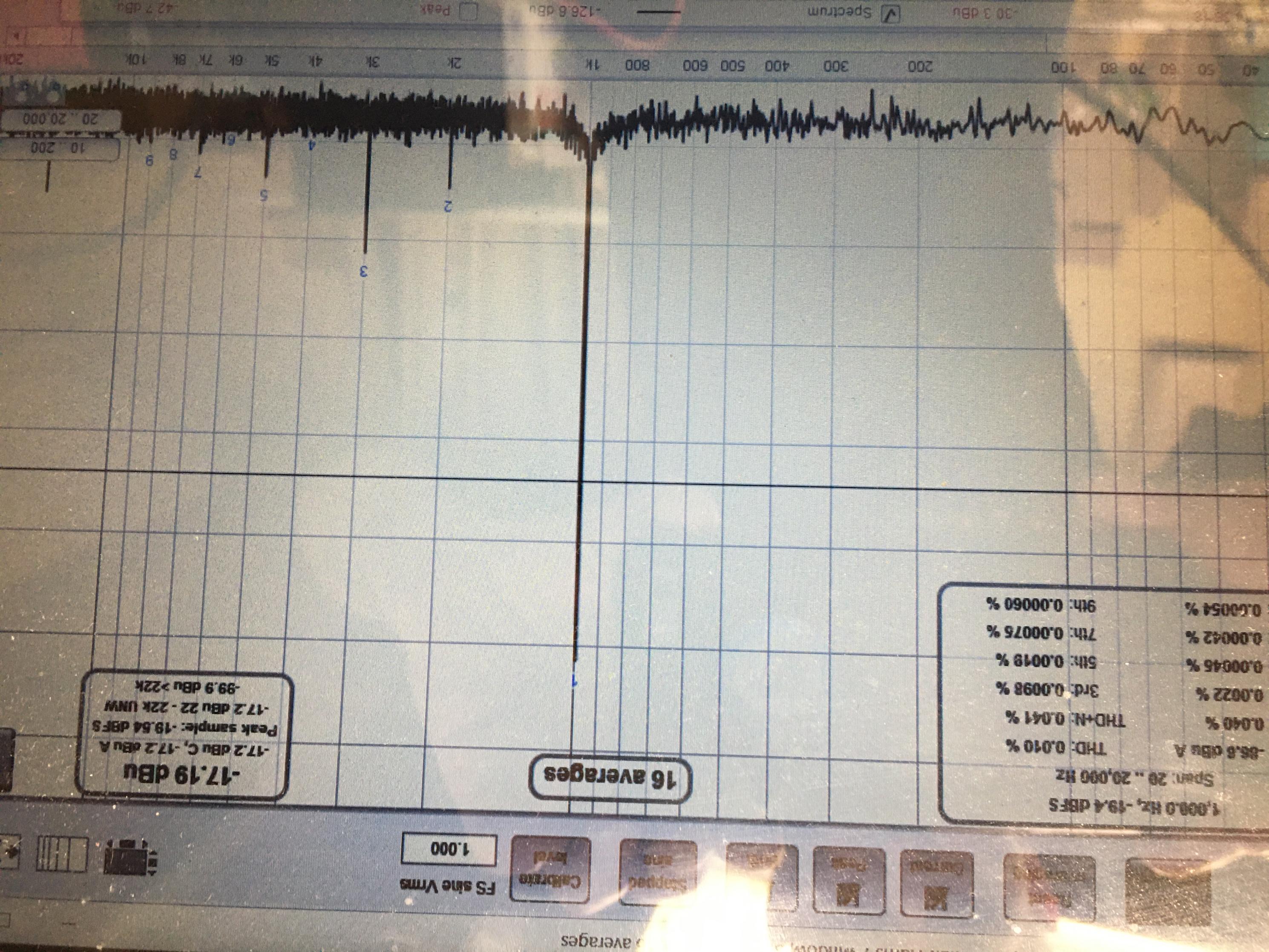

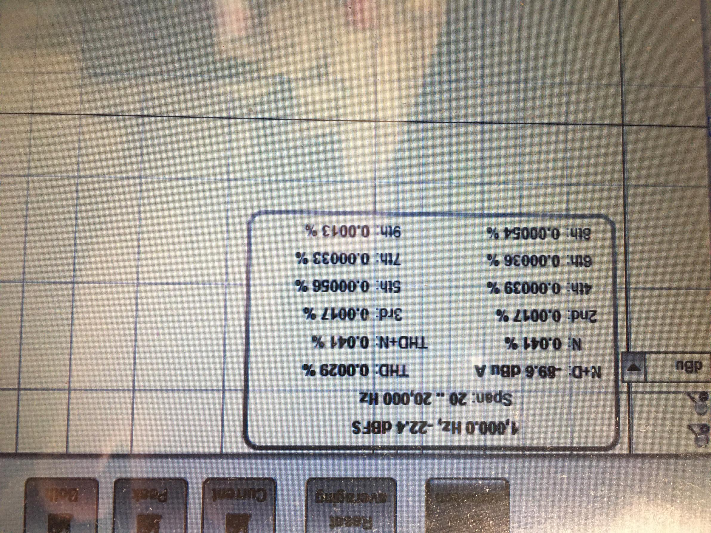

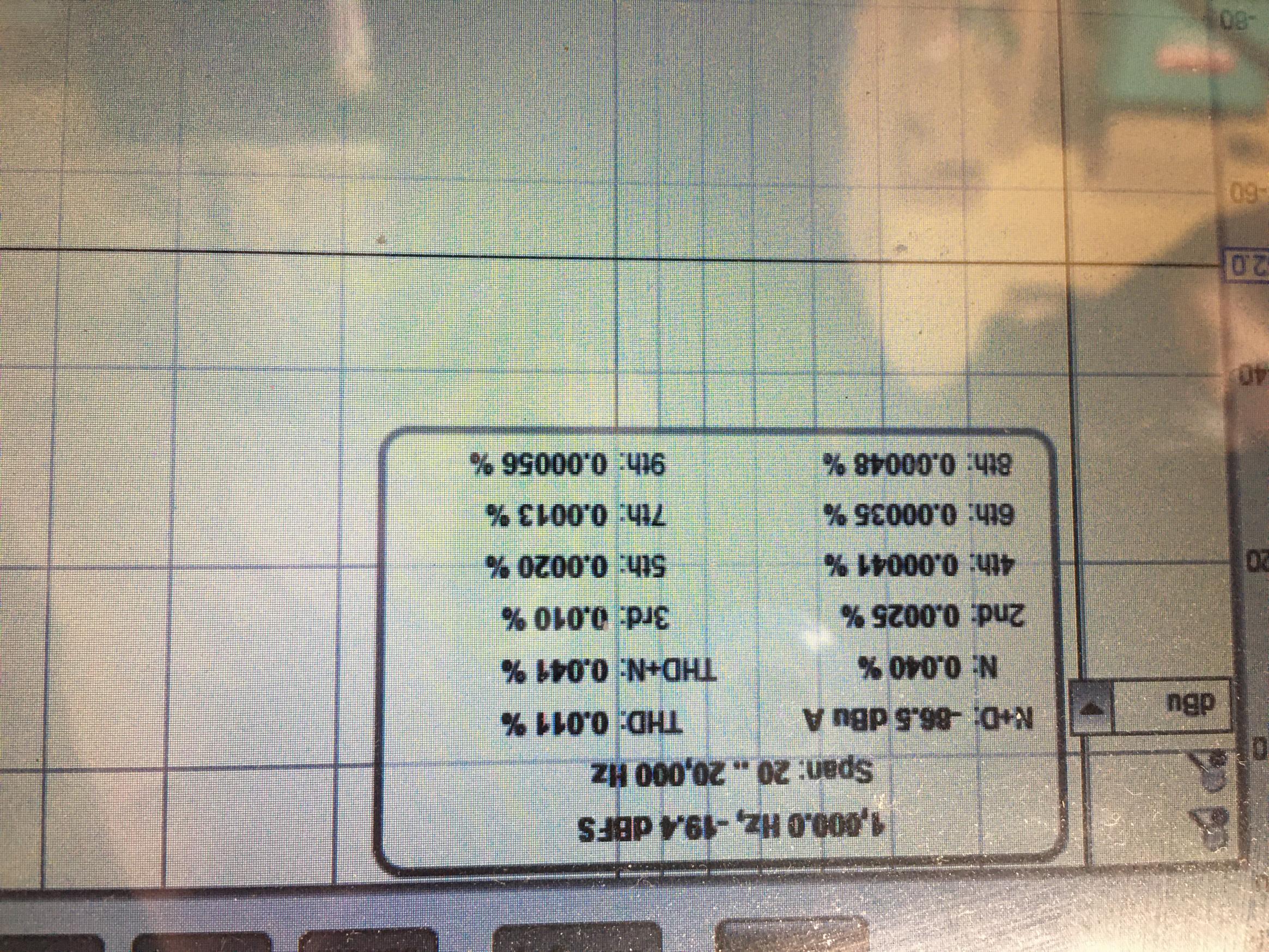

Distortion 1,10,100,200 watts. Stopped at 200 watts... the dummy load was getting awfully hot. Sorry for the crappy pictures of the computer.
