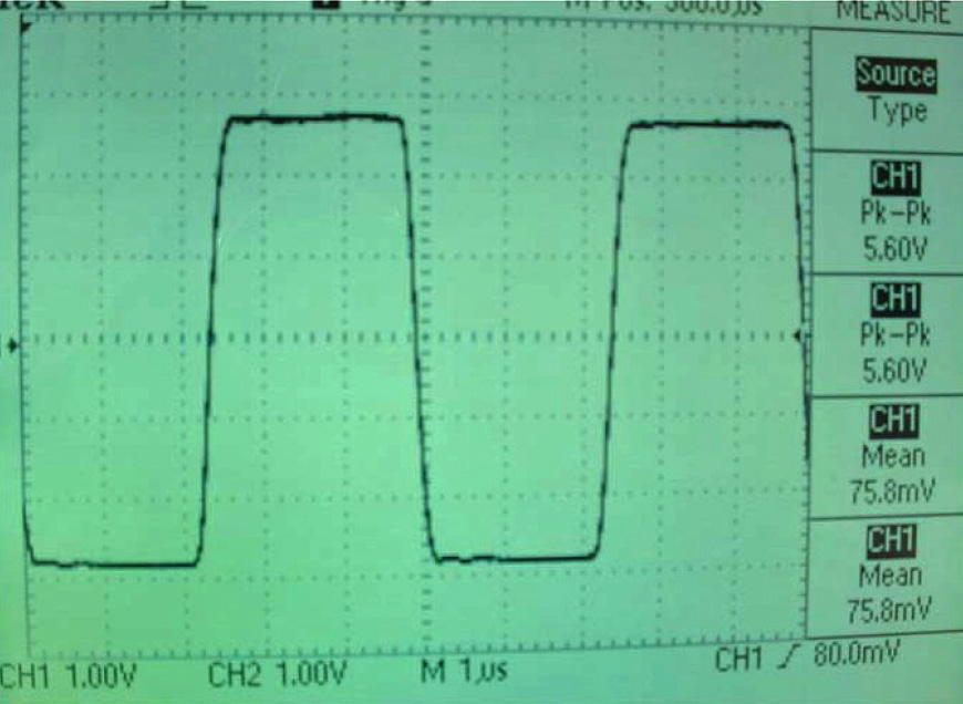

Nelson Pass likes to show scope photos of his amplifiers driving a 200 kHz square wave at 1 watt into 8 ohms. Here is one example, from the AudioExpress article about his F5 amplifier. Eyeballing the graticule divisions I'd call it 5.6V / 0.25usec = 22.4 volts/usec. Supply rail on the F5 is 21-22 volts so he's getting 1V/usec/volt.

You cannot read slew rate from an output with small swing like 5.6V. In a linear system, rise time is always same regardless amplitude. This would give you slew rate dependent on amplitude, which is a nonsense. You need to push the amplifier to slew rate limited region, when the output rises at almost constant slope. For this, you usually need to disconnect input RC filter, that limits the input BW. And/or you need to rise the output amplitude to such value when the output starts to "slew", i.e. rises with constant slope. From the NP's image it is impossible to tell the slew rate.

Slew Rate is not amplitude dependent - by definition, as slew rate is the maximum rate of change the system is able to deliver - while rise time is, as it is usually measure in the non-slewing condition.
So if the amplifier in Mark Johnson´s example is already slewing then his estimate gives roughly the slew rate, if it´s not slewing then his estimate is roughly the lower bound. 🙂

From Mark Johnson's example one cannot tell if the amplifier is slewing or not.
I did not mean the opposite. For RC lowpass the rise time is always 2.2*RC, regardless the unit step amplitude. There is no "slew rate" there.
For amplifier or opamp, one usually needs to have certain amplitude to see slewing. Below that step amplitude it acts like a linear circuit.

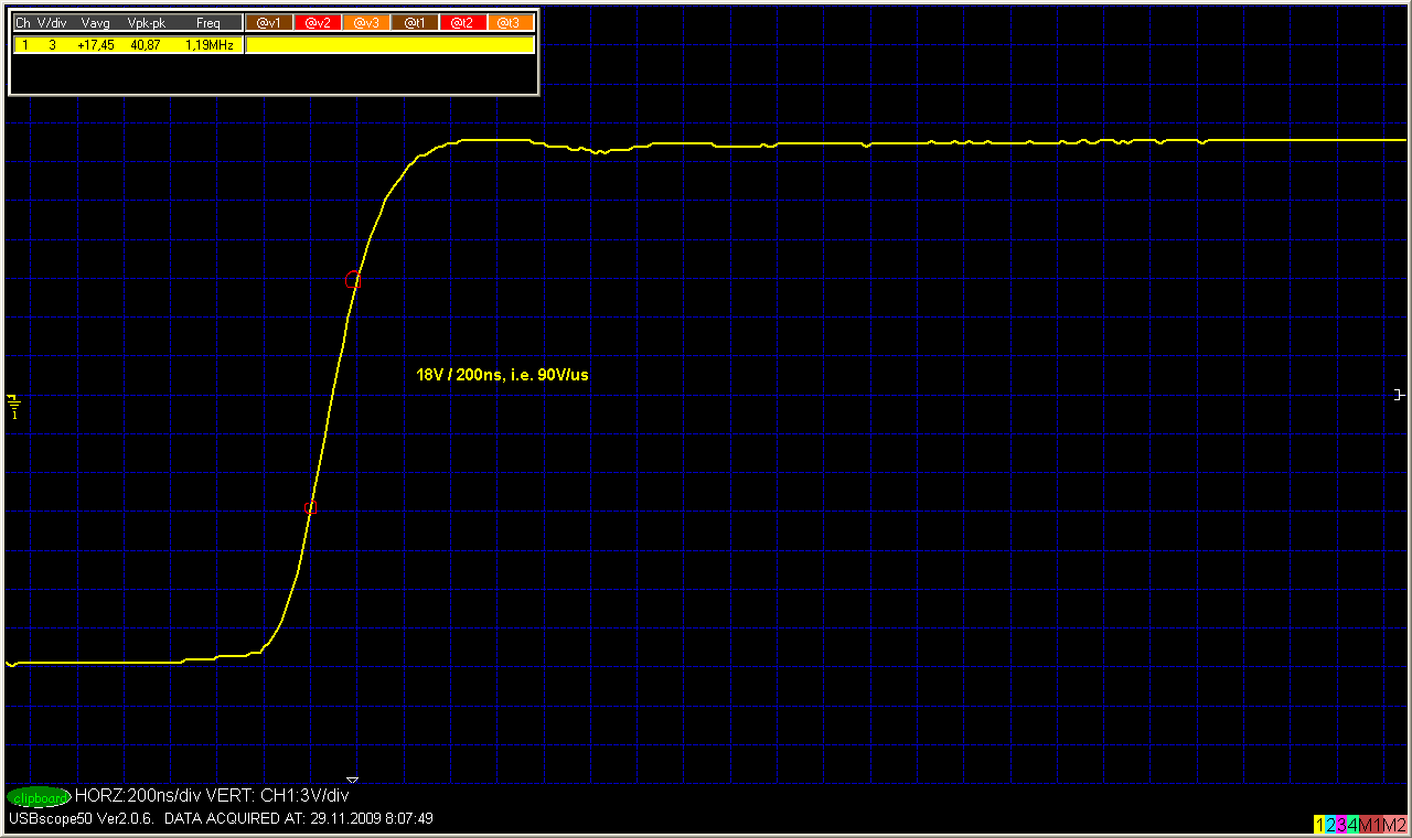

I mentioned that the rise time (of the step response rising edge) does not depend on amplitude for a linear circuit like RC low pass filter. Of course not speaking about non-linear circuit like an amplifier.
And it is a fact! For RC low pass, Vout = Vo*(1 - exp(t/RC)), Vo amplitude of the step.
Tr(10% - 90%) does not depend on amplitude of the input step! Always Tr = 2.2*RC, you may calculate it, just use the equation above.
Maybe we have some kind of misunderstanding, but I am not going to step aside this fact.

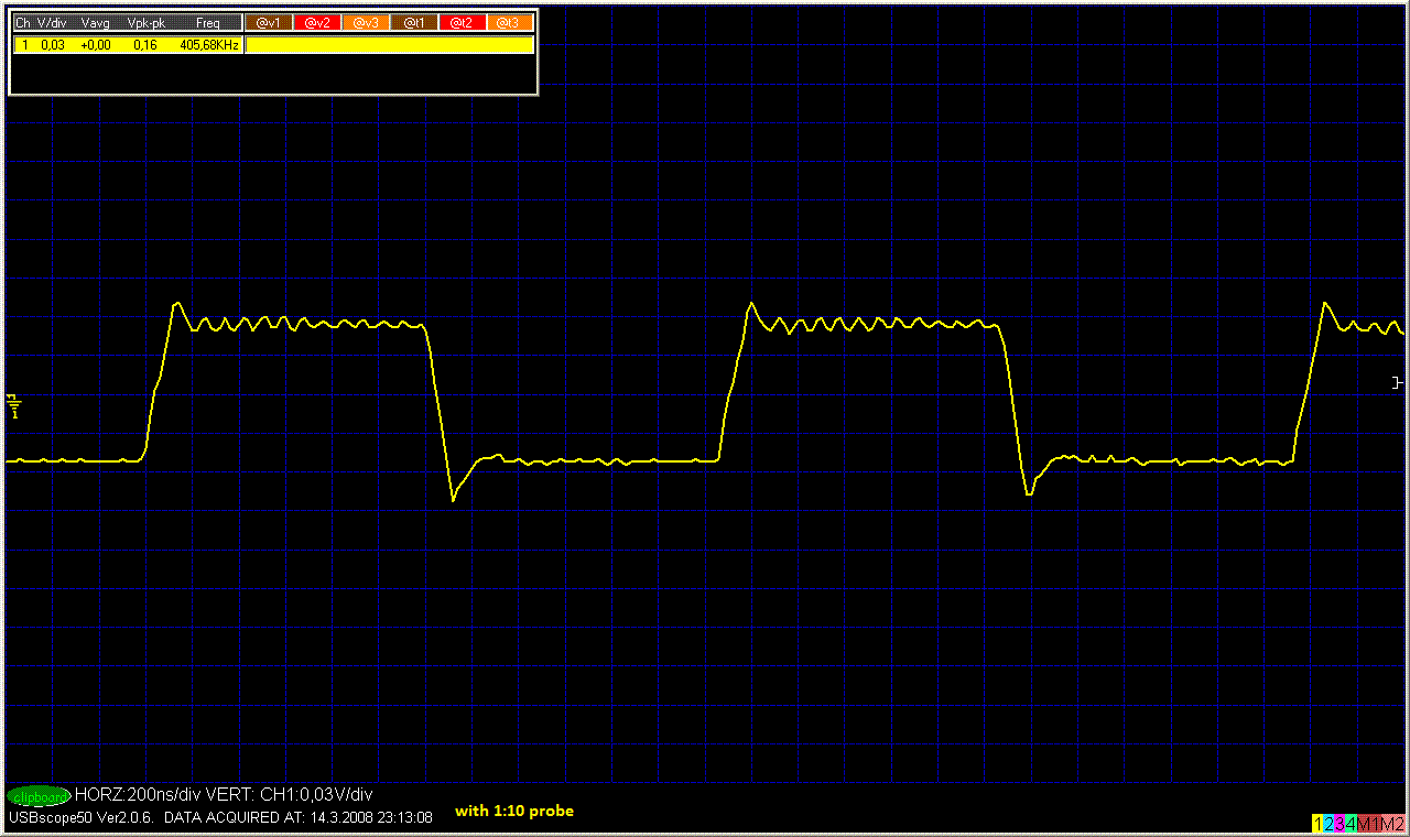

And that is where you will find and read the slew rate. For smaller step amplitude, you will see dual exponential-like response, resembling the linear circuit, 2RC.
