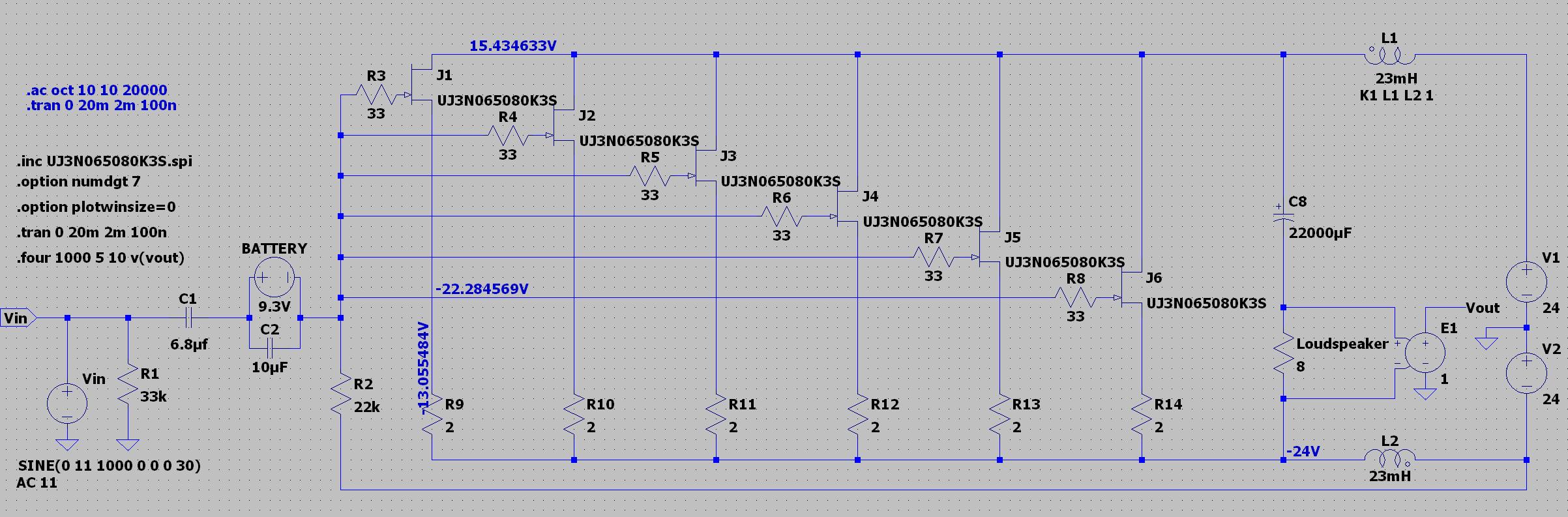

Apart from comparing the SQ, there are also the thermal runaway trait of the MOSFETs to consider.
I often see that MOSFETs legs "steal" the current after several minutes and thus gets very hot. I fear that they will break down with time.
The JFET amplifier stabilizes within a couple minutes.
It is also easier to match the JFETs at the correct Is.

You have to connect R2 to the junction between C1 and C2 plus battery.
You want to use the battery to set the DC voltage at the gates of the JFETs at minus 9,3 volts or so.
Like this then:
Could the battery be 12V?
It is easier and quicker to find the optimum source resistors/bias with a guitar of kanthal wire:

Playing SLAPS
So finally I hooked up the SLAPS amplifiers instead of the Trimodals.
The three pairs of SLAPS for bass has three different transistors implemented:
IRFP150, IRFPS3810 and SiC UJ3N065080K3S.
I thought I later evaluate the three pairs only driving the woofers and then implement the winner transistors in all six SLAPS for bass.

SLAPS has a gain of two.

what is the advantage of SLAPS
The two floating out of phase (balanced) outputs will keep the currents from the loudspeaker out from the groundplane, there by creating a nice stable electrical enviroment within the amp and power supply. Most amps behave nicely when driving a resistive load with simple sine waves but fail misserably when driving highly reactive loads with complex non-sinusoidal wave shapes.
The SLAPS has a feed forward error correction of sorts as a distorsion lowering mechanism. I prefer the sonic character of feed forward error correction to negativ feedback when driving reactive real life loads with complex real world signal.
