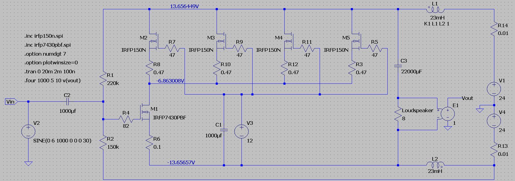

Noisy Cascode configuration
I've temporarily given up on the 3810, the 3rd harmonic is too high.
So I thought that I'll test a cascode configuration instead only to find that the output is very noisy.
If I disconnect V3 (a battery) once the amplifier is live, the noise disappears.
C1 across V3 is not connected, but having it connected makes no difference.
Any ideas?

The goal is to have a non-NFB amplifier using the SLAPS forward correction technology.
The SLAPS amplifier has a gain of 2, so a 11x pre-amplifier is required.
It is a class A amplifier by definition since the quiescent current is between 600 mA and 1.6 A for the two types in this thread.
M1 in the cascode variant has a lot more quiescent current as it is the sum of M2 to M5.
Since the intended woofers has a 94 dB/W/m sensitivity, the desired output power is roughly 40 W at second and third harmonics levels below -60 dB and -75 dB respectively.
I'm barely there with the variant in the first post and not at all there with the cascode variant even if I should solve this noise problem.
Circlomanen already had the answer in the SLAPS for SLAM thread:
So I abandon the cascode for now.
Testing IRFP150 instead of IRFPS3810 (in the amplifier in the first post) looks promising:
The cascoded version is meant as a potential future way forward if you want to experiment with some wild ideas.
Casoding does change the sound character quite a bit.
But there are some pitfalls to.
Cascoding can be prone to HF-instabilities which can be hard to detect in steady state measurements.
SLAPS with JFET
So I will probably go for the IRFP150s, but before the final decision I'd like to test the silicon carbide JFETs that Circlomanen suggested:
According to the LTSpice simulation I can get 32 W at -62/-77 dBs second/third harmonics distortions.
But let's check the reality...
