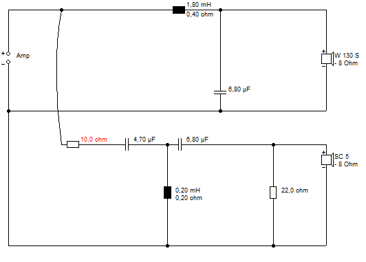

But I had a bash with something not too far away and came up with this circuit, which is a 3.5kHz crossover. I couldn't reuse the 5uF, they were nowhere near what I wanted. This is really quite off-the-shelf for a 5" plus tweeter. I can't say exactly what the red resistor should be. Select by ear. But I think it's about where you want to be.
Fantastic, thank you! I can give this a go, if I get a chance. Should be an easy one to build.
This is the tweeter:
SC5

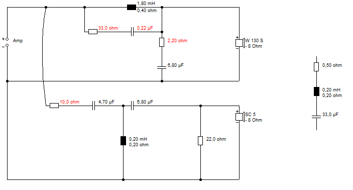

In my circuit, C7, L7, L5 and C3 form the crossover, 2nd order Chebychev, Q=1. R5 and C5 are on the board already, but I can use the 5 ohm for R7 rather. The LRC across the tweeter and the RC across the woofer are compensation circuits which provide a much better impedance curve. The values are calculated from circuits modeled on the specific tweeter and woofer. I modified the resistors R7 and R8 so that I can use some 10 ohm 10W resistors I have. The response changes are minimal.
I like your schematic, because you seem to have a bit of experience with this, and it's quite simple and doable. The red resistor will be 10 ohms - I assume this balances the tweeter's sensitivity, and I have matched this already.

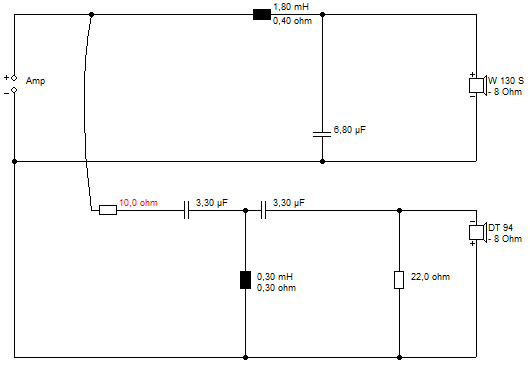

It's weird, I was just going to suggest the below circuit when you told me the exact tweeter. Because it has nice impedance, and is actually an old KEF filter that I use a lot.

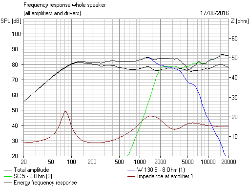

Anyway, I think this is about as good as it gets. The dip at 5kHz is a phase problem that shouldn't sound too bad. Ignore the detailed W130S response. It's just a guide really. Interestingly, the TW 70 - 8 Ohm will slot in without a murmur. Very different sound, of course.
427050d1404499096-upgrading-mordaunt-short-ms15-bookshelves-6-inch-bass-plus-2-inch-cone-tweeter.jpg
I think we are on safe ground here. You can use your 5uF for the 4.7uF, won't make much difference. FWIW, that LCR on the right is a tweeter Fs 2kHz notch that goes where the 0.2mH coil is, but it didn't really help.

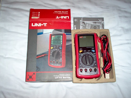

You need a good expensive meter with an inductance scale to get it right. Perhaps borrow one from an electrician or alarm engineer. Ferrite cores increase inductance about fourfold, with all the potential non-linearities at large signal.

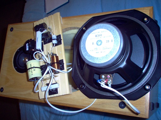

Happily in the UK it's easy enough to buy tag strip, zip ties and blocks, and coils ready made. One of my own crossovers below. I tend to use 10W or 7W or 3W ceramic wirewounds. Oh, an alarm engineer told me when crimping thin wire to spade terminals for speakers, double the wire back for thickness before crimping. Good tip.
