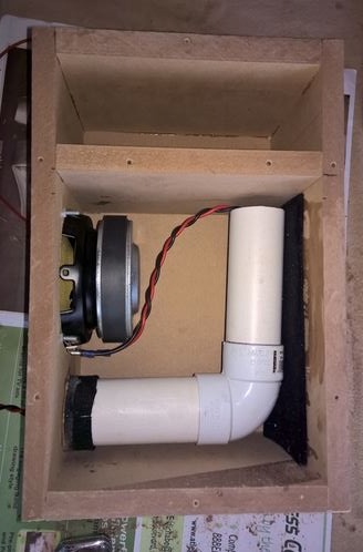

Here is my enclosure design:
All dimensions are inner dimensions. The PVC pipe is the 50mm, whatever it's diameter is (51, 52, 50?).
There is about 7mm soft cloth stuck on the wood behind the vertical part of the port to provide a cushion for it. There is also some stuffing in the box.

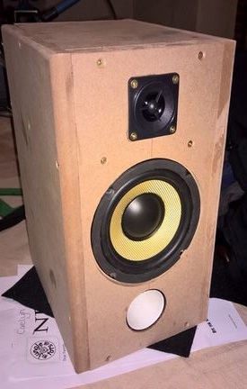

Anyway, I did finish off one speaker. The finish isn't fantastic, but it doesn't look too bad. At least it looks complete. I'll finish the other one soon and hopefully my friend enjoys these for years. Oh, and in real life, those lighter bits are not really that light.
