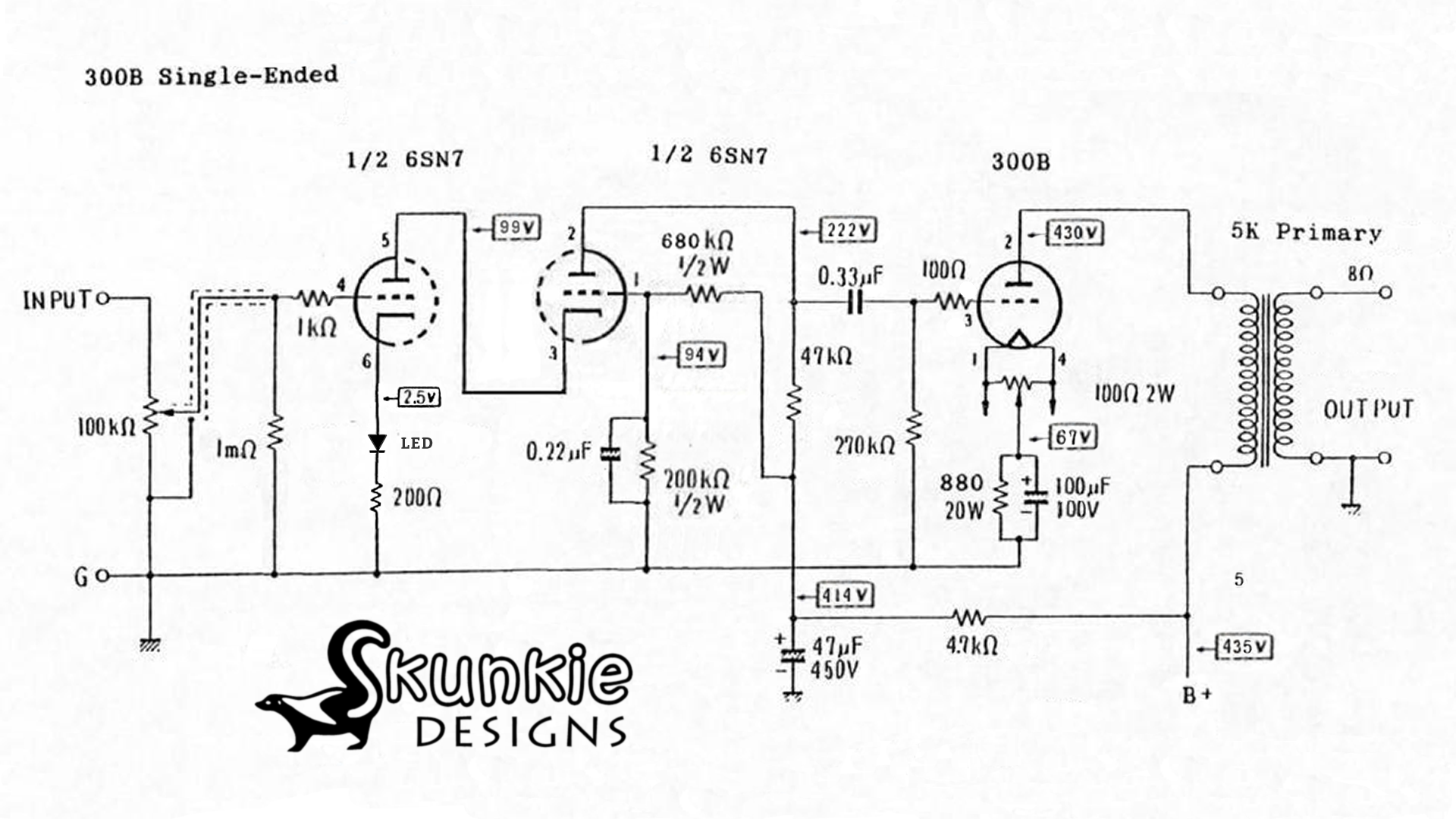

I want to thank Stephe for sharing the Youtube video and her adventure with the amp that I am considering to build.
I want to clarify a few quesions
1) can I use solid state diode power supply for the B+ ?
2) What about using an ac to dc power smps from Meanwell for the heaters ?
3) I notice that most output transformer show usage of 2.5 or 3.5 K output transformer . Is there any issue with 5K output transformer ?
What is the wattage of the output transformer ?
Thank you

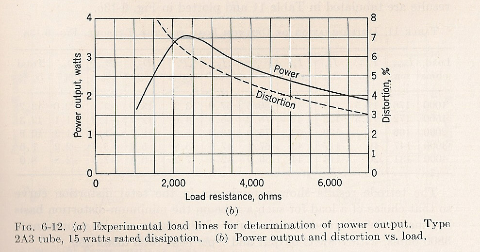

5K is fine for the output transformer. Pout will be roughly 5-6 watts. You could squeeze a meaningless watt or two out of that transformer combo by going to solid state rectification and adjusting the bias resistor. I’ve never tried a smps for the filaments but the Coleman regulators are inexpensive and work well.
They are both 'no brainers', just a slightly different build with similar parts. There are close to an infinite way these can be put together with good results. And low mu triodes like the 300B are very tolerant to the OPT used, within reason.Compare this to https://www.diyaudio.com/forums/tubes-valves/373171-advice-set-amp-build.html#post6679841 post 1 - which one is the original ?
In the youtube, Stephe justifies why she change the value of the 27K from the B+.
The change result in more voltage swing for the 300B .

I asked why not just build with a pentode input ie. EL84.
Response was that it was harder to drive than the trioded cascode input.
I'd walk away.
I'd walk away.

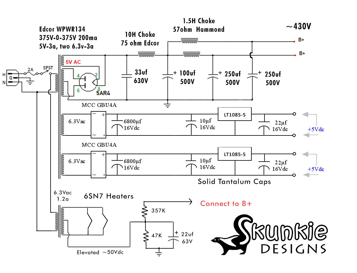

Yeah, I think 350-0-350 would be fine or whatever you need to get B+ 430v

Is 100 ma maximum current capacity adequate ?
Need 200mA both channels or 90mA mono

I prefer 5K with a 300b and so do others, though it depends on the OPT and operating point. Not a major worry.
You probably only need 70mA current for a typical 300b operating point, so 100mA per OPT would be fine.
Using a Meanwell for the heaters is fine. Their outputs are floating and they are very clean. Just make sure you rate the SMPS for about twice the nominal heater current so it can cope with inrush current.

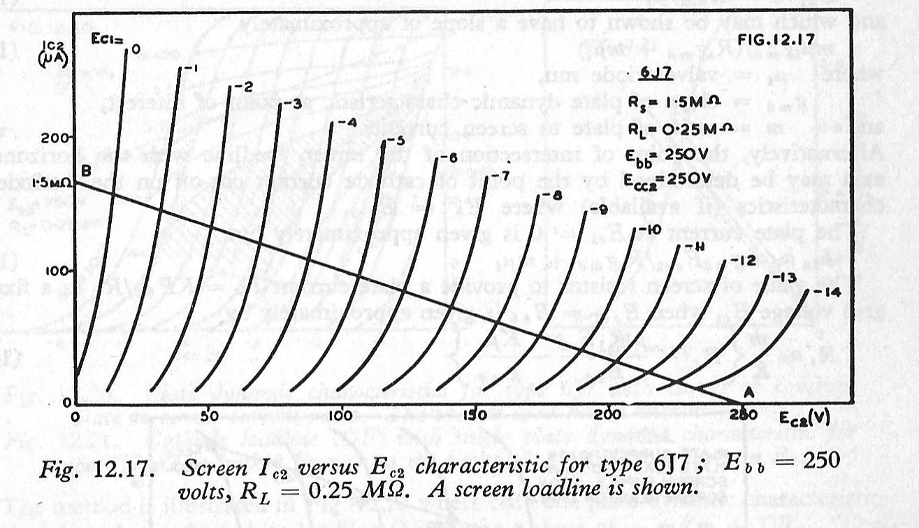

Tying the screen of a voltage amplifier pentode to a zener hardly makes sense, the screen resister is there to stabilize the operating point of the tube as it ages. So the zener may be OK for a while, then what? The bypassed screen resister (not a voltage divider) provides about 10 db NFB at LF as OP stabilization, I had a look at this a few years ago on the bench. The results are here.
And something seldom seen, a plot of screen curves!😀

Let's be clear, my reply was "That's an option, but a cascoded 6SN7 is very linear, is a great sounding tube and I have a pile of them to choose from 🙂 Plus not all pentodes are easy enough to drive off of line level on the grid."
I think it's pretty clear you're not going to get 140-160Vpp into a 300B grid from a 3Vpp signal using just any 'ol pentode tube. And you didn't mention any specific tube, just: why did you do this cascode instead of just using a pentode.
