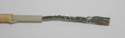

I suggest , just as one example, to connect an amplifier to a load, resistive so as to further simplify it, say a couple 8 ohm resistors, with a 10 meter long 1 mm section wire pair, we might use transformer type enamelled wire so as to both have some kind of insulation, and at the same time keep it as thin as possible.
We must have available 2 cable sets: one conventional, and the other with each conductor wrapped in magnetic tape of the kind suggested earlier.
We sweep at a fixed level, say 5 or 10V RMS, from 20Hz to 20kHz, measuring at the load end.
1) we check for frequency response flatness, specially at the highest frequencies, any loss at high frequencies might be due to skin effect.
a) we use plain wire.
Do we find loss attributable to skin effect? [YES/NO] (tick one)
b) IF loss is found on plain wire, is less of it present on magnetic tape wrapped one? [YES/NO] (tick one)
Post results.
2) if NO attenuation is present at these audio frequencies and wiring lengths, then skin effect is irrelevant under average Audiophile use and "correcting" it is not needed.

If I have a wire of solid copper, the calculated skin depth at 20kHz is ~0.46mm. So say I use 18AWG wire (1.02mm Diameter), this would mean that the signal is confined to use pretty much 100% of the cross section and therefore there is no skin effect.
So if I then choose to increase the gauge of wire, I increase the skin effect. The fatter the wire, the more dense the current is towards the outer torus of the wire's diameter.
But what is the actual effect - is it just the reduced current carrying ability of the wire (because you are now only utilising a percentage of the cross section), or does this effect induce a loss or distortion to the signal?
What kind of magnitude of dB loss would one expect? Are we talking tenths of dB? How does it compare to insertion losses and the resistance versus distance of the wires for example.

Yes, up to a point. If you have a wire much thinner than the skin depth then all the wire is used, so no skin effect. If you have a wire much thicker than the skin depth then the current mostly flows in the skin near the surface of the wire, so doubling wire thickness merely halves resistance instead of quartering it.
Increased, and frequency-dependent, resistance hence some mild HF loss; almost always negligible. As skin effect is linear there is no nonlinear distortion.
If the wire is big enough then no significant effect on normal audio systems. I don't know why people keep banging on about skin effect in audio; it is a good example of claiming a false effect from a real phenomenon.
