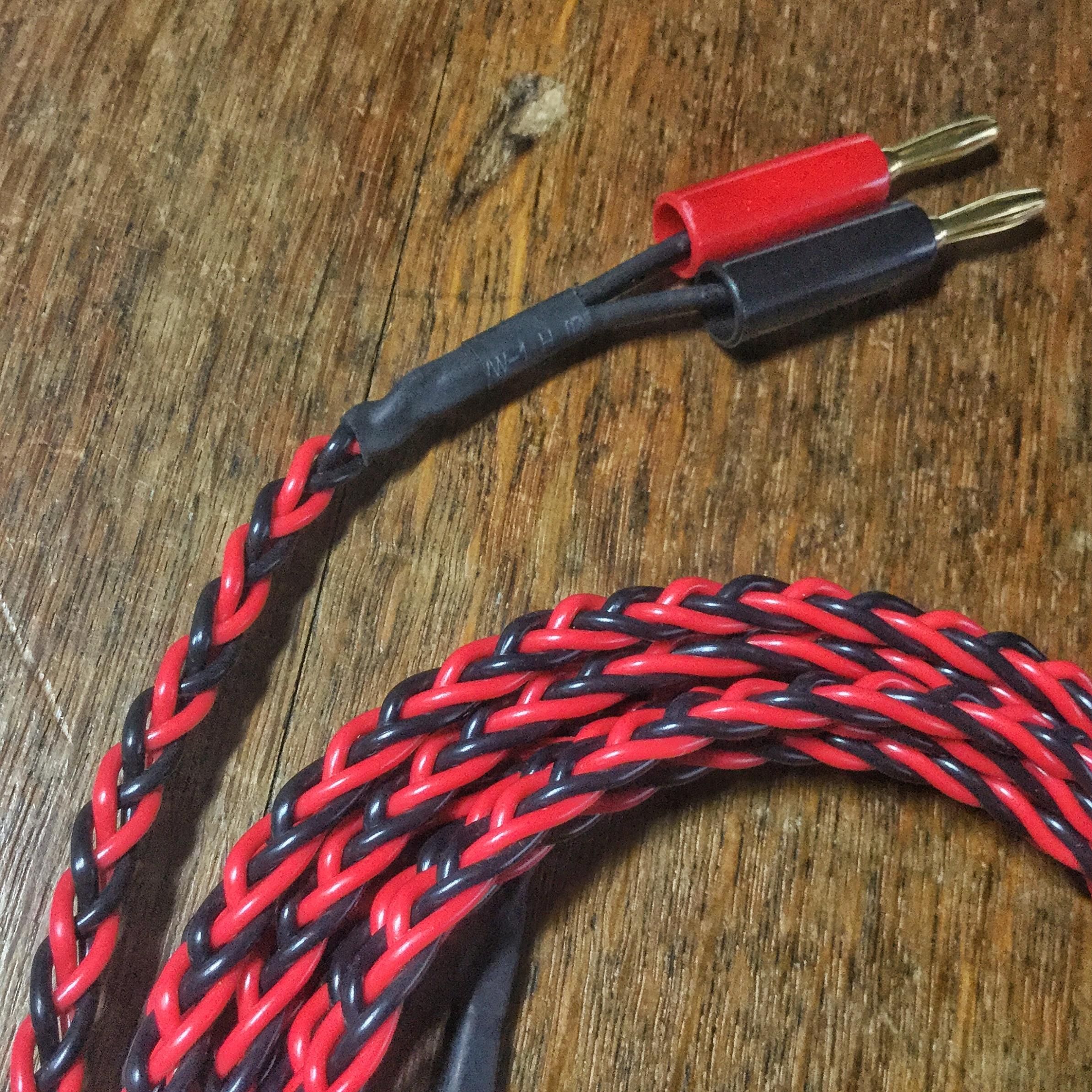

I puzzled over the physics of speaker cables for quite awhile before deciding to make my own from 24 strand teflon coated automotive loom wire, using a four wire plait - mainly because it is of reasonable quality and cheap. Theory has it that a 4 wire plait enables the resultant cable to more or less self-cancel out any radio frequency interference, or other forms of electromagnetic modulation well beyond my ken.
So, I read through this thread and come to Nigel Hawthorn's reasonable assertion that single strand 13 amp flex does the job just fine. I have no reason to disbelieve this, and if this true (as I am sure it is) then is what I have done with a four way plait simply overkill? Or, would the use of just two 24 strand wires in and out my speaker be good enough? Would I ever be able to hear the difference?
BTW, all the other interconnect cables in my rig are of music studio (read modest but good) quality, running between battery operated bottom shelf electronics. I would like to understand the issue better, as my main interest is designing and building ultra efficient horn speakers. ToS
Your four wire plait looks like it might effectively be a twist (which is best for cancellation of interference) The way twisting works is simple enough and has been known for a long time. Have a look at using star quad for speakers. Star quad cable - Wikipedia
Thank you for that Scott, it looks like I have done the right thing. The cable in question is only 9ft long, and I doubt if I am missing any high end. Including the banana plug connectors, the total cost worked out to be £1 per foot.
