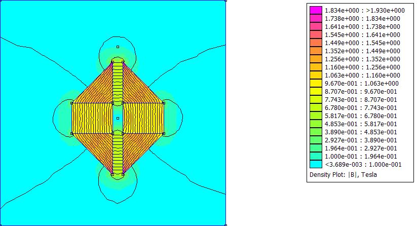

Here's a similar implementation in FEMM:el`Ol said:I don´t know whether you have looked at the linaeum patents. Here both branches of the coil are in the magnetic field. When I was considering to build an FAL like flat diaphragm driver some time ago I stumbled across a very useful element for such a task: Drawn steel profiles with a rectangular triangle as cross-section.
It is using rectangular iron to get the magnetic circuit to a pair of very small gaps and seems to be very similar to what you are trying to do here for a field to drive a flat VC.,

of cause using both sides of the coil is preferable
with respect to efficient motor.
I had a design with a voice coil carrier using both sides,
but currently i prefer "wasting" one side of the coils for
better integration with coil and membrane, i do not know.

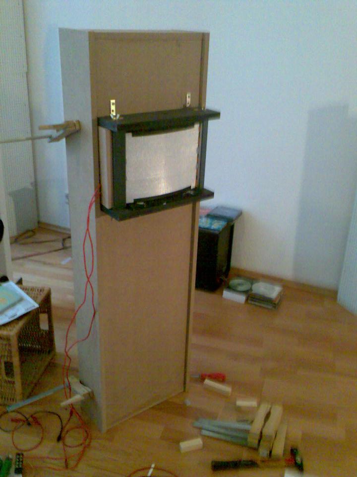

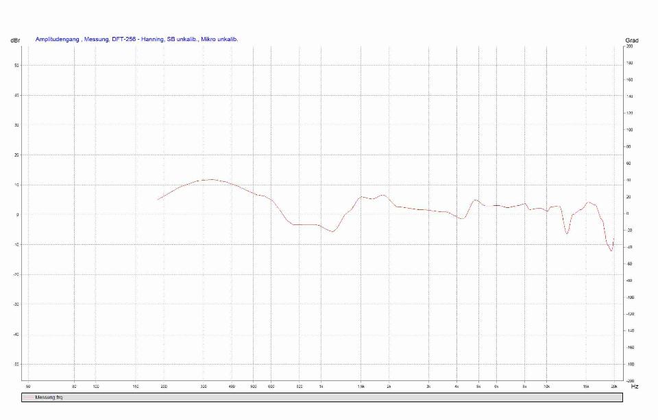

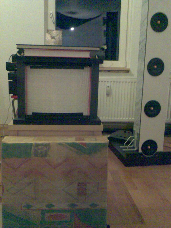

I auditioned a first attempt using only one sheet driven by
two coils today.
Positive:
- it IS a Fullrange system. There is Bass and highs are
really beasty, i had to eq with 0,27 mH 3,3 Ohm in parallel.
DC Resistance of Speaker is only 1,8 Ohm.
- there is some coloration in upper midrange
- distorsion seems in a sane area ...
Negative:
- low efficiency up to now (was expected)
- noise at higher volume (maybe connecting wire touches the
membrane, i will see)
- there is some coloration in lower midrange and "nasal" region.
Conclusion so far: No High End Speaker from the start ...
But i see potential (and work!)
Regards

the panel seems to have a wide dispersion pattern,
even in the highs, even when listening about 45 degrees
of axis there is not much loss in brillance (if any ..).
Uniform dispersion and good output at the upper
end seem to be possible advantages compared to a
conventional fullrange speaker of same membrane area.
Even at that premature stage impulses like
attack from piano drum beats etc. were rather crisp
and realistic.

LineArray said:the panel seems to have a wide dispersion pattern,
This is exactly what I experienced with this design:
http://www.diyaudio.com/forums/showthread.php?s=&threadid=80797&perpage=25&highlight=&pagenumber=3
Measurement gave a slower CSD than expected, so my conclusion was that it works like a DML speaker a'la NXT.

Now proudly like to present: The ugliest speaker built ever:
@Paul Burton: Thank you for the information, i am currently
reading the patent.
@jzagaja: The animated polar plot is very instructive and
matches my experience with my own DML panel.
Now a quick measurement.
Around 1m distance about 45 degrees off axis.
Free air resonance of the driver is about 55 Hz, dependent
on suspension.
Time frame is too short to evaluate the bass response
of the speaker, but due to high Qts it sounds a bit
"fat and boomy".
Sounds different than a conventional dynamic fullrange
driver.
Sound does not change very much with listening position.
Listening is OK even at larger distances.
After some tweaking i can listen even to strings and voices
without getting hurt.
I have not expected to get that far with this prototype ...
on suspension.
"fat and boomy".
driver.

i currently have no calibrated setting to evaluate
efficiency properly.
I would estimate in comparison ro other speakers
i own, that efficiency is below 80dB/W at 1m.
The proto's motor has an air gap which is 8mm wide ...
It was just designed for experimenting/development.
Next Proto will have a different motor:
- Air gap will decrease to ca. 1mm
- Stronger Magnets of double volume
- Double length of wire in the magnetic gap¨
Furthermore mass of diaphragm and stiffness
of suspension will be optimized.
I expect that efficiency will be in the range of
conventional dynamic speakers of same diaphragm
area (active area around 400cm^2).
A "high efficiency" version will be possible regarding
stiffness of suspension. There will be the same
compromises as with conventional dynamic speakers.
But it is difficult to have a conventional fullranger
of that size, having an upper frequency limit of
around 20 Khz with excellent dispersion up to the
top ...
Kind Regards
