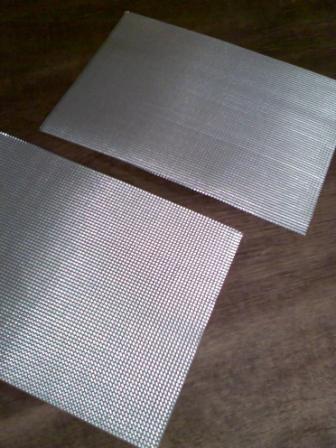

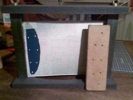

Hi jzgaja,
you have looked up interesting materials ...
Currently i do not think about changing stiffness across
the width of the diaphragm.
If such modification seems necessary in the further
development i tend to modify stiffness by stamping an
appropriate pattern into the diaphragm.
See attached pics.
First i think about
1) how to design/integrate the voice coils
2) how to design the gasket (major construction problem)
3) how to design the suspension if not identical with the gasket
My current thoughts:
1) Wind 2 stretched rectangular coils and glue them between
the left and right edges of the sheets.
This way no additional VC carrier is needed. Diaphragm
acts as heat sink ... which should result in very high power
rating.
2) No Gasket ! Tolerate a slot on the bottom and the top
of the diaphragm. Edges of the slot are covered with
textile to minimize streaming noise at high excursion.
Leakage is accounted for in the Qts of the system and
dimensioning of the cabinet to be built.
3) Suspension can be formed as elastic bobbins below/ontop
of the voice coils, allowing proper adjustment of the coils
in the magnetic gap and well defined VC motion in one plane
only.
Since i have seen and heard the early prototype working, i tend
to solve those design an manufacturing issues first.
When necessary to go to different diaphragm materials i
would do that in a next step without changing the mechanical
principle after that principle is tested.
Please keep on sharing Your thoughts ...
Kind Regards

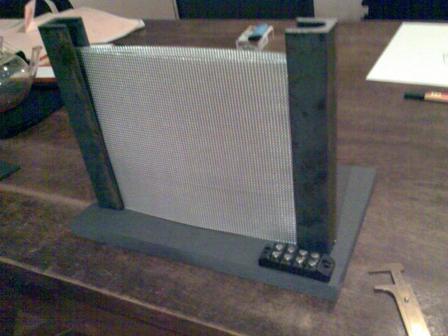

Hi jzgaja,
looks like you are building a bending tranducer test bench ...
Very nice 😀
Best Oliver
Very nice 😀
Best Oliver

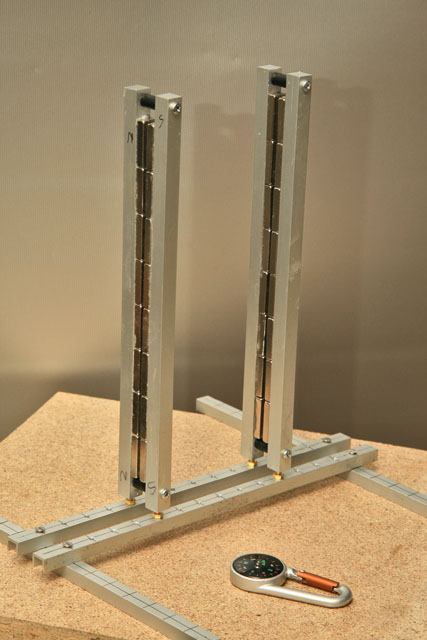

Oliver,
Hehe you know my neos have bent the aluminium trusses so imagine 2m tall transducer 🙂
I've tried coil attached with super glue only on one side. Too much work but quite loud. I prefer tape or conductive acrylics. Usually you can buy with E-05 Ohm*meter range for repairs but I've found E-07, 100g for 60 Euro. But these found in a hardware shop won't polymerize at room temperature. They need a heat...
For quick prototyping elastomer+alu is fine. Have you tried carbon fiber? Speed of sound is high enough but thickness...
Oliver,
Am I right you use a larger gap? Mine is 3/1.5mm (end/mid). In a final prototype I would use hunderts of small laser cut plates - similar to ones from ribbon microphones.
magnets are not mounted yet. But you are right, magnetic
gap will be quite large, around 4mm.
I want enough space for experimenting with different
kinds of bondings between front/rear diaphragm and
voice coils. This model is not supposed to establish an
efficiency record.
When the kind of bonding is settled, i can use a narrower
gap later on.
Best Oliver

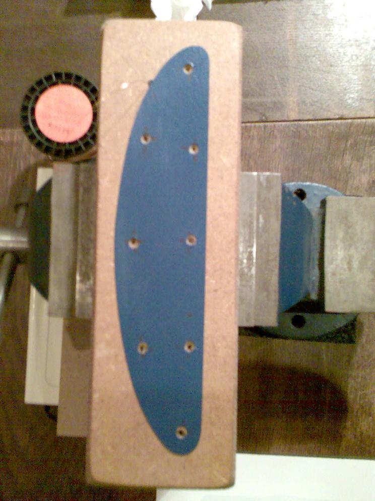

blue piece in the middle is the winding form.
The cover piece has same size as the "table" and
is removed for the photo.
Blue piece has same thickness as the wire. Table and
cover force the wire to wind up in one plane.
Winding bench and winding form are coated with wax
before winding.
Bench parts are put together with screws before winding.
Glue is applied into the slots. Wire takes glue when wound
around the winding form.
Not easy i want to tell you ...
Best

Still don't get it 🙂 Membrane is curved perpendicularly to the coil and blue spacer looks more or less like membrane viewed from the top. Basically you look how to make a spiral coil - coil that has a wire thickness (?)
yes the spiral coil has wire thickness.
The uncurved part is inserted upright into the
magnetic gap.
The curved part is to get current out of the
magnetic field, so current flows through the
field in one direction only.
4 coils are used. Each of the 2 diaphragms
has a pair of conducting layers to be driven
from both the left and the right edge.
2 coils glued flat to the inner side of front diaphragm.
2 coils glued flat to the inner side of rear diaphragm.
Uncurved part of the coil inserted into the magnetic gap.
Curved part outside the magnetic gap.
All 4 coils glued to the inner sides of the
diaphragms, they are invisible when device
is mounted.
Diaphragm acts as heat sink for the coils.
Coils act as damping elements for the diaphragm as
a secondary function.
Resin used to bond layers of the coils and the
copper itself are somewhat plastic to provide inner
damping of diapragms.
This is my current plan ...
magnetic gap.
is mounted.
