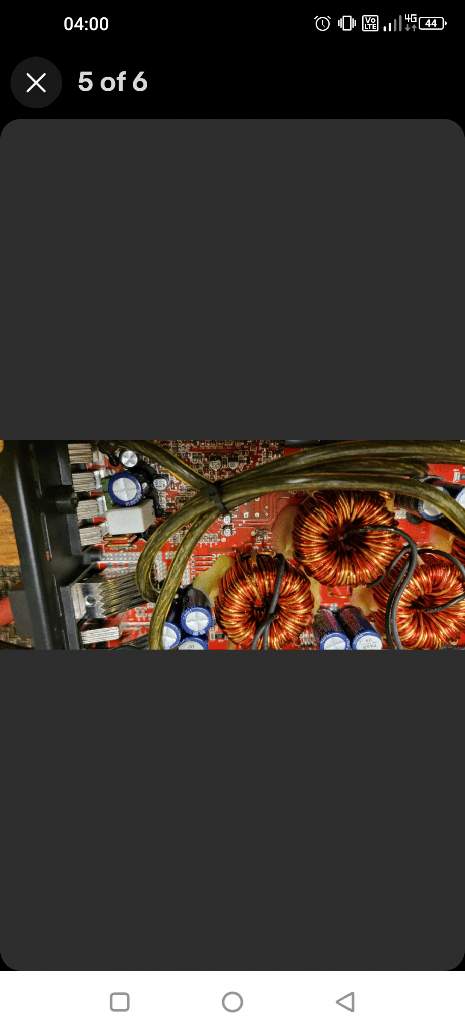

So I recently purchased a skar 2000.1d, knowing it had been damaged. The output had been shorted out at almost max output, yet the damaged was surprisingly minimal. There is however a resistor that burnt up, and I've had no luck finding any schematics, and simply got PFO'd when I reached out to skar. Does anyone have one of these handy that can take a look for me? It appears to be labeled R99. I hope this is in the right section. Thank you all for reading!

Well, after bridging that link, removing/testing every MOSFET on the board (the 8 diodes and voltage regulators as well) and the removing/checking the main caps, I can't identify any other problems with this thing... Nothing is burnt, and at idle (with the protect light on) it only draws about an amp. I know it's a shot in the dark, but does anyone have any suggestions? I really don't know where to go from here...
