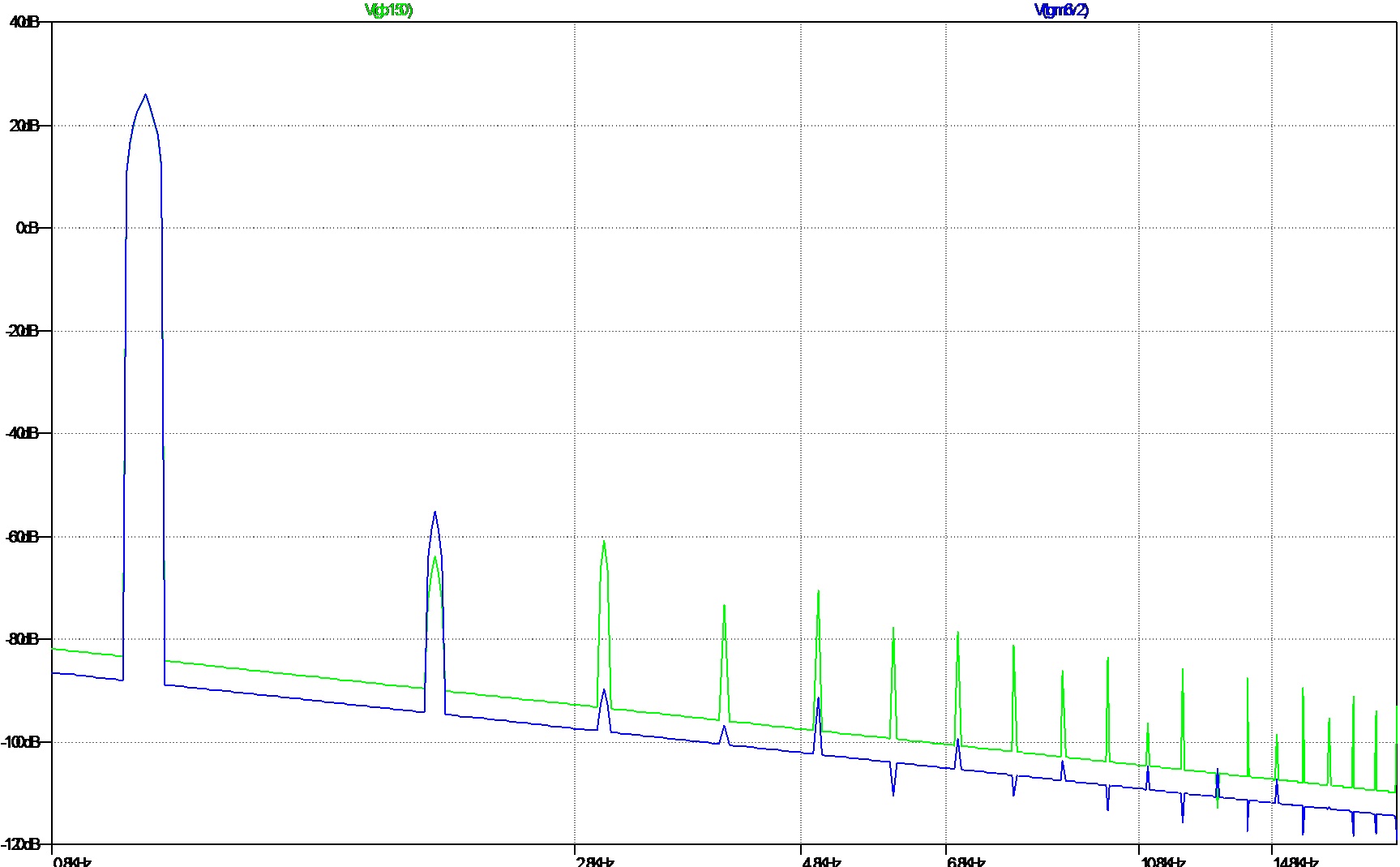

I like to see how things work in Spice. I've loaded up the schematic, but it's not set up properly - a starting point for somebody if interested ?
Joined 2009
Corrected version attached. For comparison purposes I have also included my own TGM6 amplifier, which is a single LTP input where I have also bootstrapped the LTP collector load from the VAS (no cap needed in my case) - just for fun. The FFT is quite different of course, the TGM6 (blue trace) being an asymmetric input stage has more H2 distortion, but it's distortion profile for higher orders is much cleaner than the SKA (green trace) - cleaner in fact than any other Class AB amplifier I've ever simulated. The profile for SKA looks like decreasing distortion products - a desirable situation for some people.

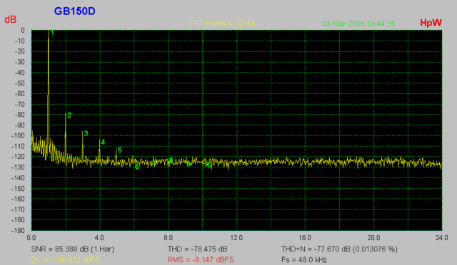

Bigun said:...is much cleaner than the SKA (green trace) - cleaner in fact than any other Class AB amplifier I've ever simulated. The profile for SKA looks like decreasing distortion products - a desirable situation for some people.
Greg says: Of course my development work for this amplifier used real supply impedance not simulation with theoretical 'perfect' supplies...then the distortion changes significantly as PSSR artefacts intrude ...simulation with zero impedance supplies favours amps with poor supply rejection, and offers no real comparison.
