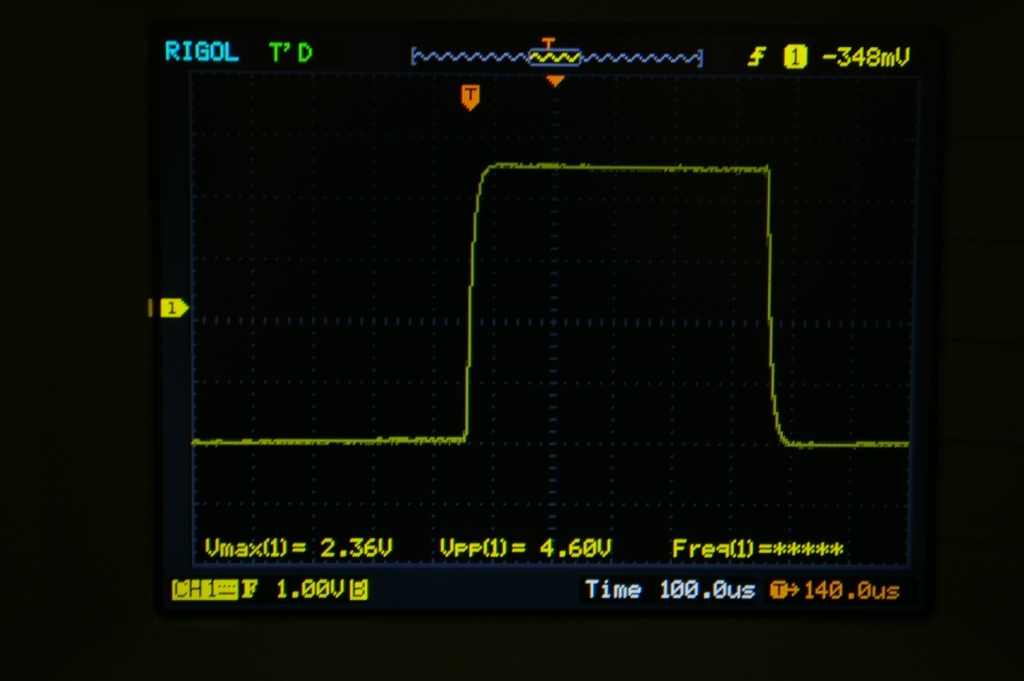

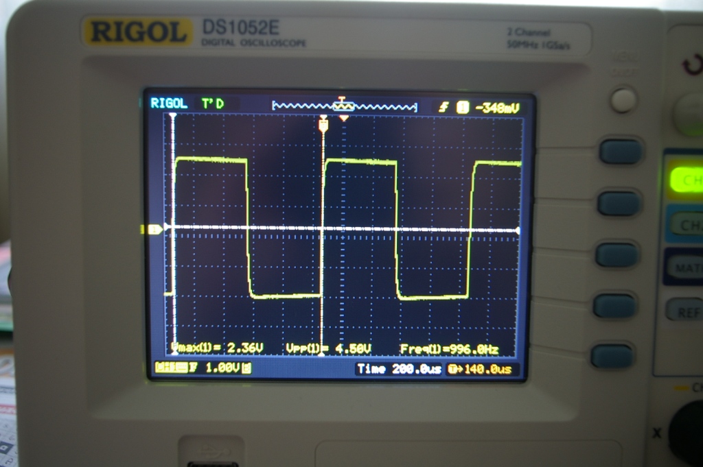

Now I have a free square wave generator. Thanks Bigun!You have a free square wave generator in your oscilloscope.
I attached the pics from the scope with 10pF cap. The scope gives 1kHz sine.I used the speaker as load so the voltage is only 4.60V (my ears can't stand a higher voltage-noise). All seemes normal, doesn't it?
One thing: after replacing the Rifa cap with a Wima the sibilance much reduced. But I still find the voices - particularly the female voices - a little hard, not smooth and polite as the original SKA. Could it be the 2SA/SC sound signature?

That waveform looks pretty damn good, it would be great to see how it performs at higher frequencies and voltages. Maybe you could build a cheap dummy load to save your hearing - I just use a few cheap power resistors in parallel.

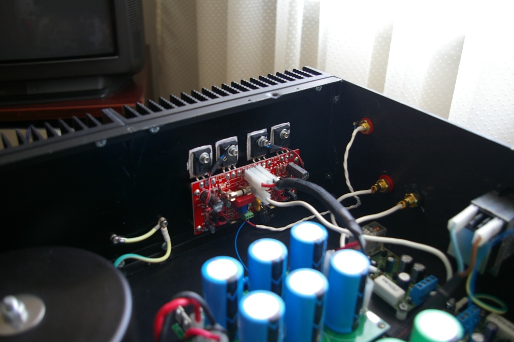

I used Jim's BOM and no problems with it. Actualy, I solved the sibilance and hard sound problem, now everything is perfect sounding very good indeed!

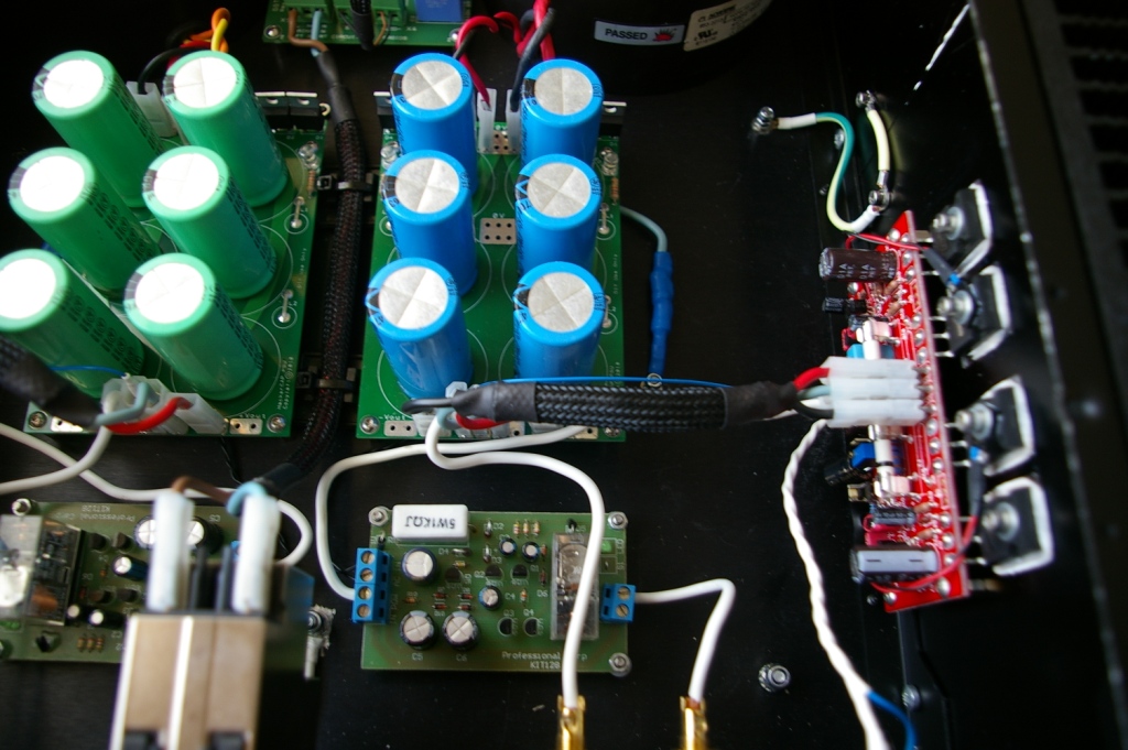

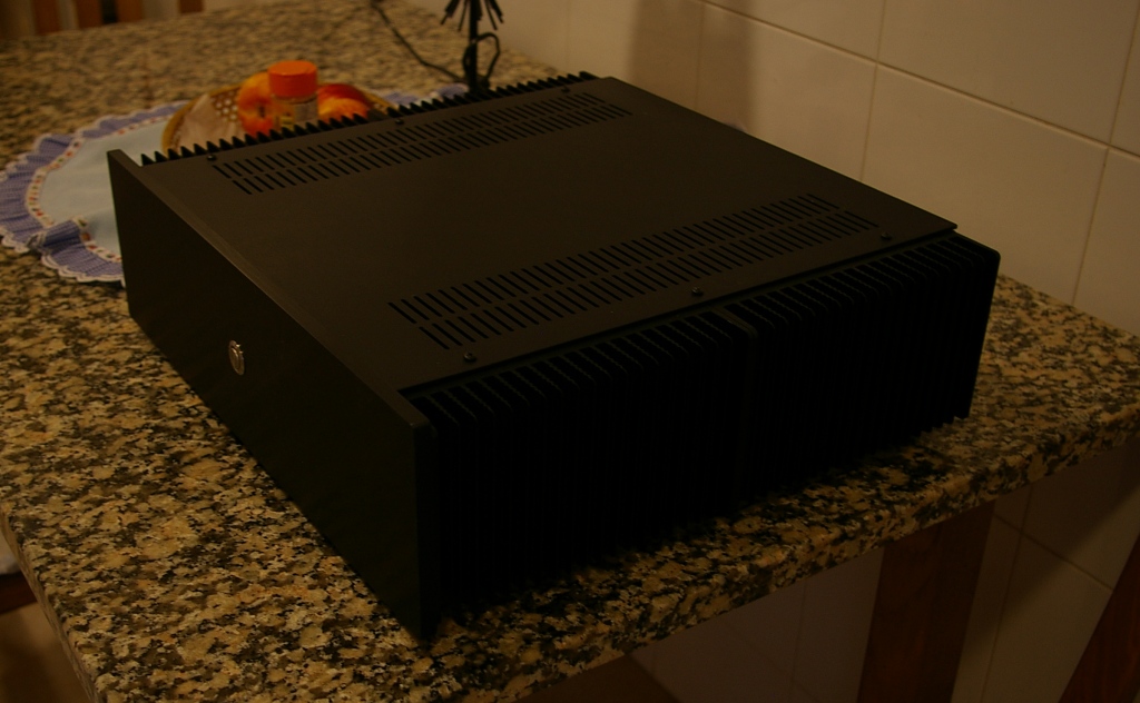

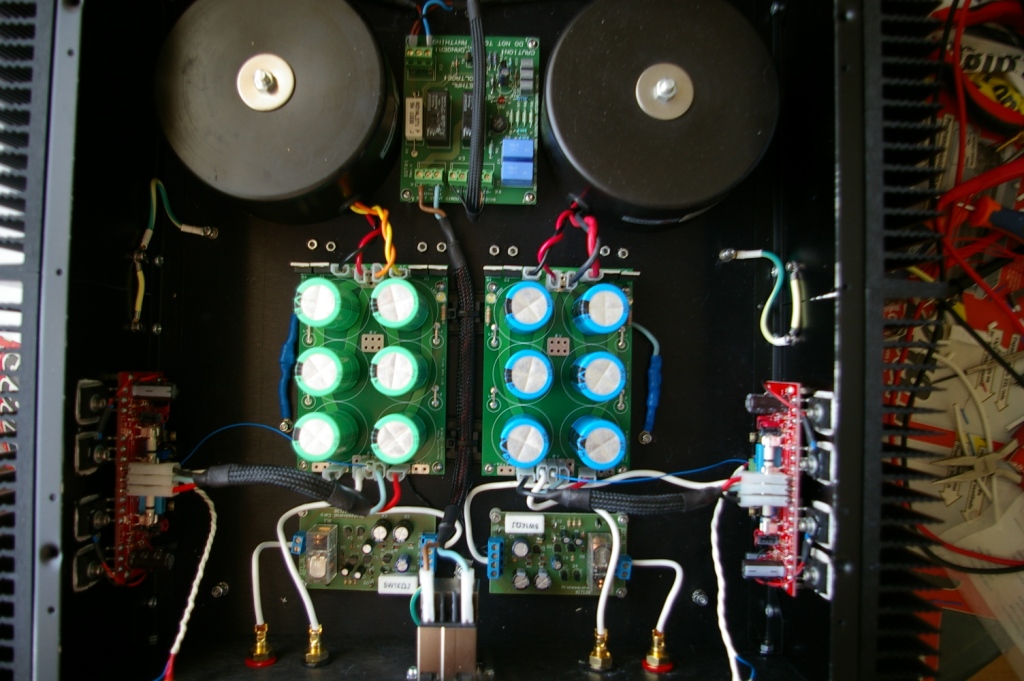

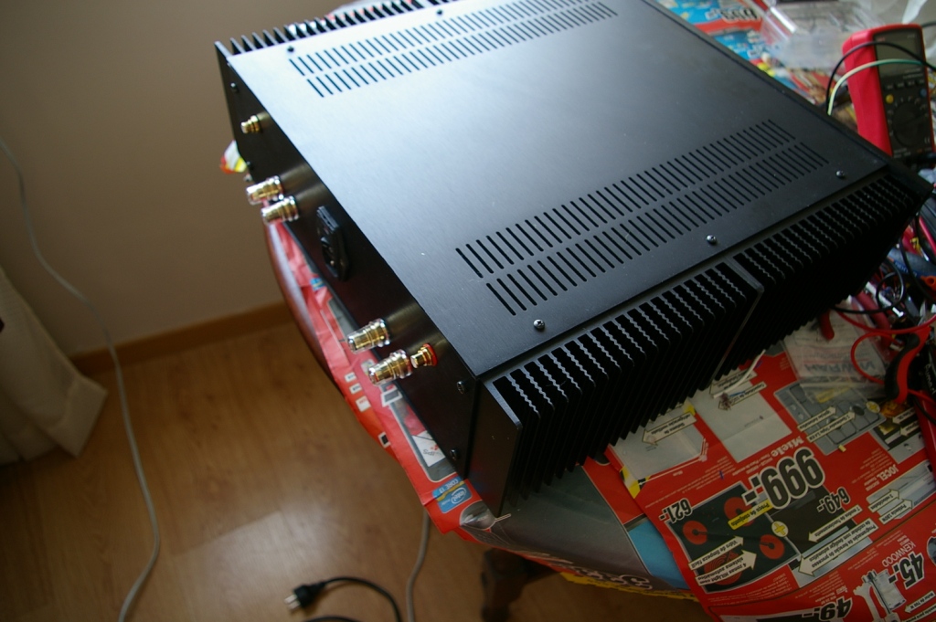

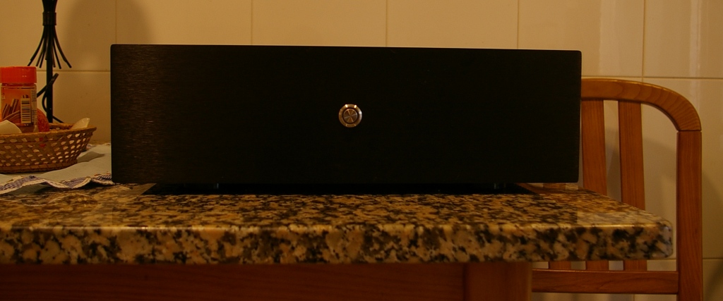

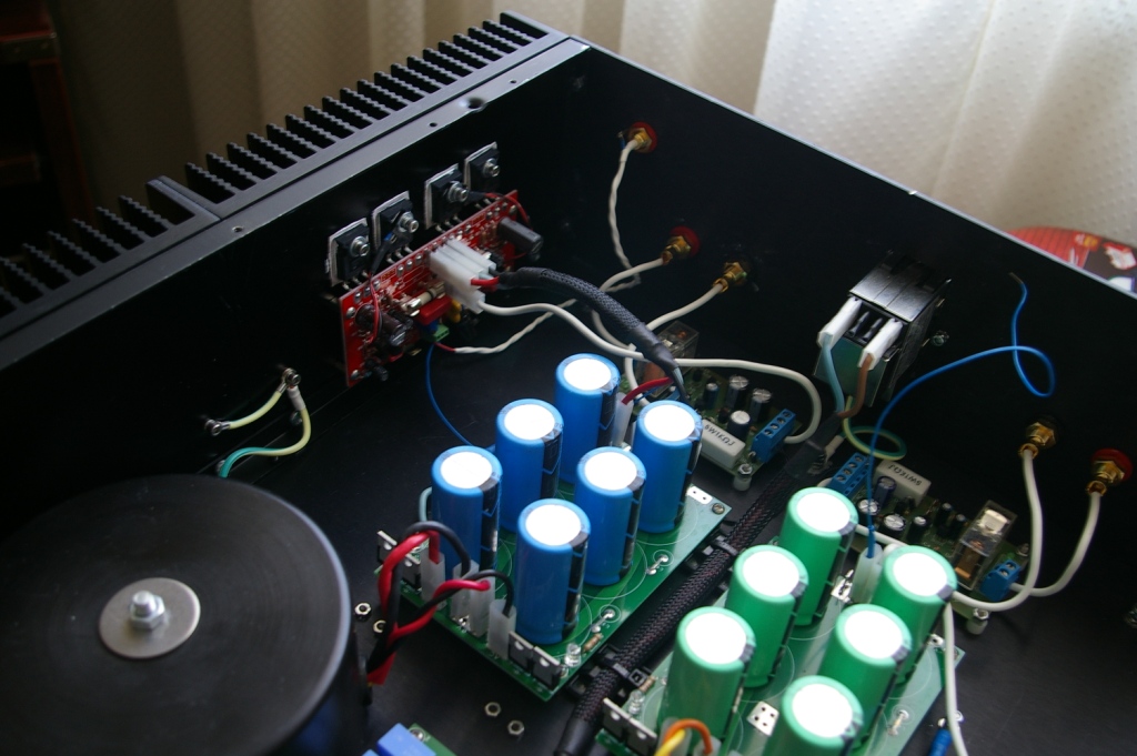

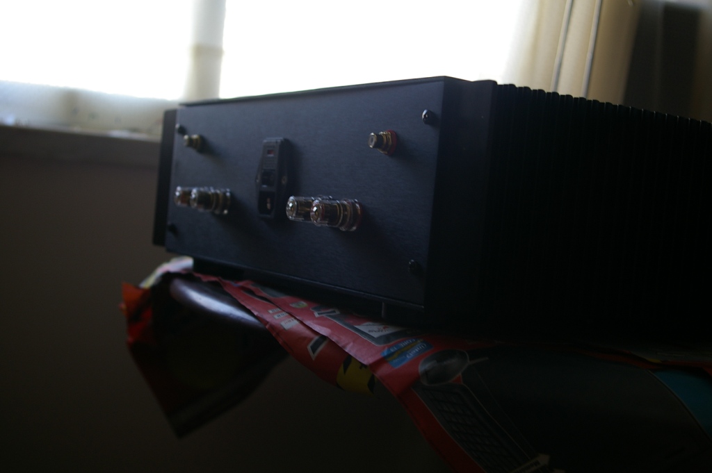

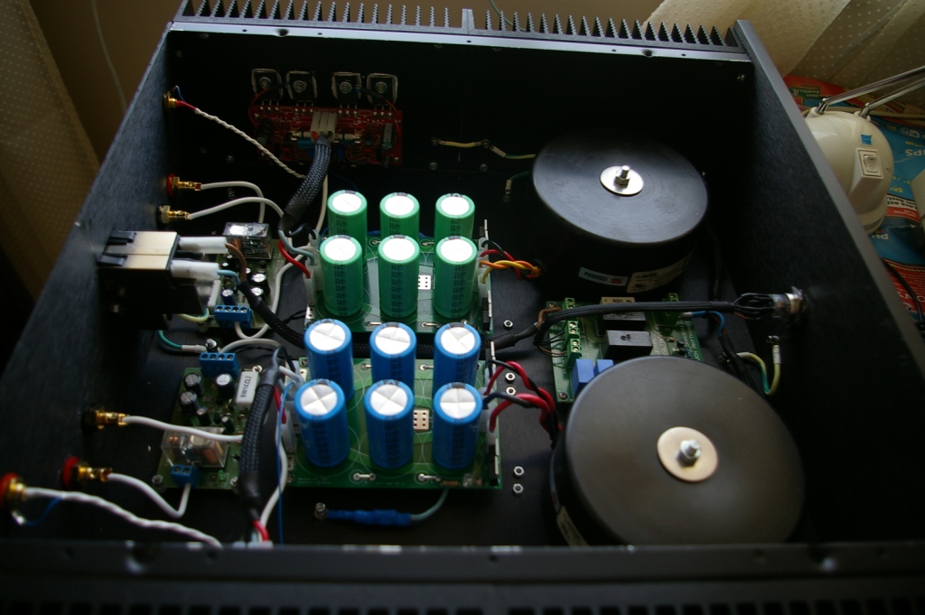

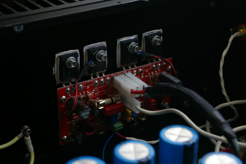

Here some pictures of my build:

Yes, I used the RCR mod not the zener one.Hi Paulo,
I noticed above that you don't have D7 and D8 installed. Did you omit those?
Thanks, Terry

Paulo, very nice work, the project looks most professional. I think I'm going to source a good hi-end chasis and build my final version of my home theatre amplifier into it. I've never worked with a new good chasis before so it will be a treat. Then I'll have an excuse to build 5 amplifiers

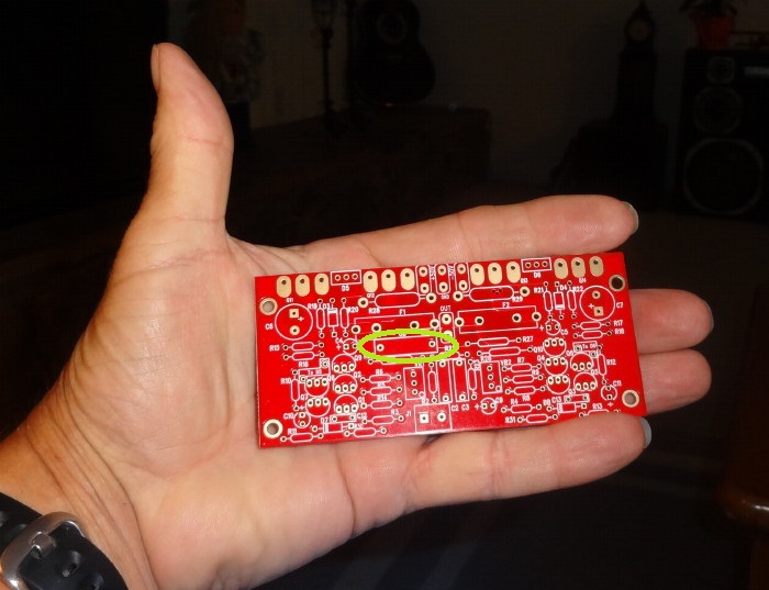

What did you do to solve the sibilance problem?
That's very flattering, thank you Bigun!Paulo, very nice work, the project looks most professional.
Thanks Do!Nice build Paulo!
Yes, it is!Hey, that's a Per-Anders Sjostrom softstart, same as I use in my SKA!
I first used a Rifa PHE450 as zobel capacitor and I was having a great deal of sibilance. Greg recommends a Wima MKP for this role. I changed this cap for a Wima MK10 and the sibilance was gone! I don't know if the Rifa was bad or was just the way it sounds in that position, anyway the sibilance was gone when I changed caps.What did you do to solve the sibilance problem?
May I ask which cap is the zobel?
Thanks, Terry
Hi Terry,
Here (I used your pic) you have the cap that is part of the zobel network (RC).
