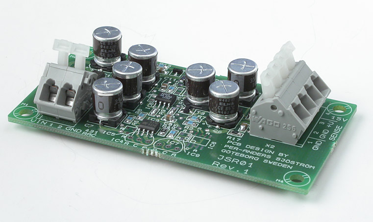

1 The regulator is a single one but the can be built as positive or negative (one pcb for both types).
2 DC in yes but the quality doesn't have to be too good.
3 All parts are common parts. Even the voltage reference can be of 4 different types, just for the flexiblity
4 You can buy as many Gainclone pcb's you want 🙂 The performance is good and/or you can choose the parts you like as long as they fits in order to get the performance you want. My design uses mainly common parts. That was my design idea.

About the cost, I suggest that you take a look at the partslist and check for yourself what the cost can end up with. It's very hard to say, if you can get samples, you have things in your drawers or you must buy everything.
Managed to find the parts list didnt see that before!
Am i correct in saying that the IC's are the expensive parts ?
if so this is what i have found ...
IC1 LM317AEMP Positive voltage regulator, adjustable, 1A, 40 V, SMD Positive regulator 0.7
IC2 LM337IMP Negative voltage regulator, adjustable, 1A, 35 V, SMD Negative regulator 1
IC3 TL431AID Shunt regulator, 2,5-36V, 700mW, SO08, SMD Positive regulator 0.42
IC4 LM385Z Shunt regulator, 2,5-36V, 770mW, TO-92 Positive regulator 0.65
IC5 LM431ACM Shunt regulator, 2,5-36V, 280mW, SOT-23 Positive regulator 0.7
IC6 AD797AR Ultralow noise audio opamp SMD 7.47
IC7 LM385Z Shunt regulator, 2,5-36V, 770mW, TO-92 Negative regulator 0.65
IC8 TL431AID Shunt regulator, 2,5-36V, 700mW, SO08, SMD Negative regulator 0.42
IC9 LM431ACM Shunt regulator, 2,5-36V, 280mW, SOT-23 Negative regulator 0.7
Thats about £13 , does that sound correct.
Any more expensive parts to look at ?
Thanks again!
£7.50 for an opamp and it wont even be used in the audio signal!
But i guess its one of the key elements.

You don't have to use the AD797. If the extremely low noise not is needed you can choose some other opamp which can work properly in this design.
You reply fast mr PA!
If a lower opamp is used then wouldn't that mean the circuit is overkill for the quality of output, or still using quite a good op amp (opa etc?) would produce excellent result, just not "Super".
The price of the op amp is pretty ok anyway - if its the only thing costing that much - I really just wanted to check that i had priced up the most expensive components about right and wasnt in for any nasty suprises!

The regulator has one important feature: Very low output impedance high up in frequency due to a fast output stage combined with a fast opamp. You can also achieve very low noise but I think low output impedance is more important.

Hello,
Is there any point in using these for discrete circuitry (such as pre-amps) which have resistors (some high in value) connected to the supply rails and some resistors with variable currents being drawn through them. To me this seems to negate the advantage of very low Zout. The PSRR is still obviously better.
Was thinking that certain nodes wouldn't benefit.
Do you need ultra low impedance for supplying CCS for example, wouldn't a high impedance be OK ?
In otherwords, are they only really suitable for driving op amps ?
(transistors to transistors)
Interested in any answers

Yes good question Kevin.
I'd be using two with my active xover which has 7 opamps on it powered at +/-15v.
I presume these are powered direct, i think they just have the small caps for bypass.
So are these ideal for my application? Dont want to waste my time(and money).
(The other two i'd save for a dac)

When you think about it, many circuits presumes supply voltage with zero impedance. I have never used a super regulator in practical use so I don't know how much good it will do. I'll expect that you experience the same difference as when you change from TL071 to AD8610. You will get a lift in the sound quality which is hard to imagine before you have experienced it.Kevinbd said:In otherwords, are they only really suitable for driving op amps ?
I suspect that MC, MM and mic amps with discrete technology will benefit the most of a super regulator but I could be wrong here.brianuk said:So are these ideal for my application? Dont want to waste my time(and money).
I have updated the partslist for +14V, -14V and +5V.
Are there any more common voltages which need to be calculated?
