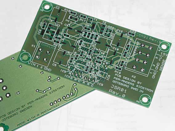

peranders said:I have got pcb's for the first prototypes.
Boards look good! but why are the SMD pads black? Is it a reflection?
Brian
peranders said:Thanks. Yes, just reflection.
Good, boards look pretty! Good job on the layout.
Have you stuffed one yet? I want to see an assembled board. I like the look of surface mount components. Also, what kind of terminal blocks are you using with the dual row footprint?

The connectors will be Wago 256. Check all my other projects!
I will start soldering as soon as I can find the time.

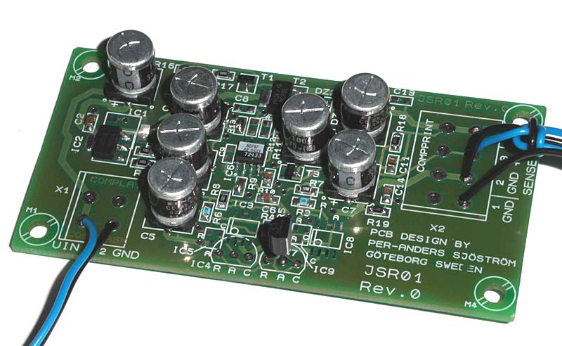

I have soldered the pcb's (one positive and one negative prototype) with the exception of the electrolytics, which I will get soon I'll hope.
The positive regulator works now and can deliver at least 150 mA. PSSR is more than 5 digits on a DVM. I haven't tested all yet. 🙂

Both positive and negative regulator are now soldered and it was quite easy Fred!
The picture shows negative version.
I have changed the power for the AD797. A LP-filter 47 ohms and 100 nF is inserted and C13 and C8 is totally removed.
I feel now that the regulator can deliver 100 mA with good quality. For this prototype I have used hole mounted LM431, approx. 14 volts with the chosen part values.
