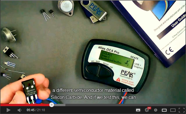

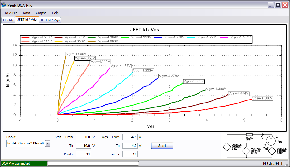

Kudos to Jeremy Siddons of Peak Instruments UK for extending the Atlas 75 firmware flash for Sic depletion. He had an auto new software reminder the other day, but with a bug for depletion Mosfets like DN2540 that we reported back. He fixed it in no time. When we mentioned that the device knows nothing of Sic depletion Jfet he asked for the reverse and forward PN junction graphs. Now a new update bell rang and what do you know, it recognized and traced the R085! Traced it in the very confined limits of mA and few volts it can of course, but it gives Vgs(off) for 1uA and Vgs(on) for 5mA. Basic matching for Vgs in other words. Interesting how it shows like a small triode valve in the wee region of the traces though. Don't mind the wobbles, its the software driven CVS play and the Semisouth Sic reacting. If two samples trace close in this small signal area will they usually match higher too? Don't know, but I have seen it in power BJTs as a good probability, when the fully traced matches on a Tek matched with the same samples on the Peak.

Very nice variation and also great for my headphone use ( similarly to l'amp with 30V supply)
I would expect the custom PapaFET to be the best tweaked one for audio.
Actually the unobtainium Yamaha sits are slightly better, according to Nelson's article in Linear Audio.
Oh, salas, I have the same Peak tester/tracer: does it recognize the sony k82?
I tested mines with other tools and I have a pair that were really close and would like to trace Em with the Peak (this weekend hopefully)
That K77 has the most flat 45 degrees going curves indeed.
It should do K82 with firmware 9 because it did so with the R085. Just download the latest software from their website. It will reprogram the unit and update the PC. If it does not, email them. They are happy to try cover weird semis.

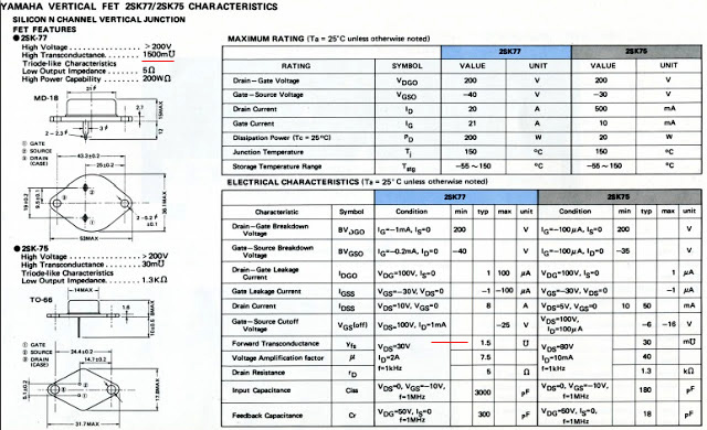

Maybe that black 2SK77B monster with the screw terminals? Because the regular 2SK77 was 1.5 Siemens in Yamaha literature for 30V 2A 1kHz. When NP showed 2 Siemens for SIT-1 custom part in the SIT-Nemesis article.
