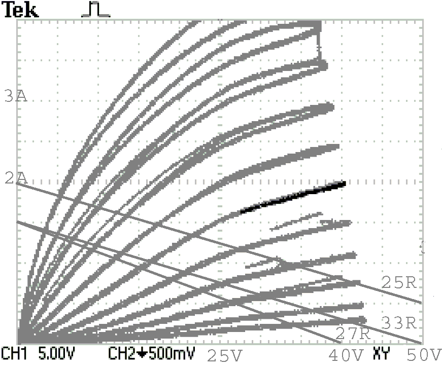

Yeah, bit tetrodish but bell like kinkless. Has a rather small triodish area though. Was it |1V| gate bias stepping on the chart you posted by the way? Or less, 1/4 maybe?
Maybe 30-40 ohm Drain R?
Looks rather alright.
Not that triodish me thinks. You having shown enhancement parts brings to mind: when about to trace those CREE C2M0080120D?
R065 is depletion mode and similar to R085. Expect it to look similar with similar tracing conditions. The Cree come in May, acoording to Digkey or Mouser. Cant remember which, without looking. Cree is cheapest option, so hopefully it yields similar results.
I know, I guess the bigger question is about whether or not there are two parts. My understanding was, that the R065 was depletion mode, but as you both pointed, traditionally the E in SJEP, stands for enhancement. I was aware of this, just expecting the other. I find no datasheet on the SJEP065R55. Either way, if you look at the datasheet for the two, you see very similar characteristics. My curves for the R085 look like Mike's, but i am unable to go out as far as he does, due to tracer limitation. IF you are thinking to play with them, I have 4 R085 I can send with your boards. I nhave plans for them, but based on current work load, i want be getting to them any time soon. I thought a F1J using them as LTP seemed interesting. THats what I was going to try as well as single stage ACA.
I found my notes on that one. Those were .1V steps starting with -4.4V.
Thanks Michael. Looking forward for when you will be tracing the CREE. Which is a normally available new and economic part.

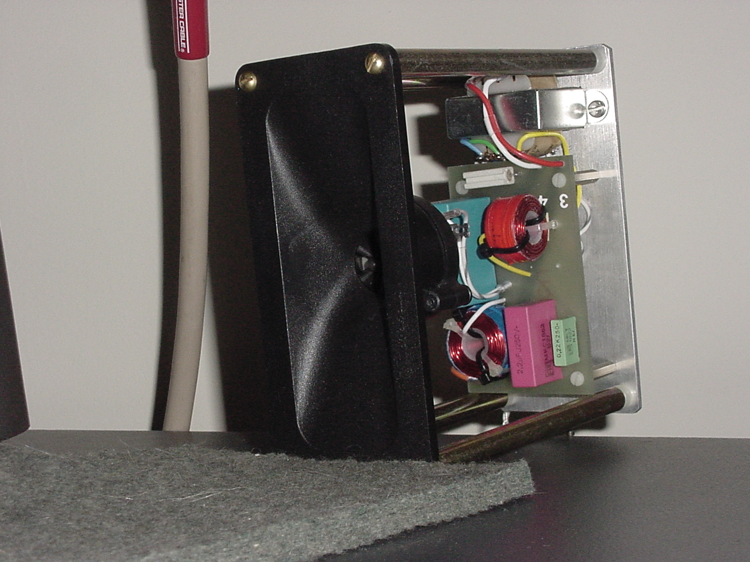

The piezo is attached to a combination interface/cross-over /attenuator to form an integral self-contained super-tweeter unit.
Piezo drivers as super-tweeters is a sadly neglected topic of experimentation and consequently a rich vein to mine IMHO.
Hiraga did devote a couple of pages to piezos in 'Les Haut-parleur' with special mention of the Motorola unit.
