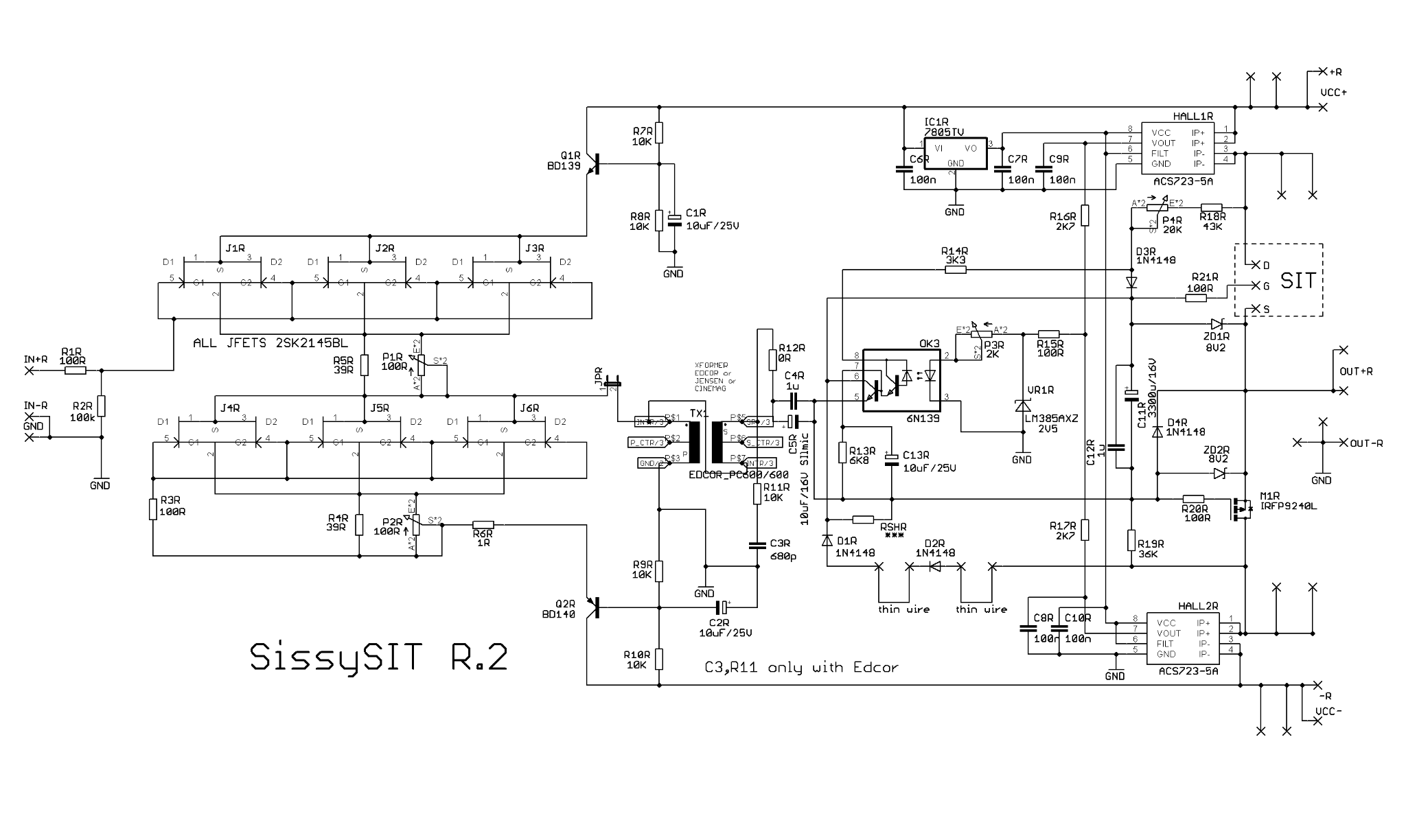

A friend of mine got a used R.2 version which I need to connect with an active front end instead of its buffer and trafo(so I need to disable this part).
I searched for the schematic but wasn’t able to find it..
Can anyone share a link with it?
Thanks.

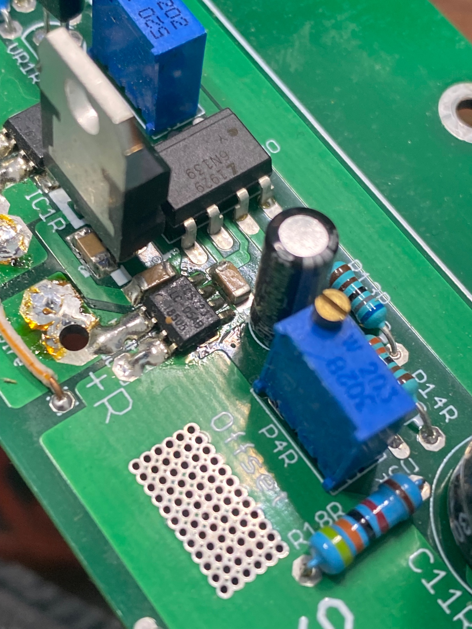

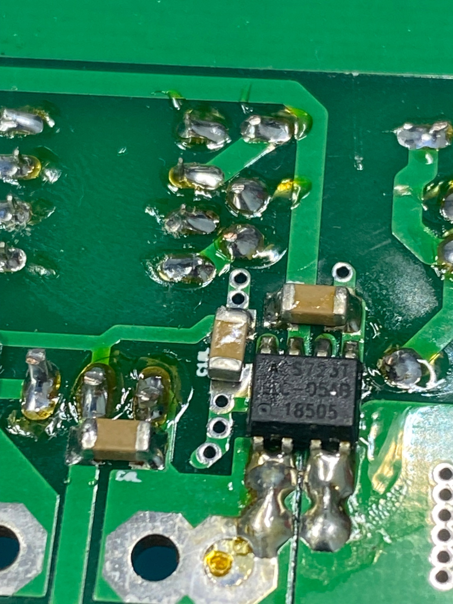

There are a few caps here and there that are not soldered so a general inspection and cleaning would be a must even if the previous owner used the amp like this.
