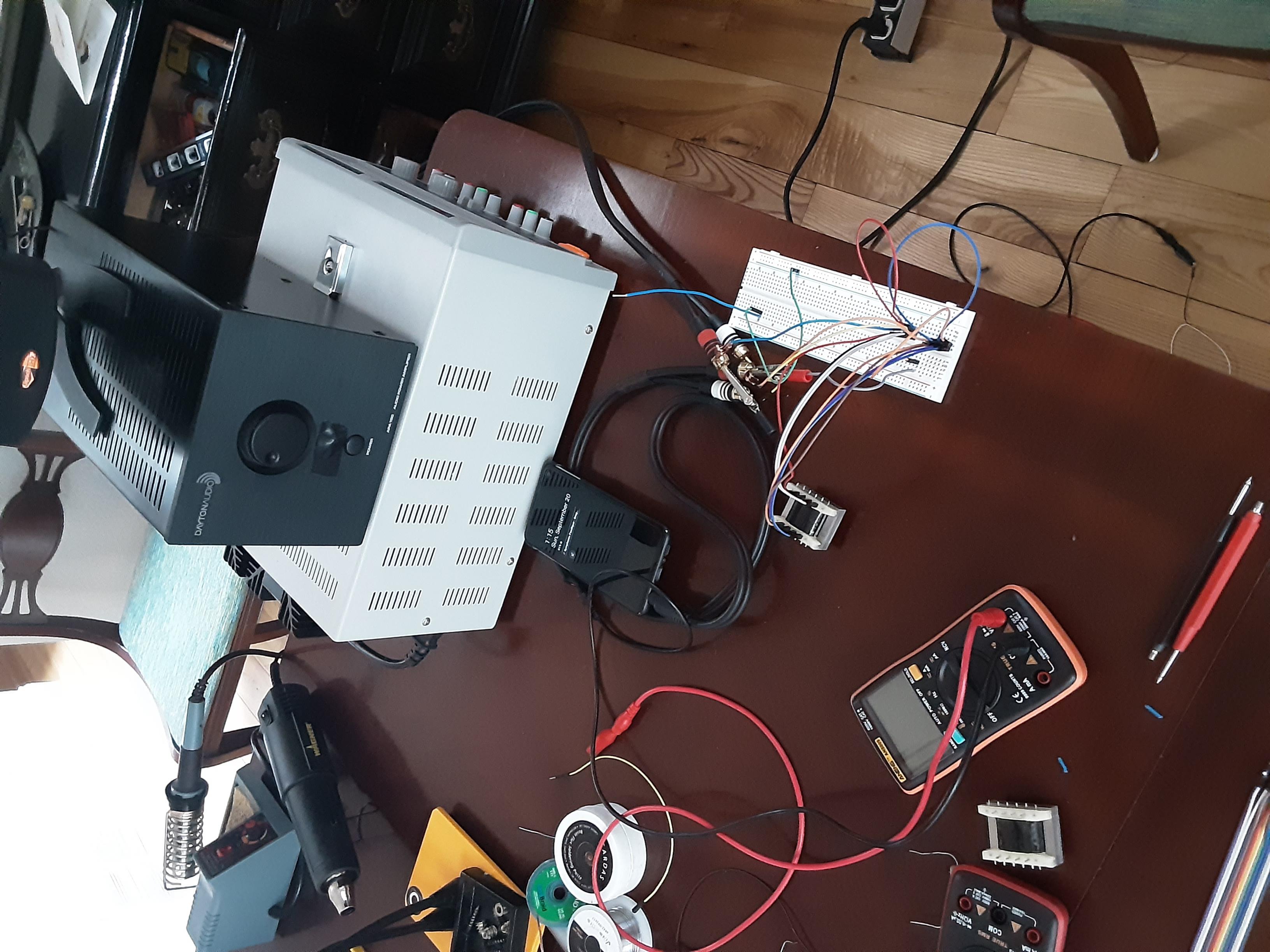

I was confused by seeing both the voltage source and the "IN" connection. I just got a testing circuit worked out on the breadboard and was able to directly show myself the effects of disconnecting various coils on volume. Super useful for pounding it into the dumb head.

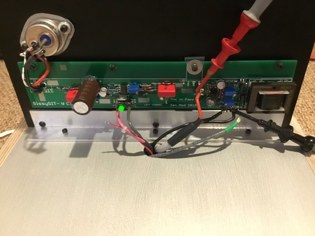

Some news on the SissySIT front.
It's finally outputting some fine music.
Adjusted a while ago, but waited for some iron to finish my preamp.
I must receive the finished front panel from Schaeffer in a few days.
Two blue LEDs to be installed, and bingo.
Thank you, ZM!
Thank you, ZM!

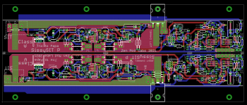

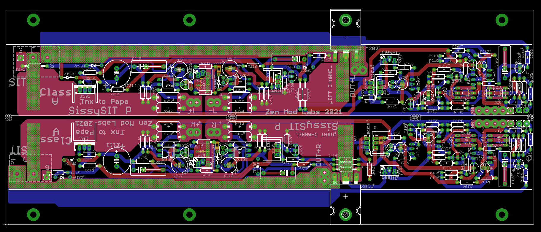

just for Botte's eyes, teaser of one amp with P suffix
I’m excited to hear more about this one
