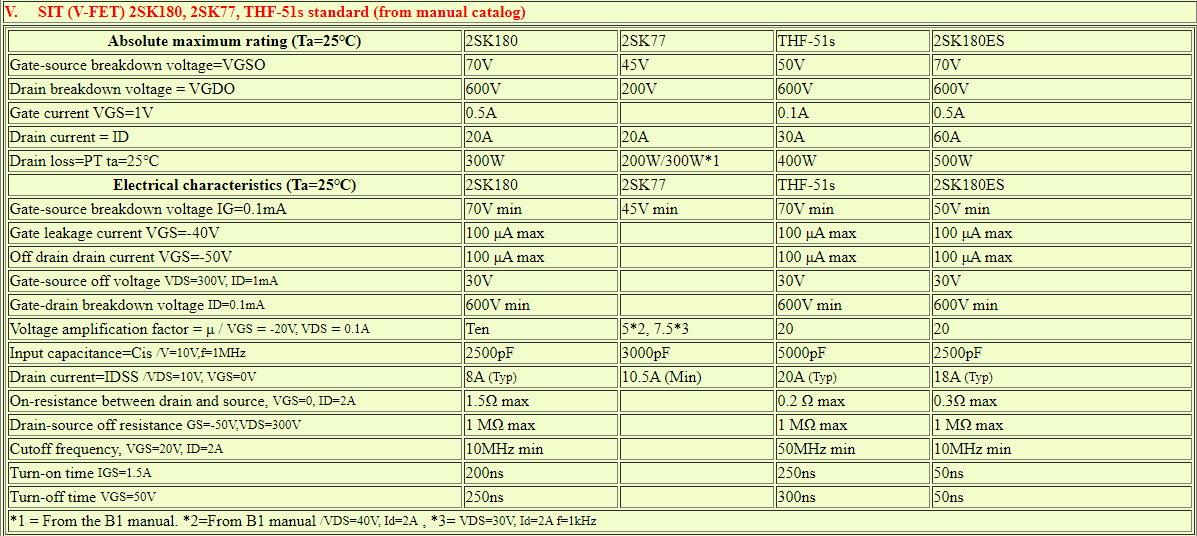

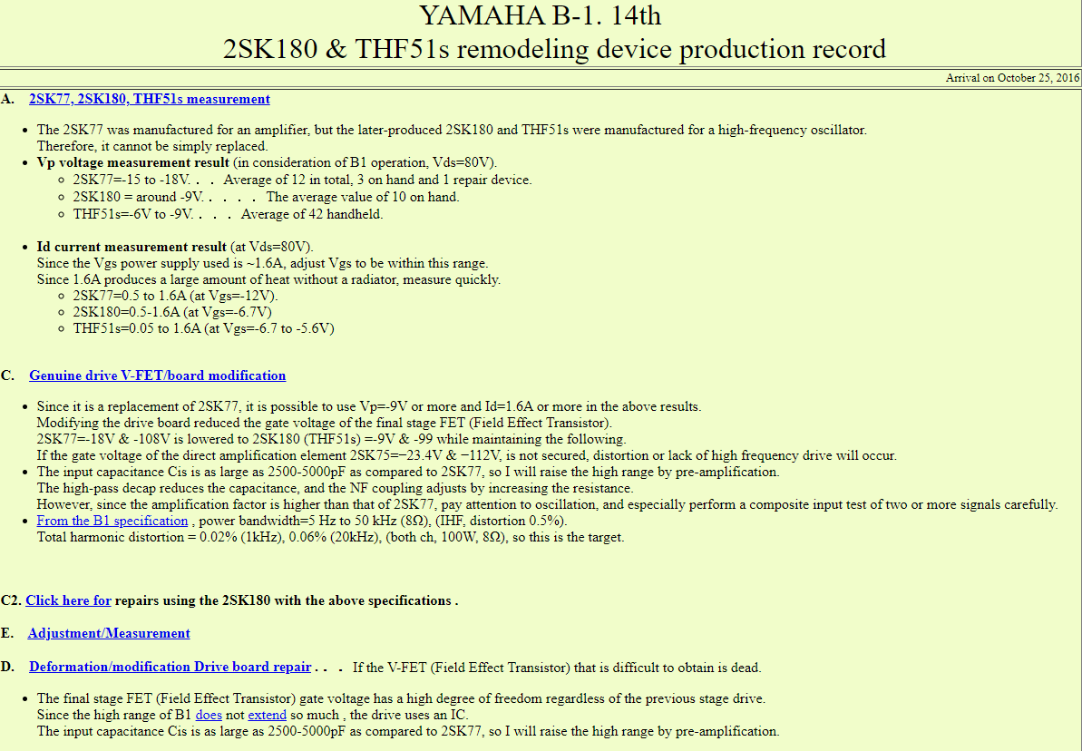

The link above is about servicing YAMAHA B-1 that came with 2SK77.
"The "2SK180", which will be replaced in short, has a larger drain loss than the genuine "2SK77" by 1.5 times, so it has a larger input capacity. THF-51s, 2SK180ES is even bigger!
Because of this, if you simply replace it, the high frequency characteristics will deteriorate, so you must change the circuit. Circuit changes are not included."

Ofc, Papa already has mentioned something about this (or something similar): Post: #221 Hockey Puck SIT 2SK180 by Tokin source NOS
"I haven't tested the 2SK180 for bandwidth, but it appears comparable to the
2SK182, more likely the THF51S. For the latter, common source operation from
600 ohms gives -3 dB at 10 KHz, so you will want to divide that 600 ohms by
whatever ratio gives you the rolloff frequency you want. 100 ohms might do it.
The output of a 2SK170 buffer would definitely do it." - Papa
It could be something else that also "deteriorates high frequency" or at least rolls off -3dB at 10kHz. I am sure all of this is already considered in the SissySIT and I should just go for THF51S.
