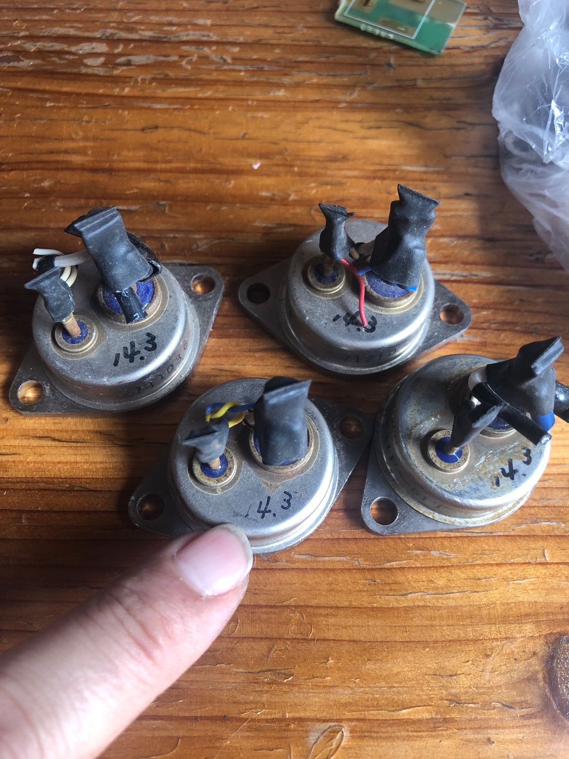

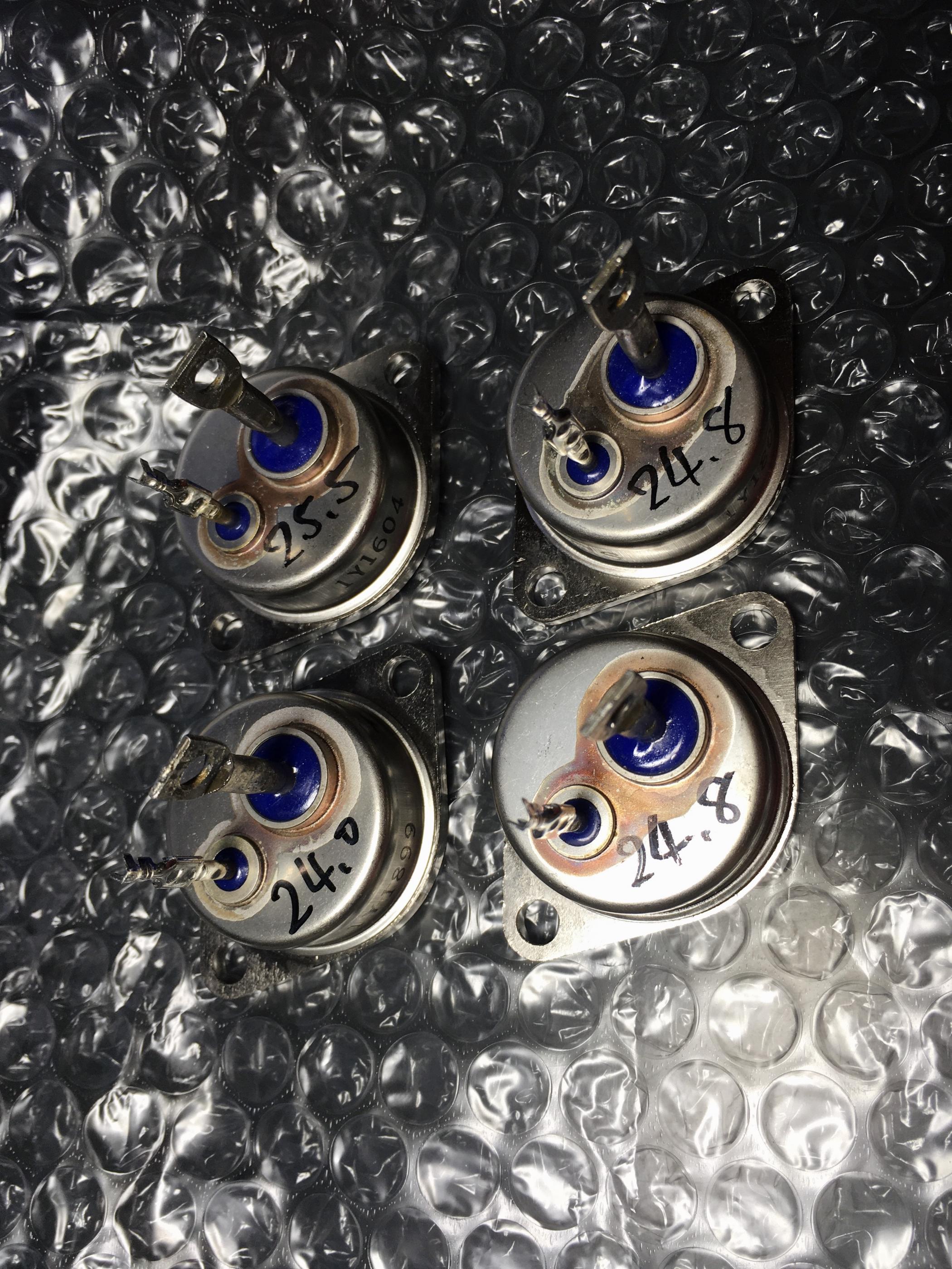

All tests are completed, please see the picture
THF-51N TOKIN and 2PCS 2SK180(The length of the foot is only half. The friends who need it can send e-mails, only 2 of them are normal
No impact on work)

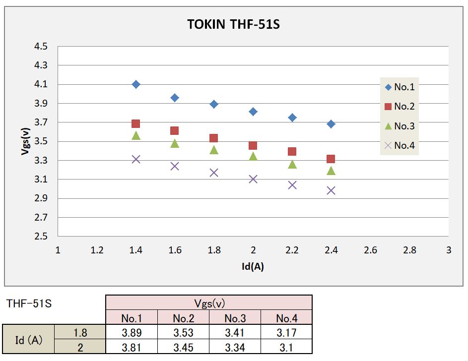

I recently got interested in VFET / SIT and bought 4 THF-51S at a local shop.
To make sure they work properly, I measured by the post#81 method.
Attached is the measurement result.
Question
I measured Vgs while changing Id quickly.
It takes less than 1 minute per one to measure and change 6 conditions of Id.
The SIT is fixed on a heatsink(200x200x70mm) and has no temperature rise during the measurement.
Post #81 directs heatsink to be fan cooled, but I didn't feel the need for fan cooling.
Is there something wrong with the measurement?
Should I wait till it get hot?
Thank you.
