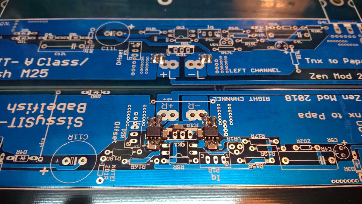

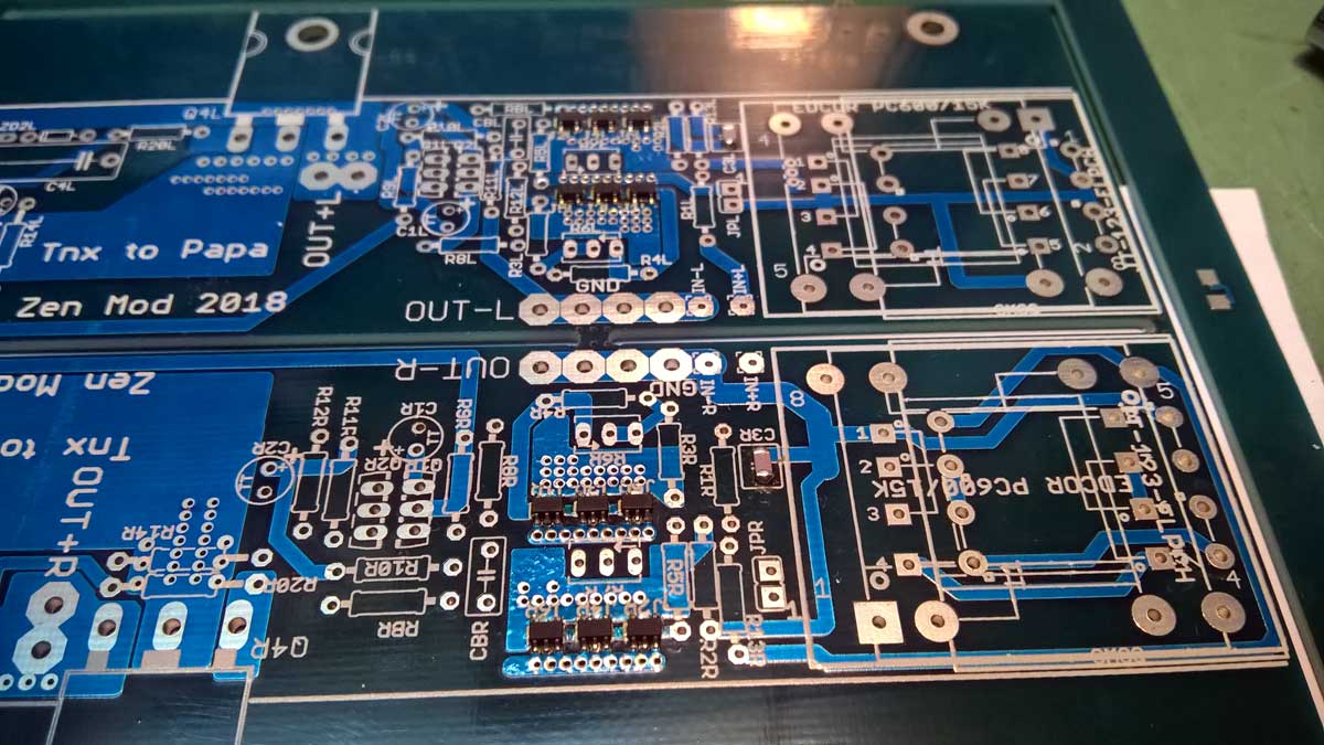

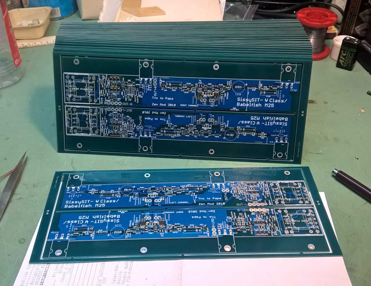

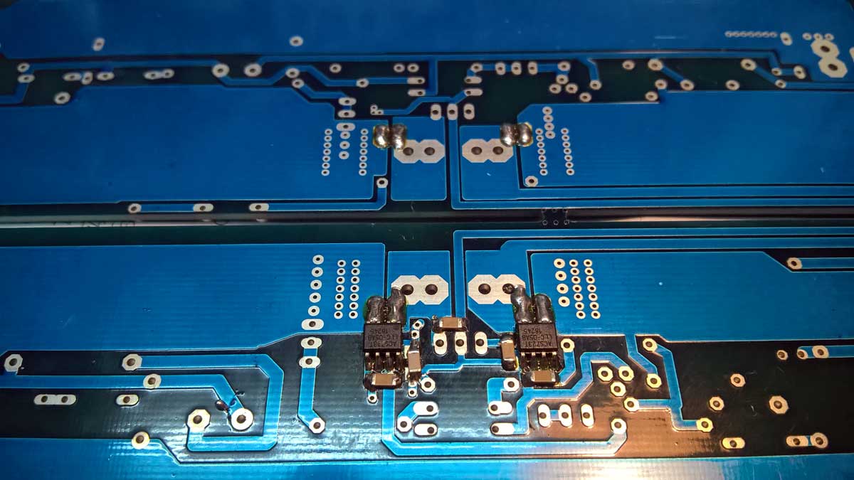

finally done with soldering tiny bugzzzz on first batch of Babelfish M25/SissySIT
pcbs
tomorrow some cleaning of no-clean flux (just for giggles) , then on to sorting parts and packing
also start working on tutorial , to ease some things for Greedy Boyz
pcbs

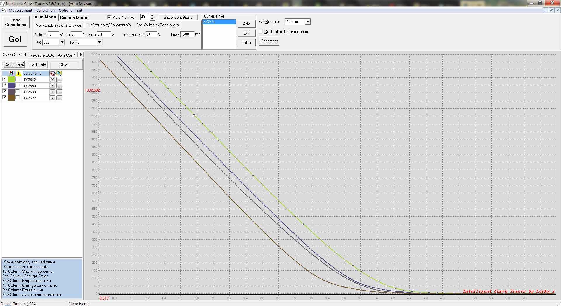

I got 4 trannies from Japan and curve traced them. What I get is different from what I have seen here before. My Sits show very low negative (so in fact very high) Vgs - roughly about 1,8V at 1A Id, which is what I want them to bias with. Even ZM once wrote here, he considers virtually all THF-51S convenient for this amp, I would feel better if I got some confirmation that mine might work. Otherwise I would ask Pras1170 for a pair.

no reason that they can't work in SissySIT circuit
problem would be that situation is opposite - SIT gate going down - too close to mosfet's gate , thus no place for opto bjt .....

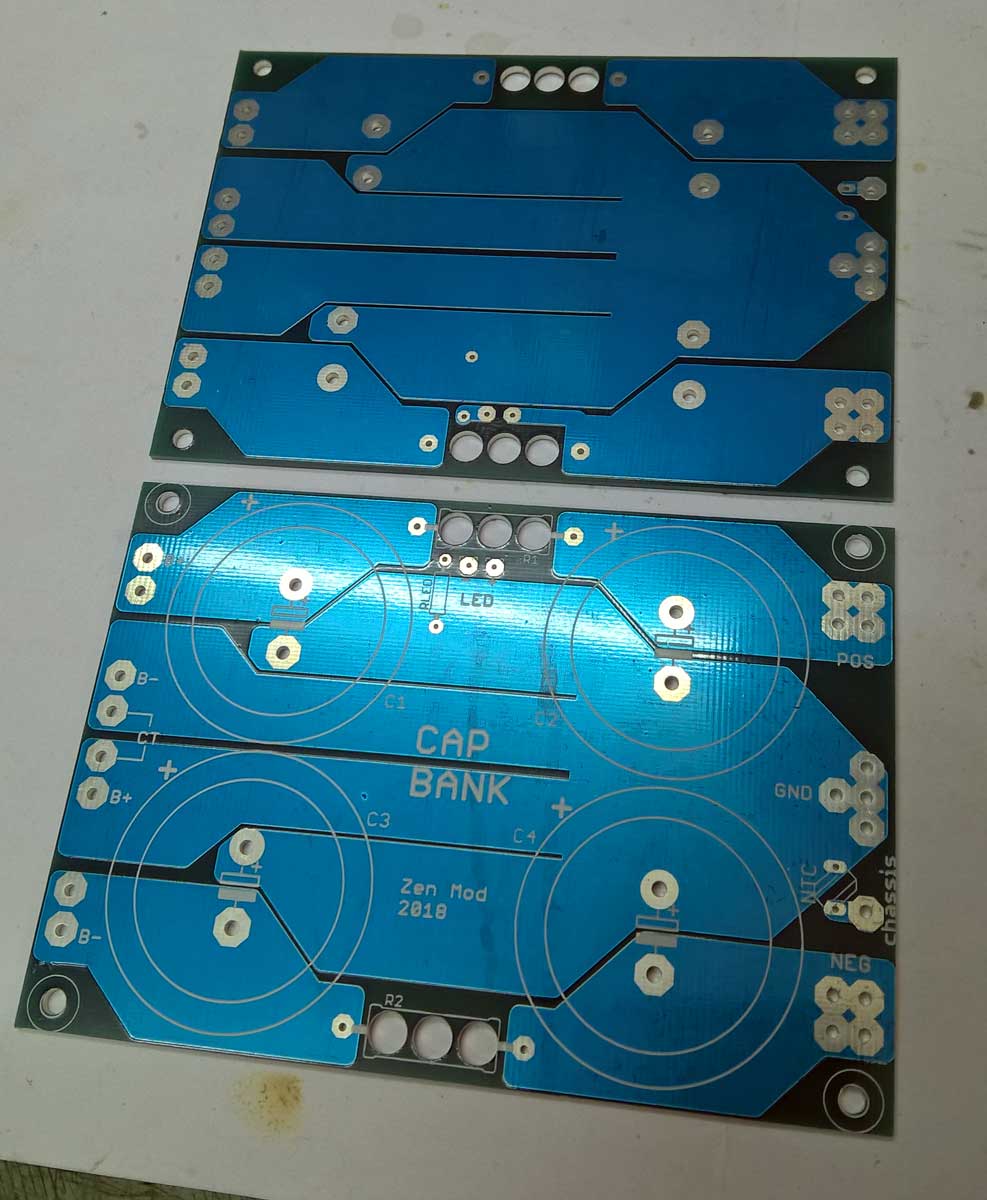

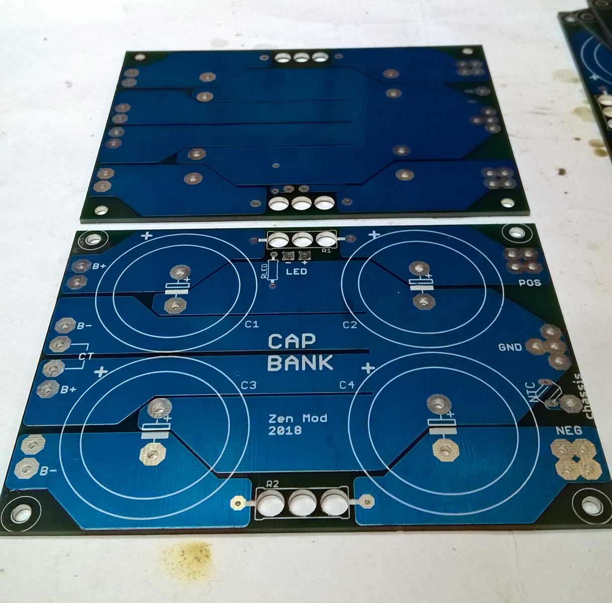

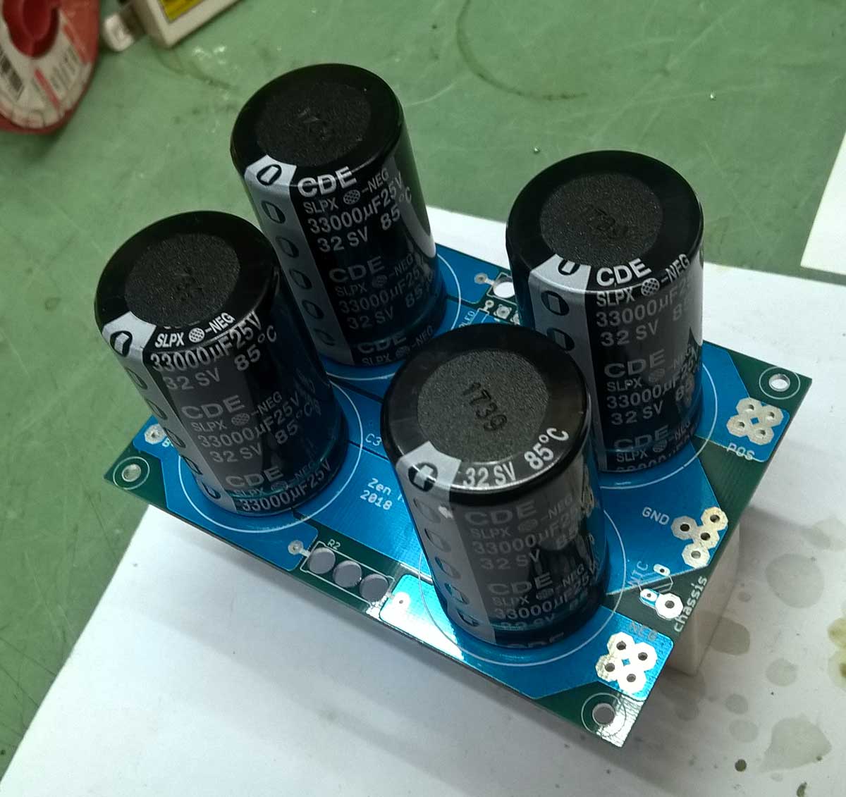

Nice 🙂 Will you do dual mono or stereo supply? I like your PS PCBs, quite compact.

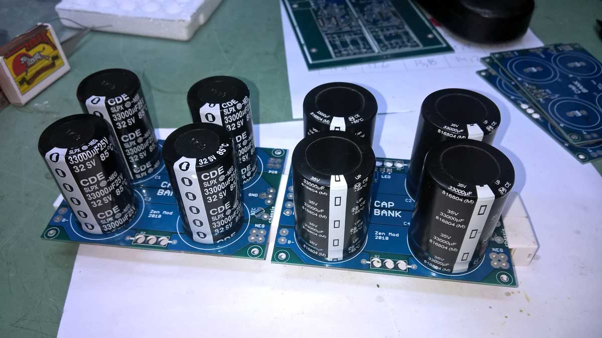

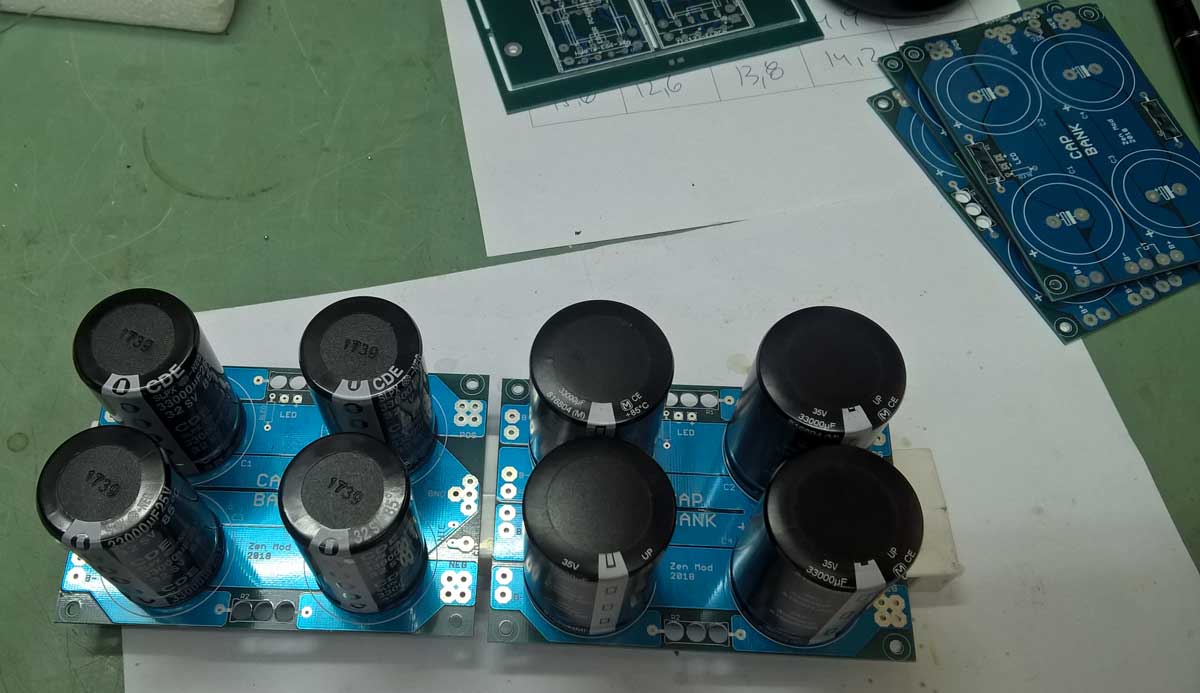

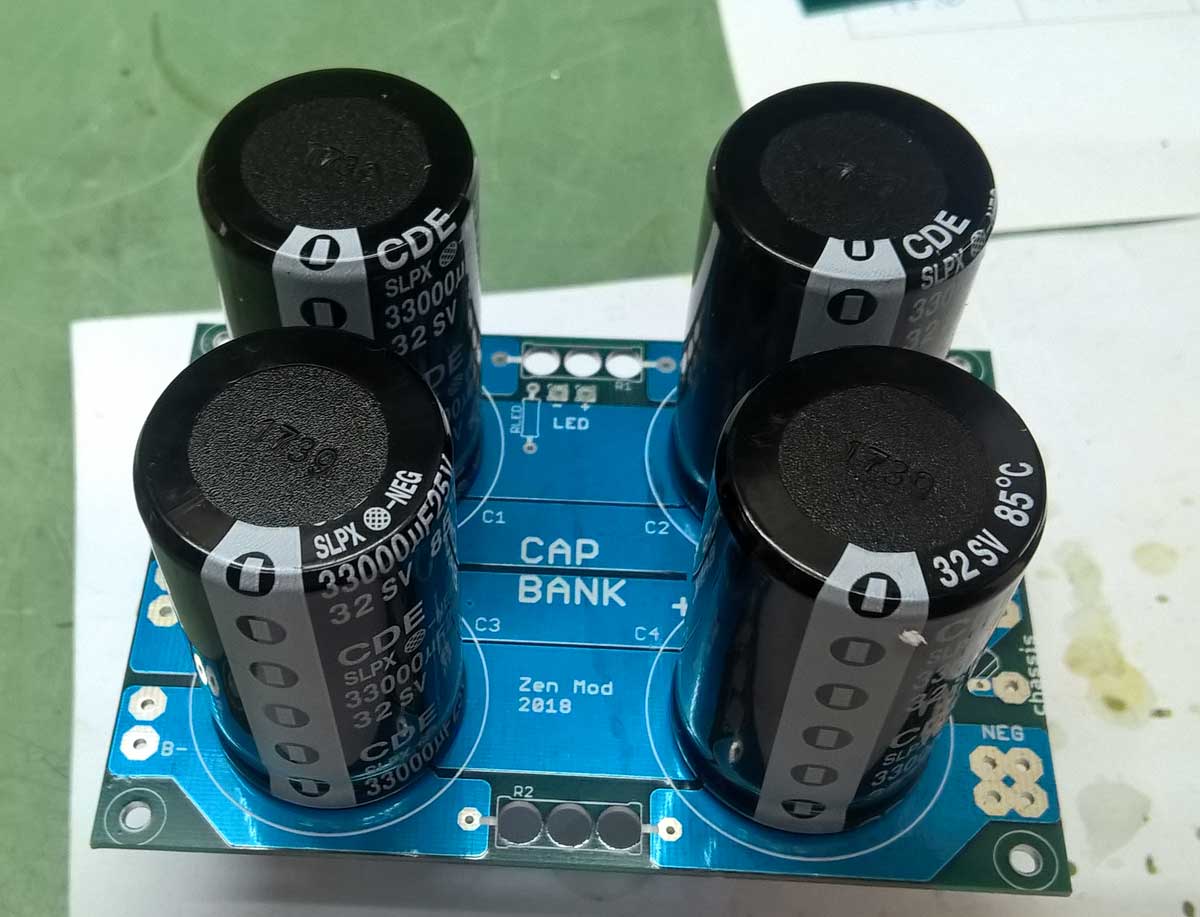

just for giggles , ZM's specimen will have these NOS ones inside , 2 per channel , hopefully supplemented with motor run bypass
