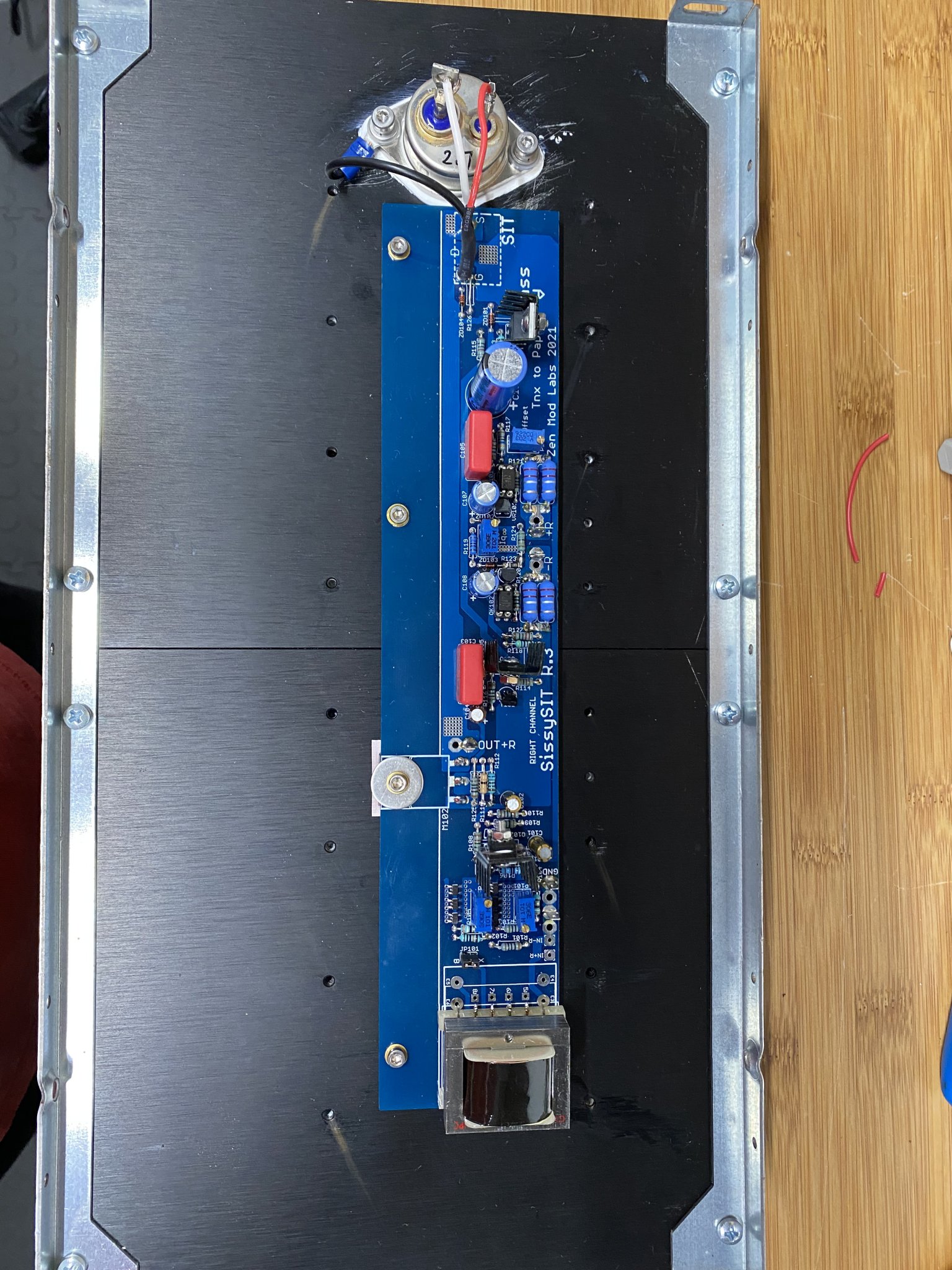

Zen Mod, is there any reason I can’t reverse the boards so that the wired connections are at the top edge, instead of the bottom?
The only issue I can think of is that the MOSFET is at the bottom in my configuration, and the heat be a problem as the board covers it. I have mounted boards and SITS, but wanted to check before reconstructing the chassis.
mount them whatever way you wish, if situation of mosfet isn't completely wrong - being on top area of heatsink, instead on line exactly at 1/3 of heatsink height
more precise - if heatsink is 30cm high, best place for semis is at 10cm from bottom
