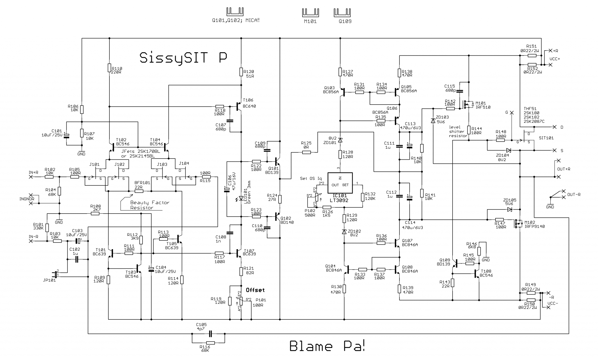

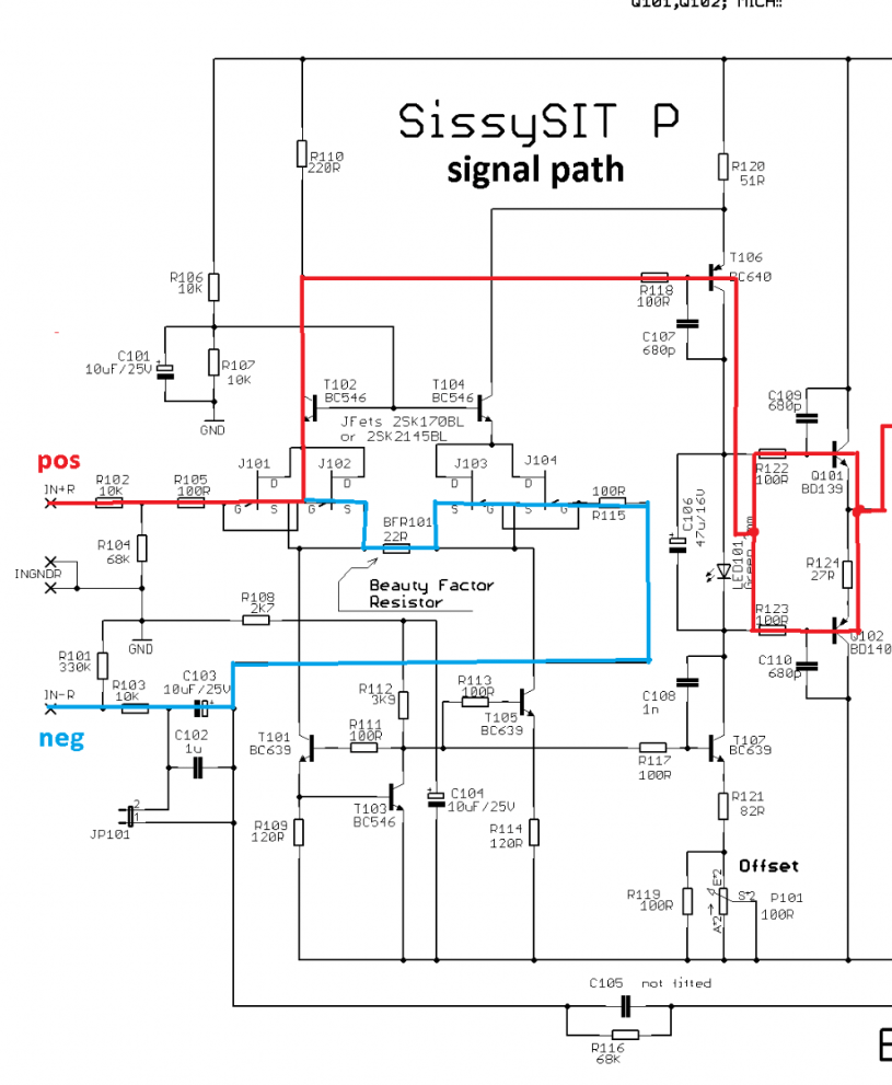

Hi ZM,
I would like to try something with my current DAC. It has balanced output floating 2.7vdc above gnd. Say I want to feed it directly into the Sissysit (or XA252), balanced. Could I then jumper C103 so that both positive and negative signals DC are offset leaving no or very little DC offset at OS?
I wouldn't do that
install decent caps or xformer at output of DAC; they're much lesser evil than taking any circuit out of optimal range of operation
I tested everything possible with any of my amps, but I never tested their power On/Off behavior with inputs moved to different voltage level
I mean, you can do/try that, but I can't promise anything
Thanks! I will follow your advice, this does not sound like a decent approach to pursue, got it😉
