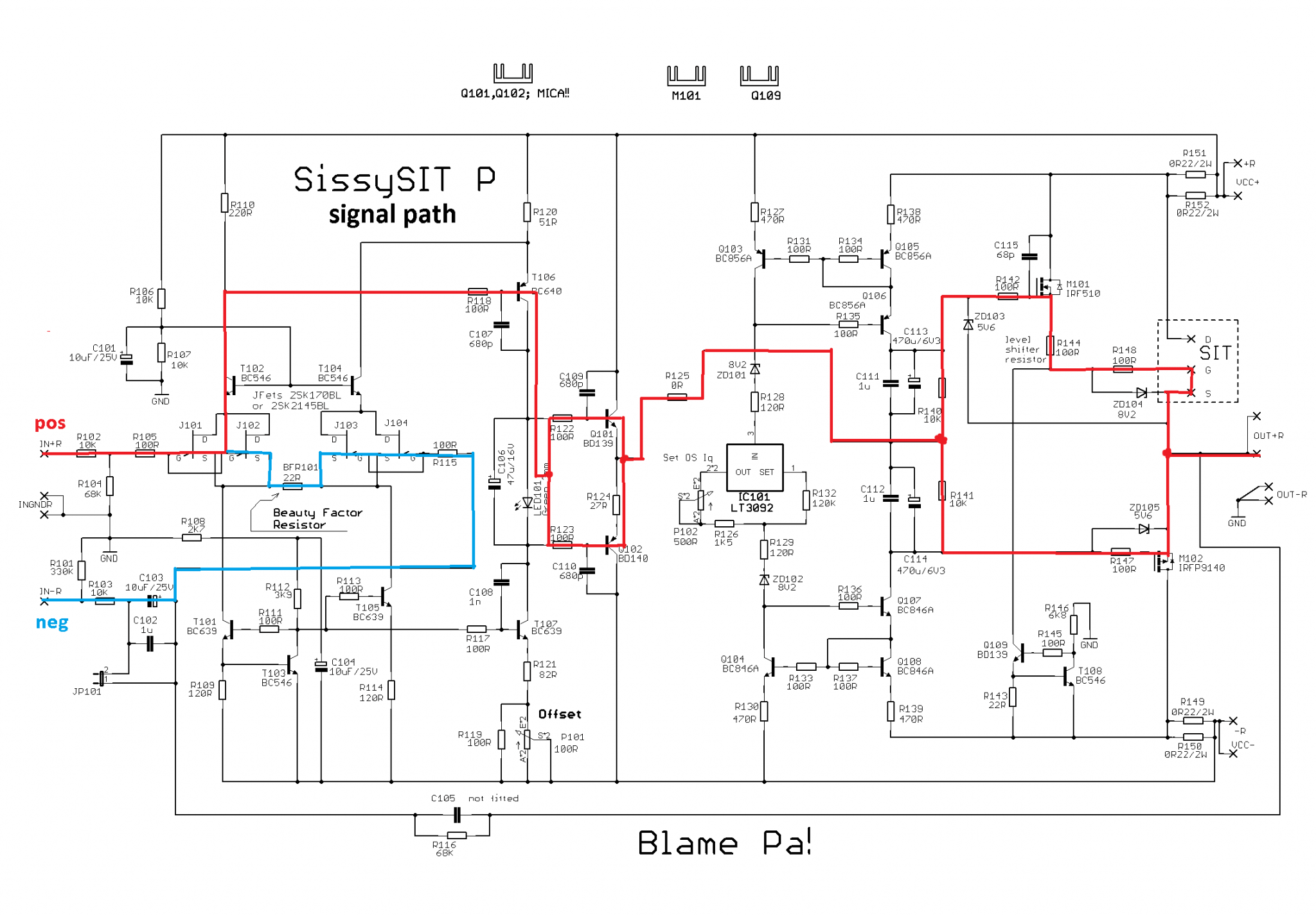

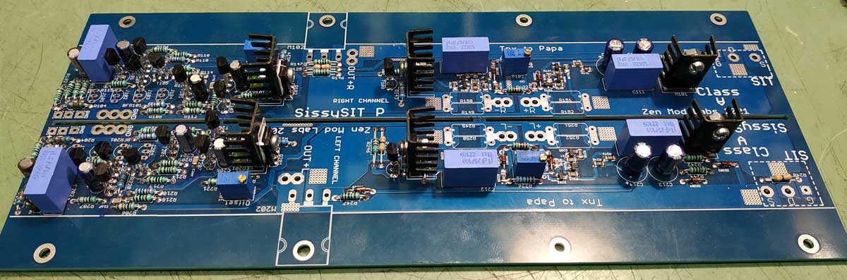

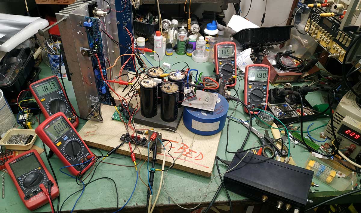

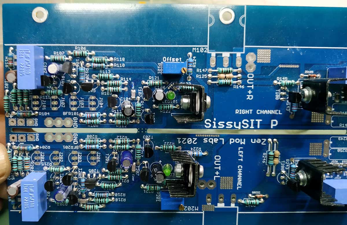

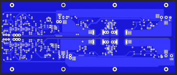

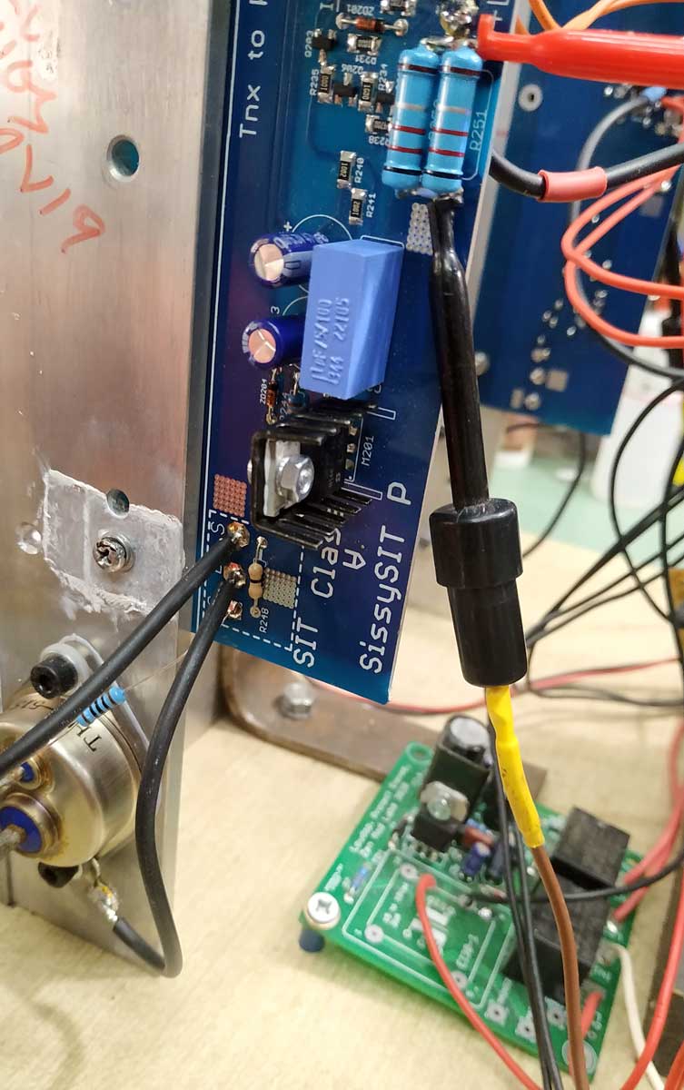

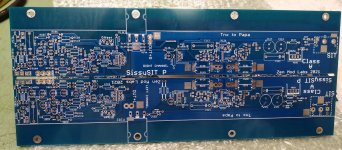

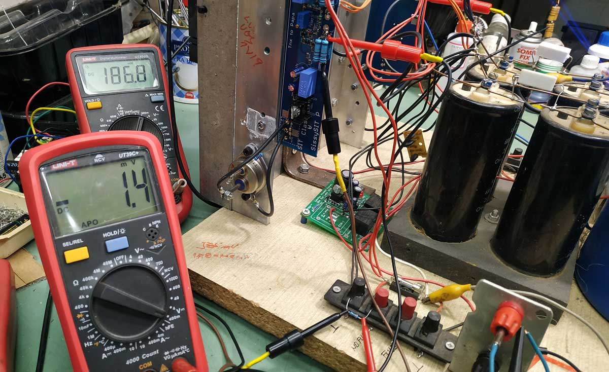

Well, anyone at least partially partial with my omnipresent babbling, knows about endless series of M2 derivatives, I made sorta recently
All of them having M2-like Front End (my biggest Fetish), so entire voltage gain got from autoformer, so no (overall) NFB involved
Also - all of them having second of my recent Fetishes - Square Law OS
Ok, that is line of unnecessary long line of M2 derivatives, difference amongst them being that each is having different quirk of OS parts

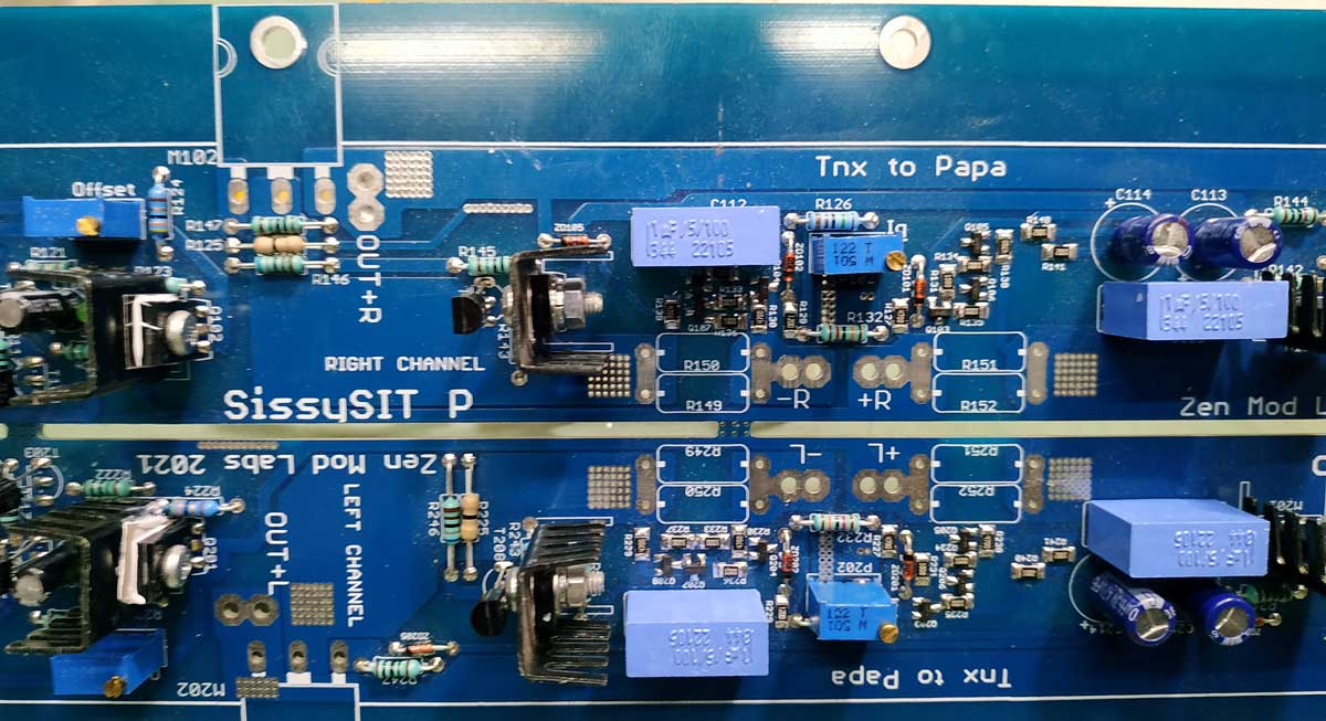

Then came next fixation point... when I concocted FE for Babelfish XA252, biggest part of invention was proper name for same FE - Plethora of Pinjatas ....... so I ( naturally) came to idea of making second totally unnecessary line of derivatives, now having Plethora of Pinjatas FE, and simply varying already proven SL OS iterations
This line having slightly different ( sorta mirrored/flipped/downundered/whatever) biasing mechanismus, comparing to older specimens, this one directly taken form Babelfish XA252
Comparing to older ones ( having opto between Mosfet Gates and fixed resistors from rails to gates), there are current mirrors from rails to fixed resistor(s) between Mosfet gates; result is better Iq behavior in domain of rails change, same as better Iq behavior in thermal change domain, and also firmer relaxation factor (Iq stability in dynamic domain; think recovery time if change occurs with long large signal)
Anyway, let's ignore Babelfish XA252 as first one, declare SissySIT P (P suffix for Plethora of Pinjatas family) as first one
Am I happy ...... yes! (this one done, so I can think of working on next
Confirming same amp sound character, for amps made without NFB and with Autoformer gain and amps made with sorta heavy NFB and active gain ....... well, not exactly a novelty per se

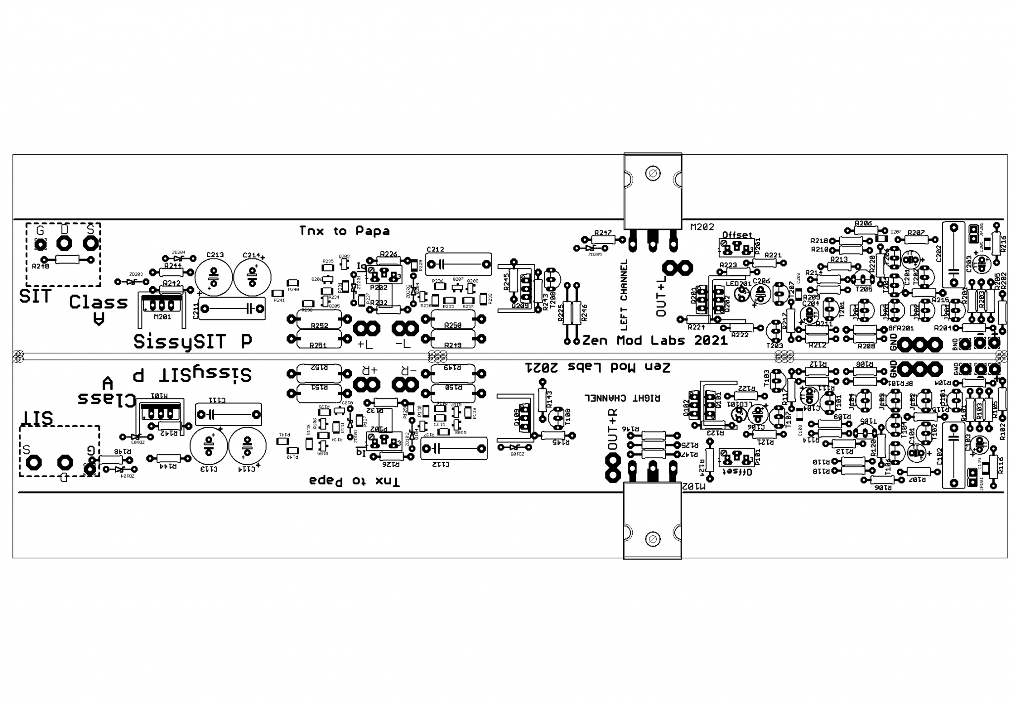

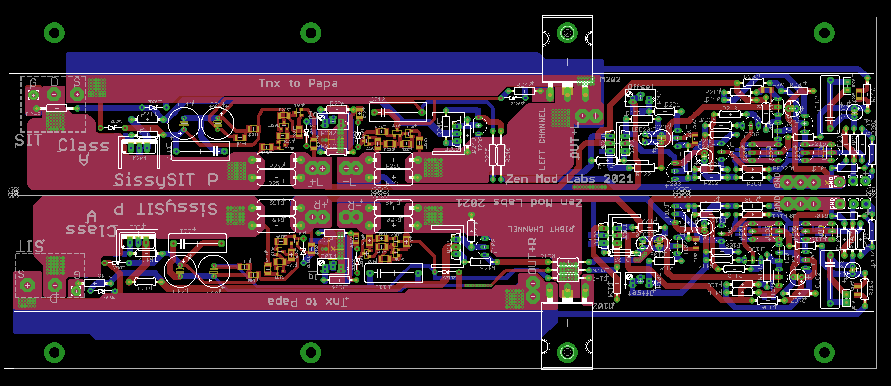

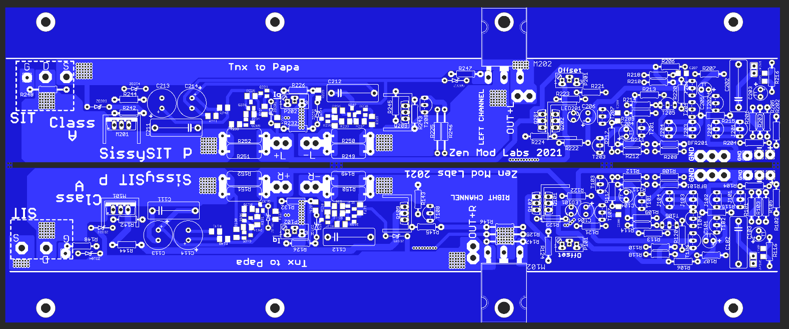

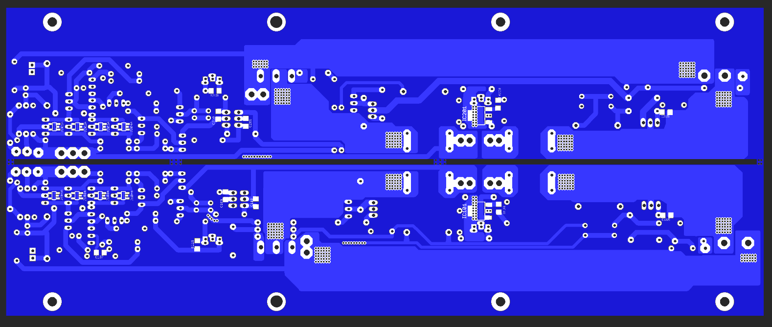

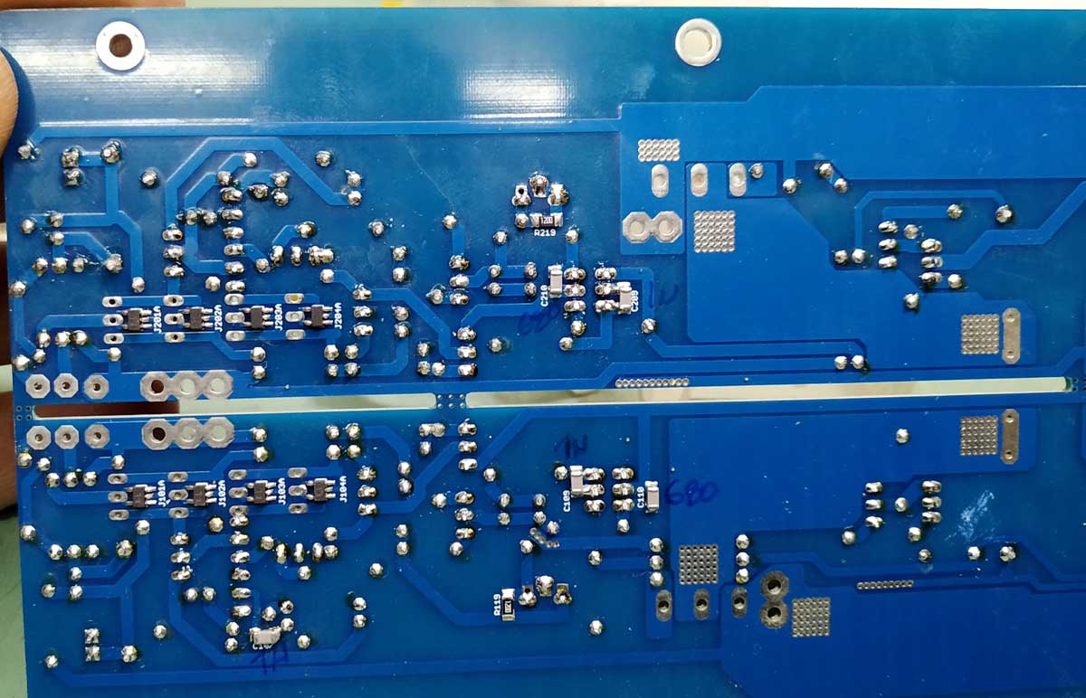

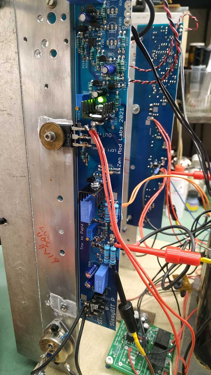

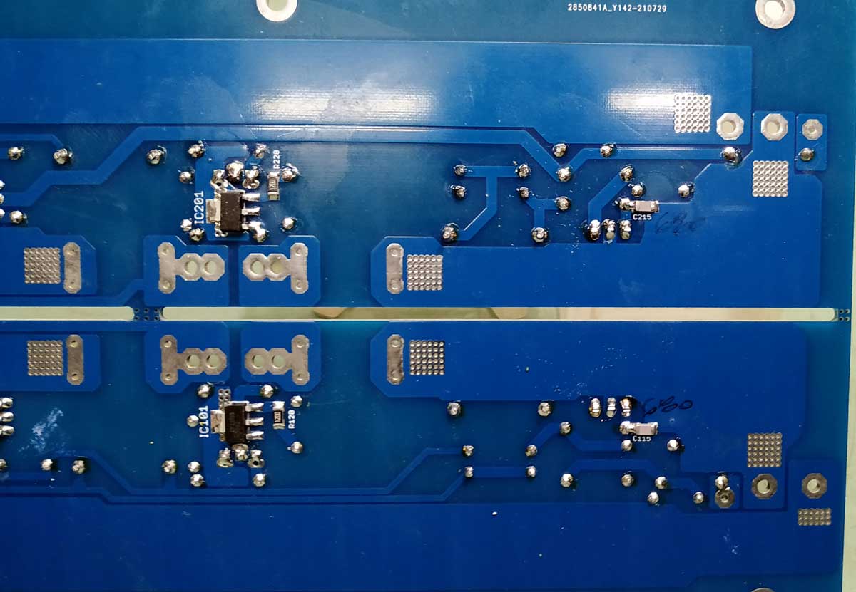

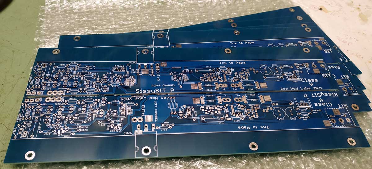

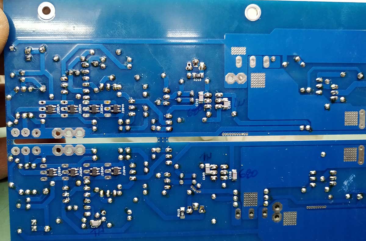

now some not so fancy pics
1/2
1/2

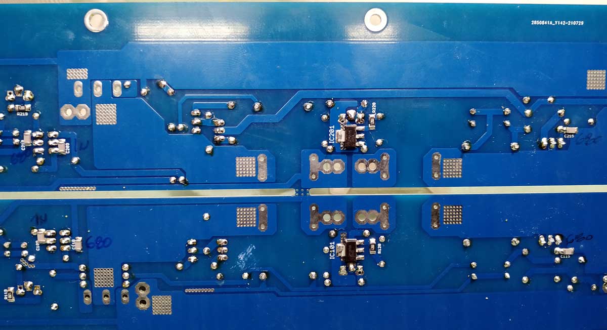

2/2

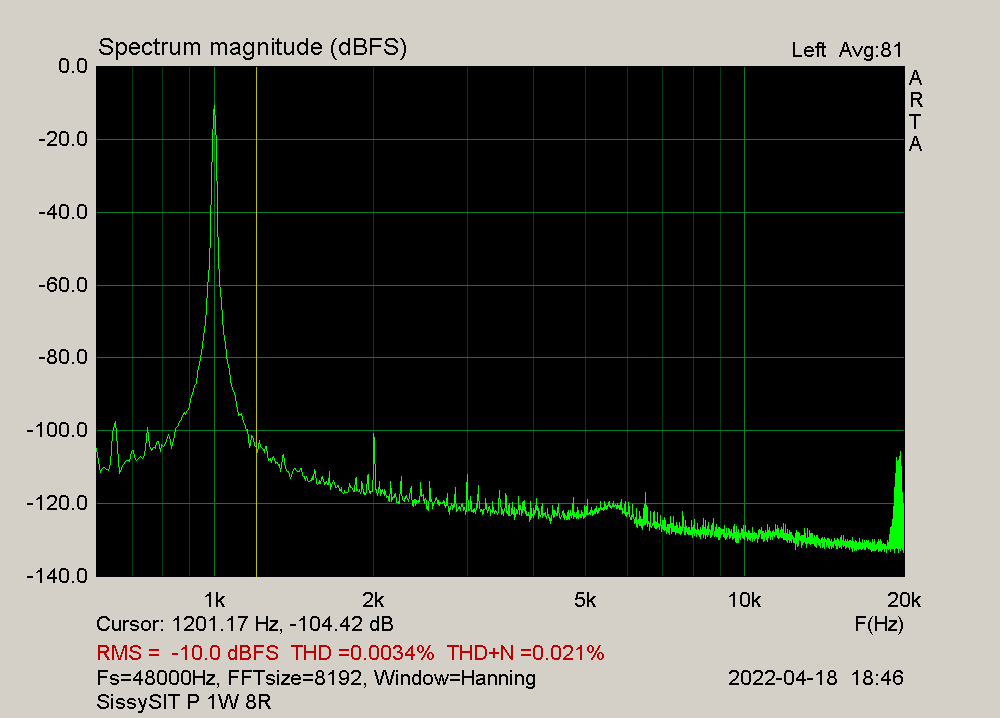

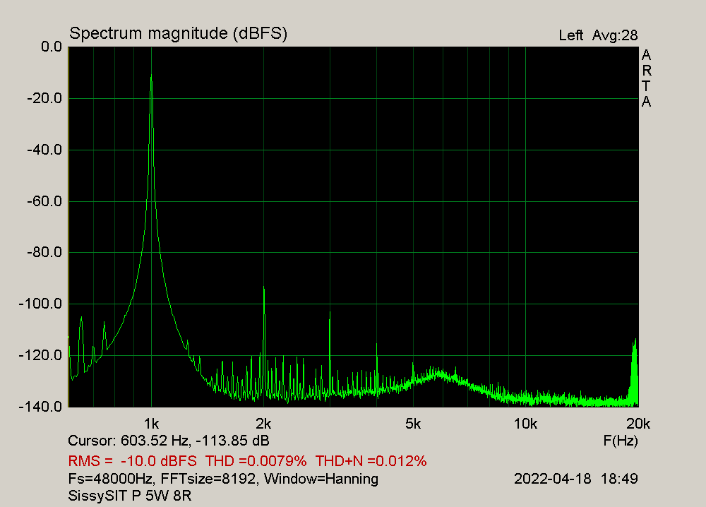

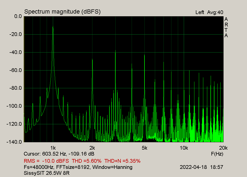

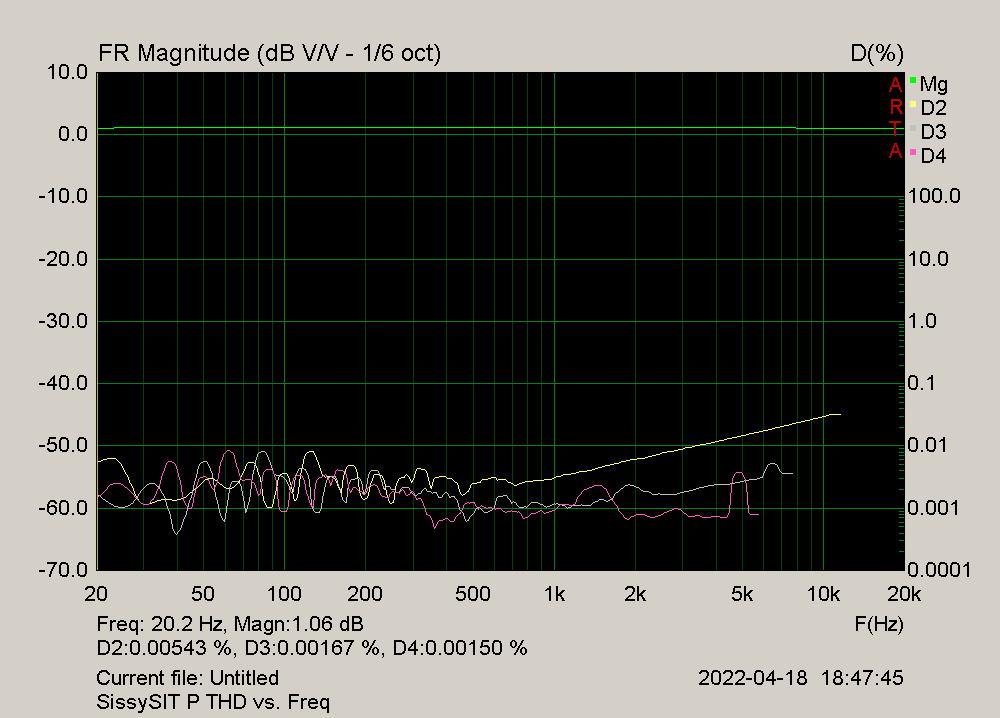

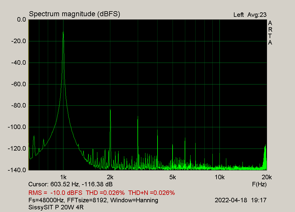

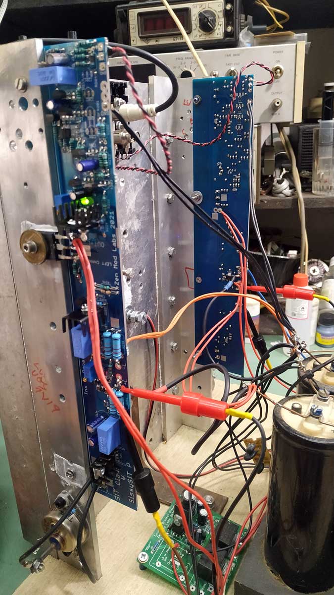

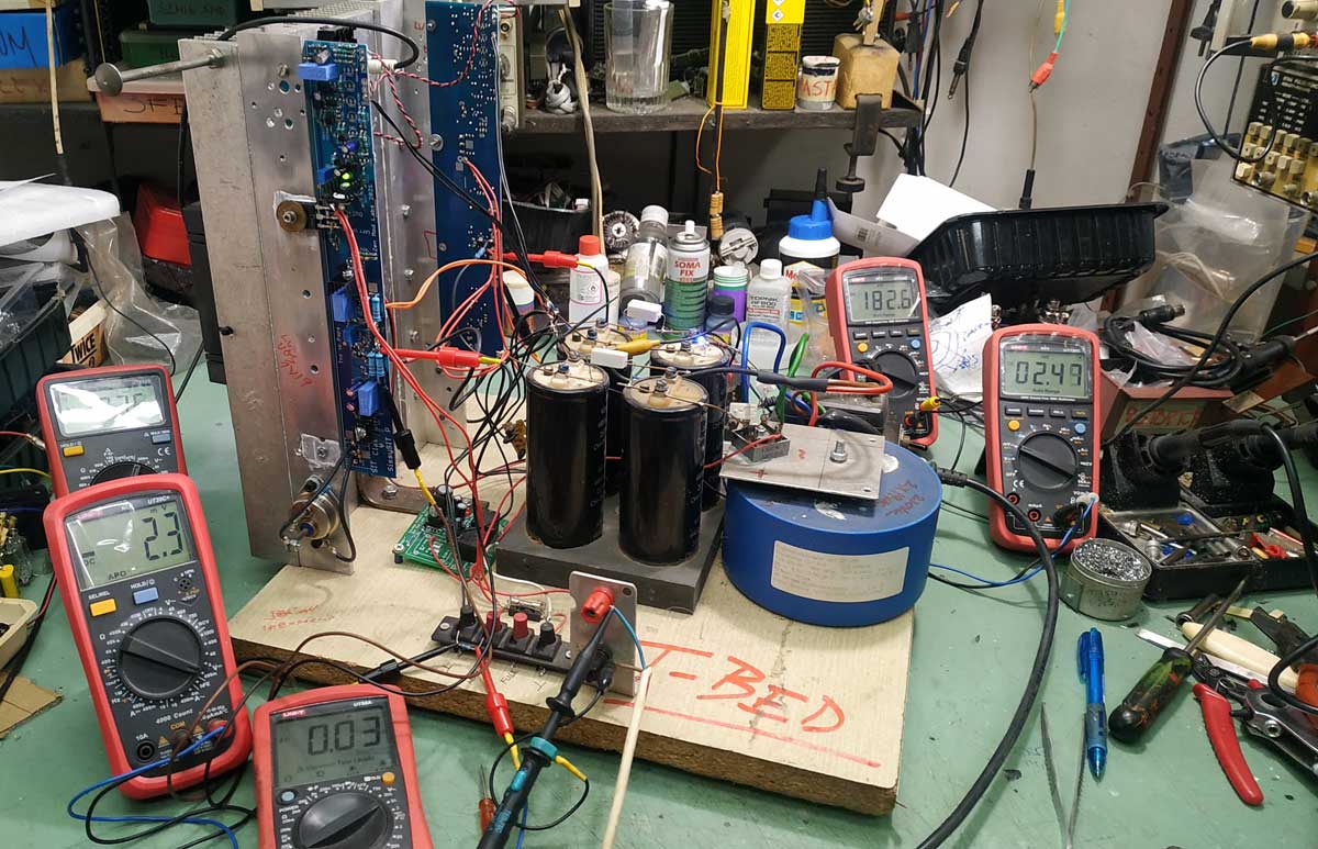

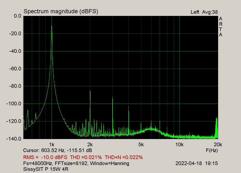

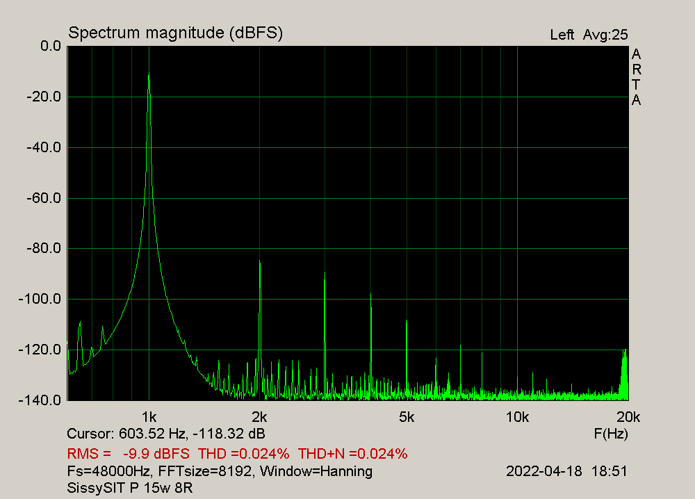

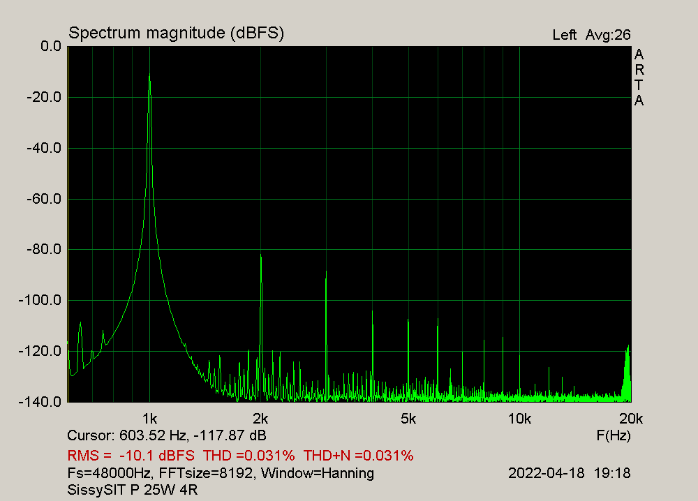

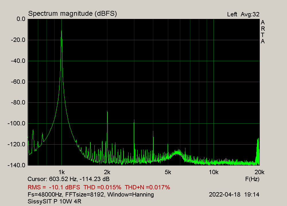

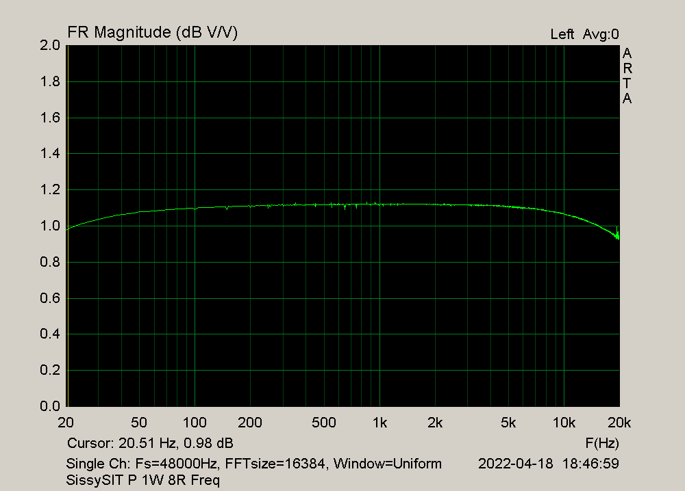

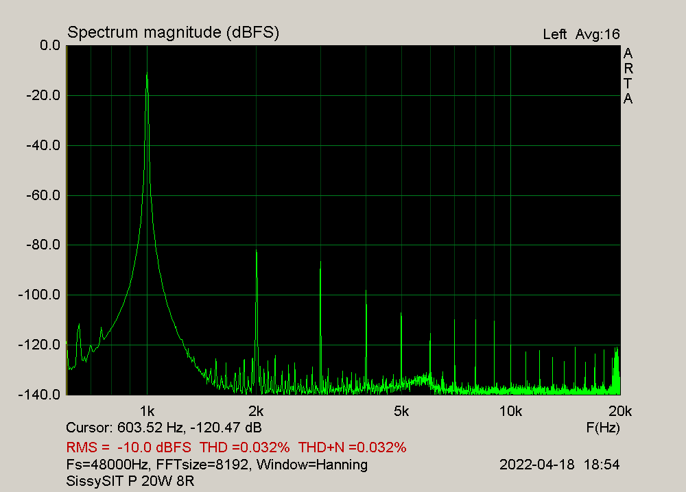

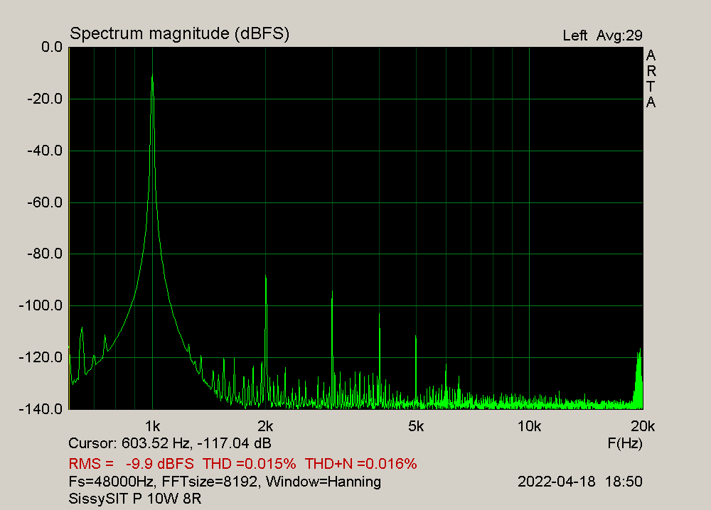

Proof is in da Pudding ( or how me Mom always said - eat your Porridge if you wanna grow strong and handsome!)
Rails +/-24Vdc-ish, Iq 1A7-ish
Load 8R
Load 8R

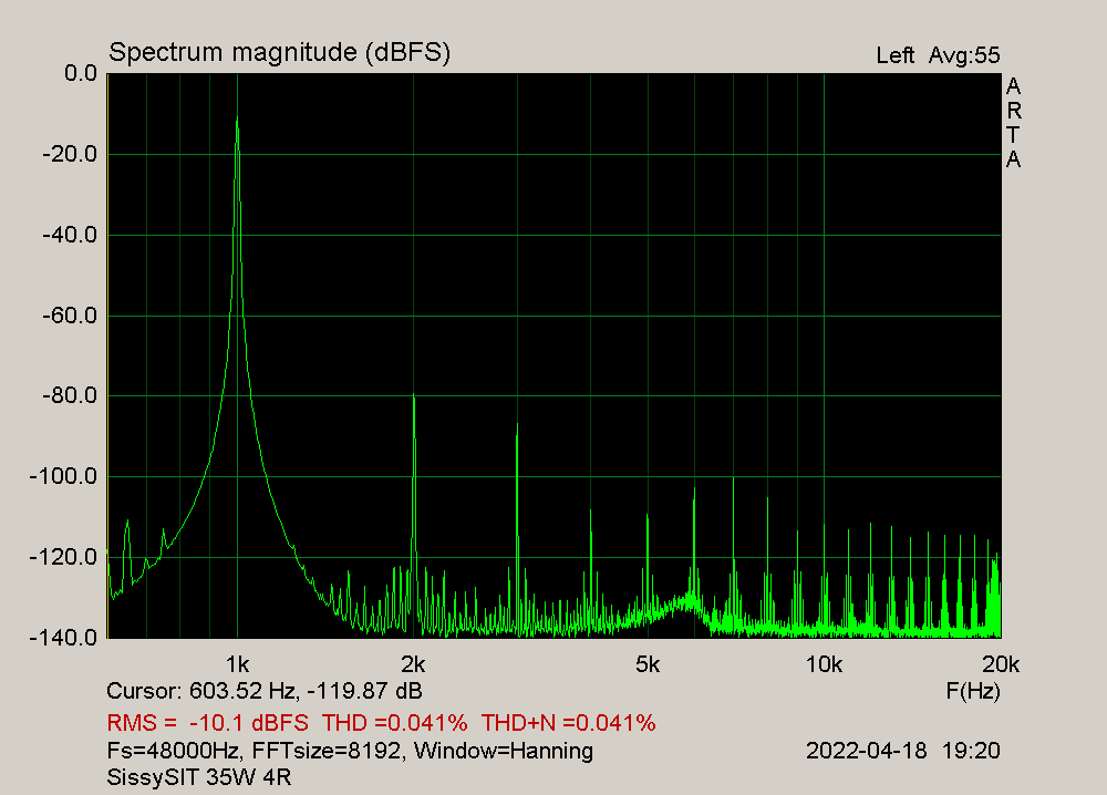

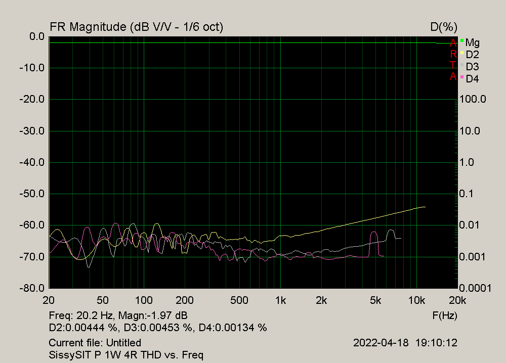

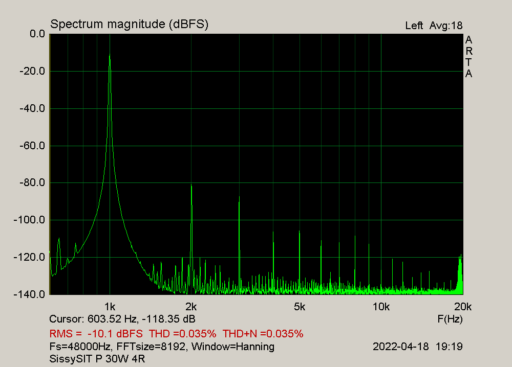

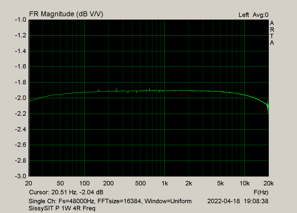

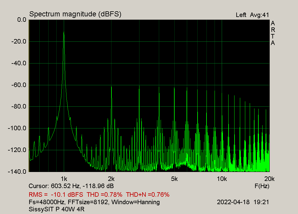

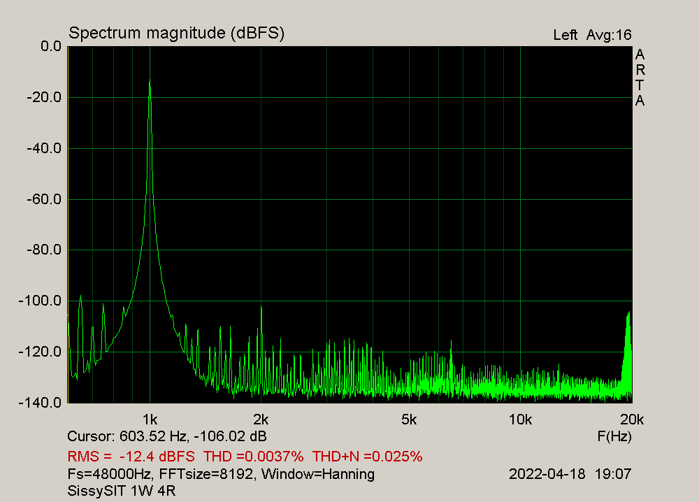

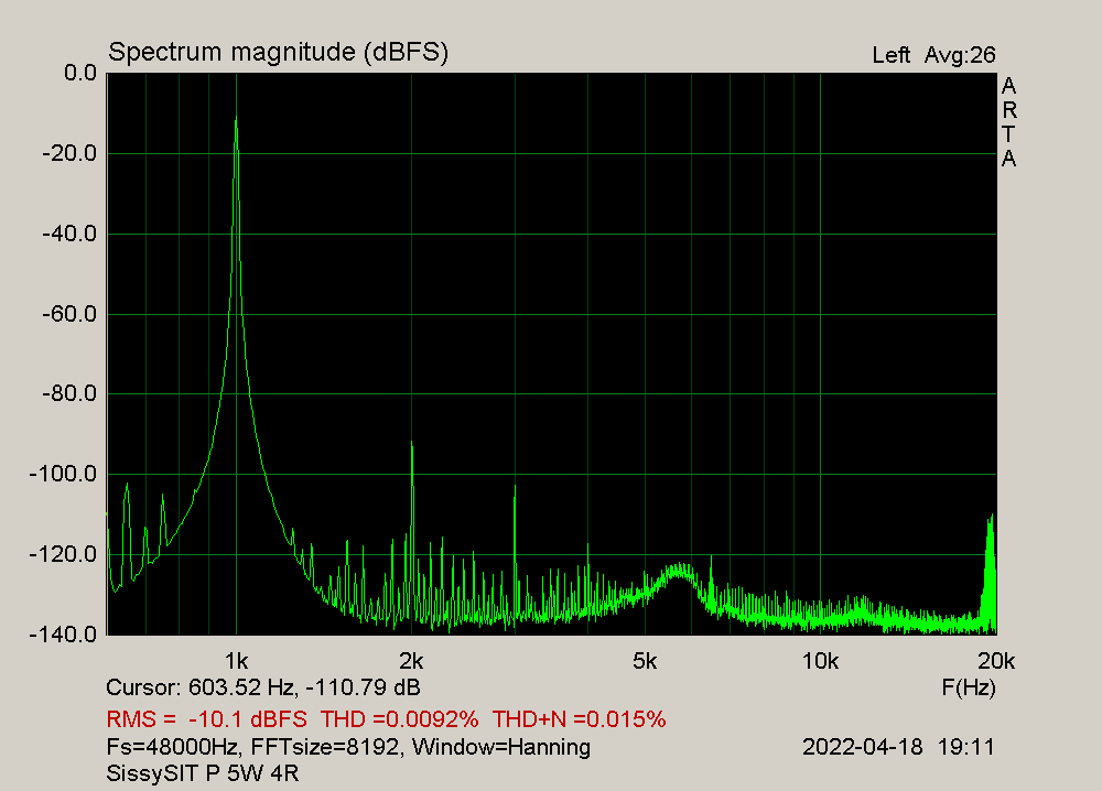

Second Jar of Porridge
same conditions, 4R load
How it sounds?
Well, as close Cousin ( younger one) of Babelfish XA252 SIT
Good enough for Mighty Moi

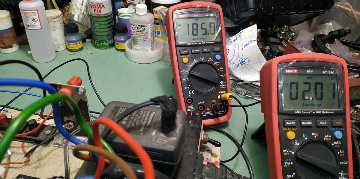

yeah, and it would not even call for change of R124
what's few mA up or down, between friends ?
oh yeah, ZM clumsy as always - R124 actually being 43R
still enough current, while not being overenthusiastic, heat-wise
(Uled- 2*Vbe)/R124
so (1V93-1V3)/27R=23mA
or (1V93-1V3)/43R=14.6mA

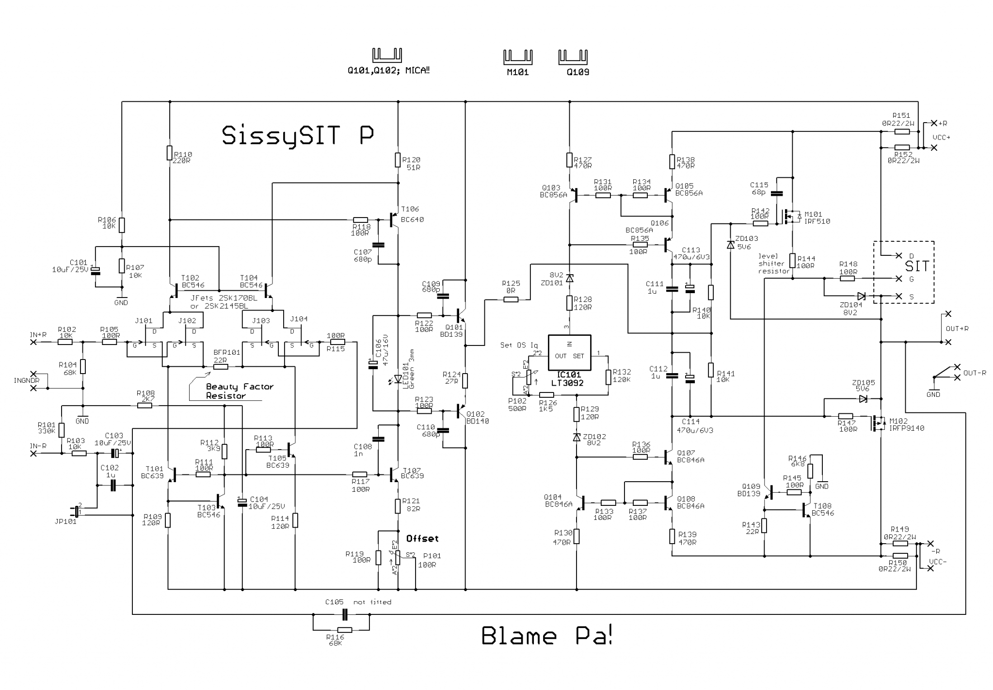

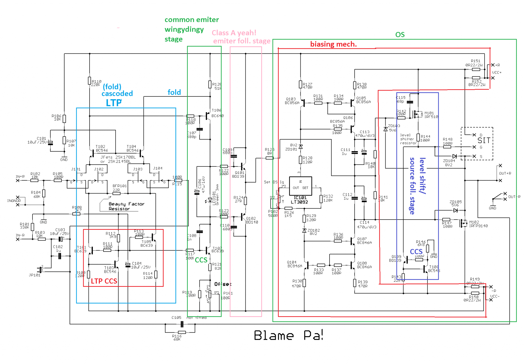

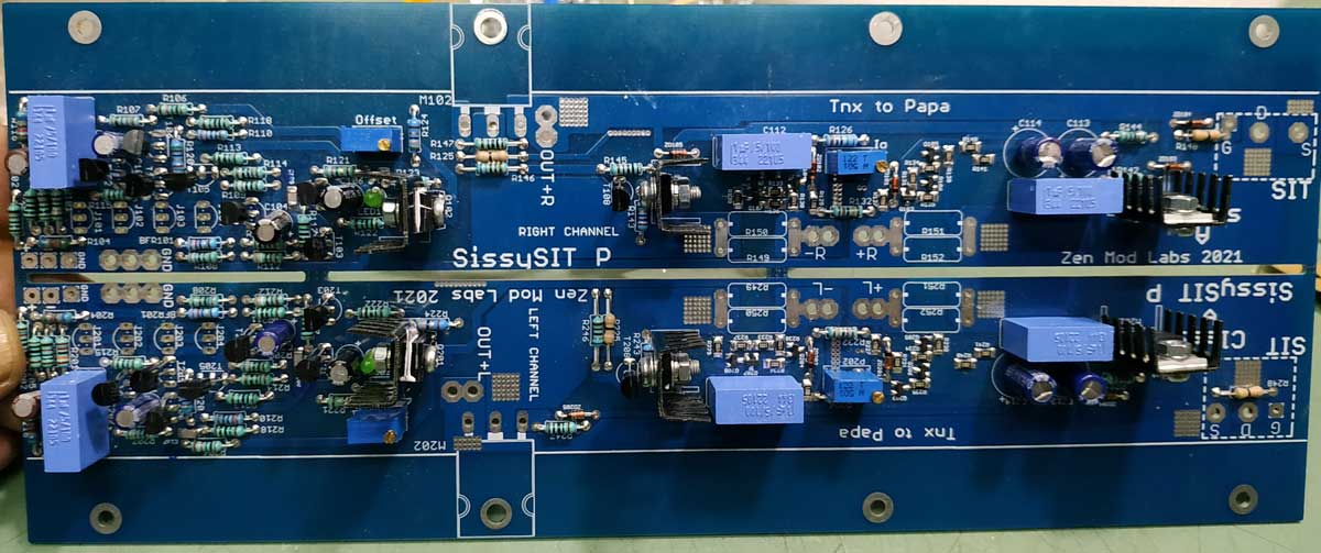

and, while in Office
SissySIT P block schm.
as Pa would count it , two stages, plus two half stages
( how would Dr. Haus comment ?
considering M2 derivatives, where we have - half stage, xformer stage, half stage ..... so by ZM Count - no stages at all!)
