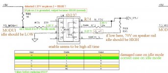

Till then , pls help me regarding: U4-6n137 - HIGH SPEED-10 MBit/s LOGIC GATE OPTOCOUPLERS - can I find it in some old switching supplies or anything like etc ? due it will take too long an online order.

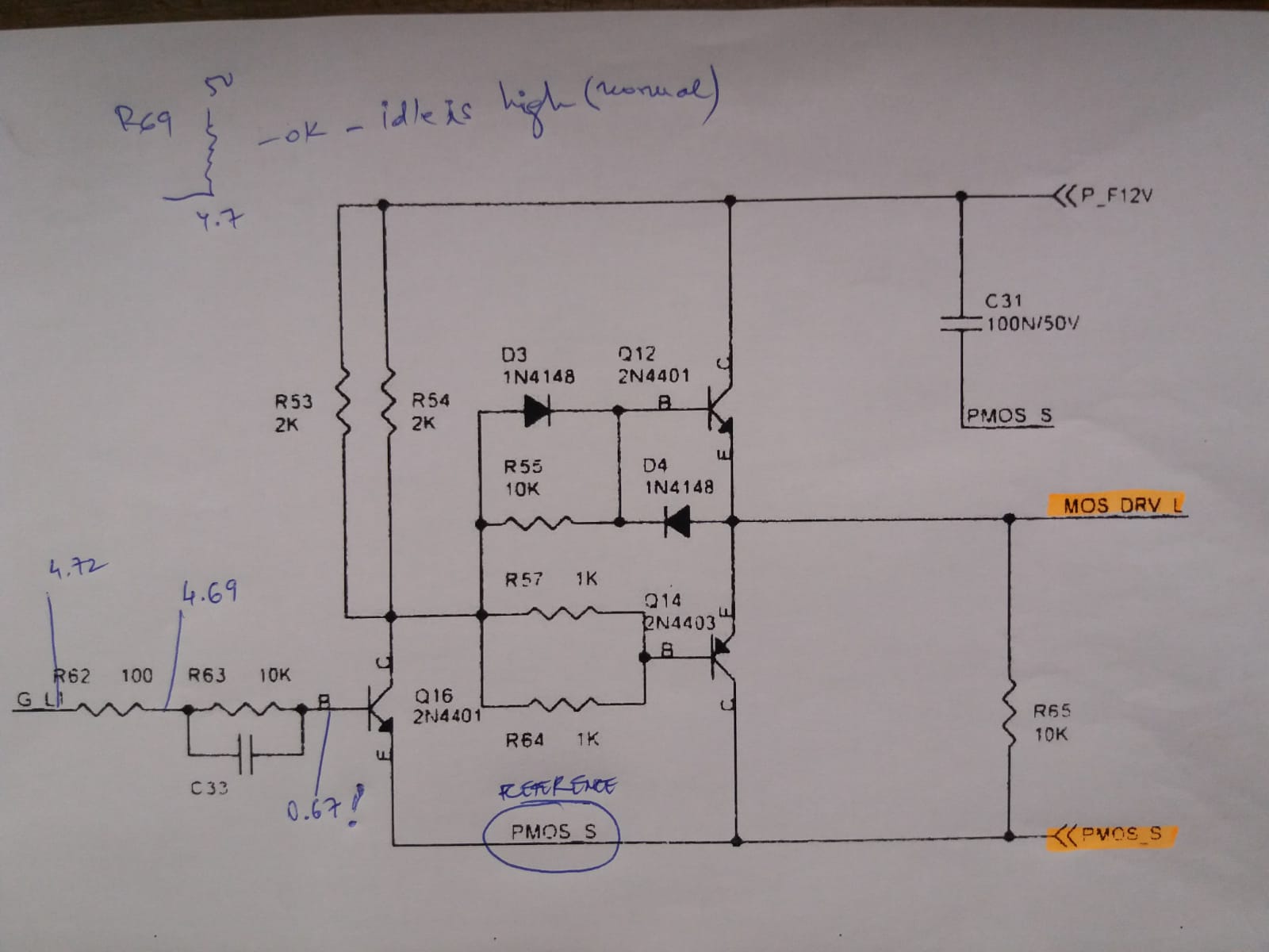

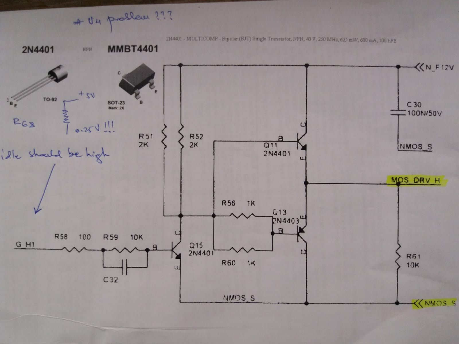

A. Here I think is the problem and for whom it may concerns the normal idle state for Q15 or Q16 input transistors is HIGH and not low - nobody helped me in this matter !!! - automatically when the input is HIGH the transistor will ground the DC signal between E-C, therefore for Q11,Q13 or Q12,Q14 couples the output will be low and no more DC on outputs gates or speaker rail !!!!
I traced the DC signal all-around and found that on L block base of Q15 is high and that was correct (pin no.6 of U5 is HIGH). It is HIGH from pin no6 till base of Q15 - everything ok in L block.
I traced the DC signal in H block and found that on U4, pin no.6 , signal is LOW !!!
R68 is ok , therefore U4 might be fault.
Also , as a test, I made HIGH the base of Q15, R59,R58 and all H block ceased to have a HIGH output.
I don't know exactly how , but U4 seems defective altough it is not a power part, I think is a low power circuit , anyway here is the problem.
I will use a scope after I will correct the DC problem first or maybe I will need no more further.

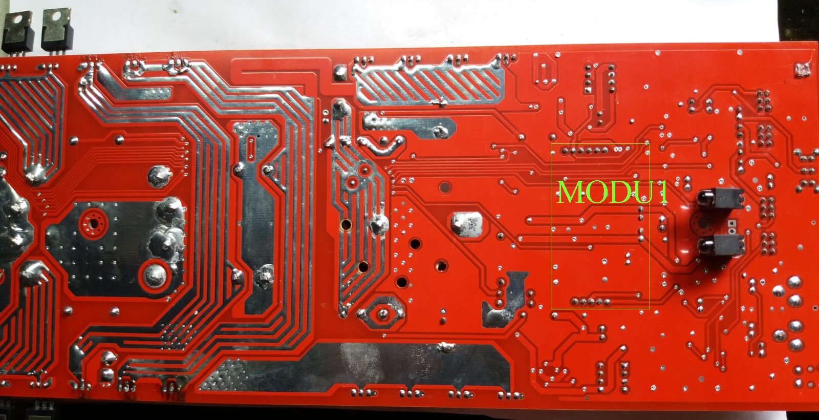

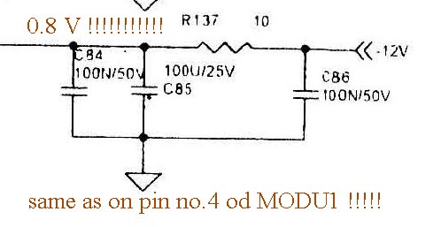

B. Does anybody know the pinouts for MODU1 ? ALSO HERE I detect a problem , see attached pinouts voltages , is missing -12 V , there is +12 V (10.11 V - I used a 10.9 V power supply) ...
Maybe -12V is on shielded upper part of MODU1 ?.. There is any diagram / schematic for MODU1 ?...
Many thanks

_6n137 reaction seems to be good, due 1.35V on its input can be considered HIGH comparative to block L, where on idle state it is 0V on input.
_if pin no. 2 grounded , output becomes HIGH (normal on idle state)

Pls check my findings... on block L seems to be everything ok, don't forget everything has begun due +70 V DC on speaker rail (due 15V on H outputs gates). I traced all signals from end to beginning ... till optocuplers ... and now I'm focused on MODU1 due on block H , on optocupler pin no.2 , is 1.35V DC permanent - on idle state. If grounded pin. no2 , the octocupler reacts fine, it's output became HIGH as should be on idle mode.
It is possible that -12V not to be supplied on MODU1, not found on measuring - see photo attached before (yesterday) with my handwriting. I will work to find correspondence between PCB and diagram regarding MODU1 pinouts ...
... also ... MOSH2, MOSL2 - beeing MODU1 outputs , but connected where - no connection on diagrams?
fixed the problem, now it is -12V on MODU1 but now I have on both blocks 5 V sharp on gates ... I'm nut shure it is normal ...
